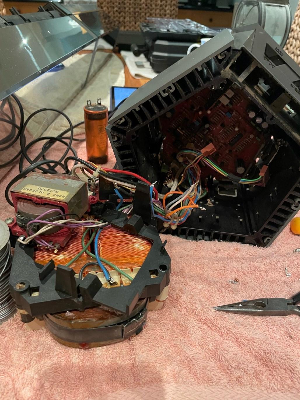

    There’s a gear in the centre section of the mechanism that crumbles with age and fails – this is usually what causes this.
    Search “Beosound Century gear” on eBay for a selection of newly-made reproductions that will fix the issue.

    As above, dismantle the switch and clean both the PCB contact and the underside of the tactile dome as they can give problems.
    I had a Beogram 5000 come my way a few years back where so much dust and muck had got under the switch dome, when you pressed Play, the deck would start but then immediately stop again, then re-start itself and keep doing this over and over again until I pulled the plug!

    Yes, sadly your tweeters have had it – bad luck!
    A low resistance reading suggests that the coil has probably overheated and individual turns of the coil wires have melted together (which would also cause the rattling you’re hearing), so they won’t be salvageable, sadly.

    My experience with those supposedly “correct” replacement tweeter diaphragms has been very poor. They are usually poor quality and the last ones I bought had the wrong diameter voice coil and had the lead-out wires in completely the wrong place for the dome they were supposed to be replacing.
    To cap it all, when I returned them for a refund, they allegedly “got lost” in the post.
    I would buy a complete correct replacement tweeter. The S75s are very good so definitely worth it.

    I’ve been inside my Beovox MS150.2s in the last day or two.
    A few years back, one of the midrange domes started distorting and, on taking it apart, it turned out that the voice coil had become partially detached from the former and was rattling around in the gap. Odd, but a replacement driver from Beoparts fixed it.
    Then, about six months ago, I realised the other speaker was making similar noises. I took it apart on Monday and, yes, you’ve guessed it:
    MS150.2 Mid AGAIN
    Well, another replacement unit is on its way to me, but I was initially taking this personally and wondering what the universe has against my MS150.2s in particular! However, lying in bed last night I had a sudden realisation. When I took the speakers apart to replace the first failed midrange, I noticed that in the past, someone had obviously re-capped the speakers and done a pretty shoddy job of it. Consequently, when I was ordering a Beoparts capacitor kit for some other B&O speakers, I ordered a kit for these and fitted it last year.
    During this process, I found that whoever had done the crap job had fitted a 33uF capacitor where there should have been a 3.3uF in the same place in both crossovers. Checking the circuit today, it turns out that this capacitor is in the high pass section of that very unit, so it would have dropped the crossover frequency drastically, and sent bass frequencies to the dome. No wonder the flippin’ coils keep cooking themselves and falling off!
    Hopefully, it’s not a fix I’ll have to repeat again.
