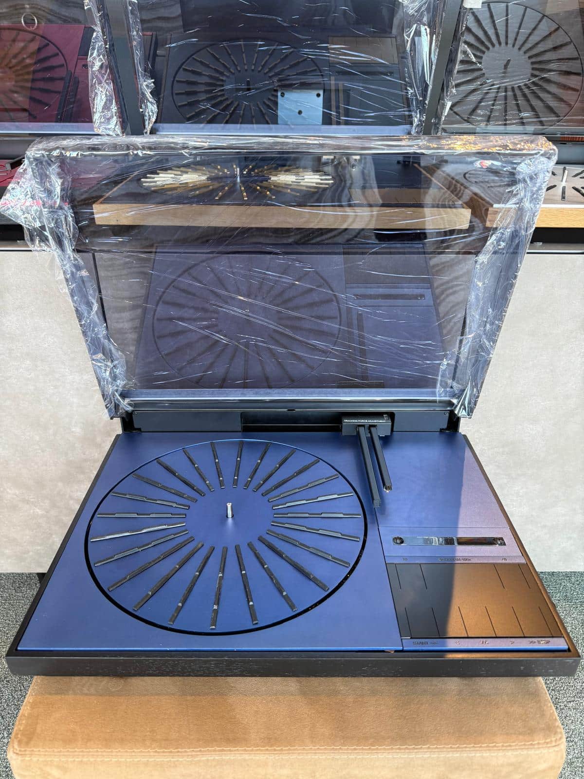

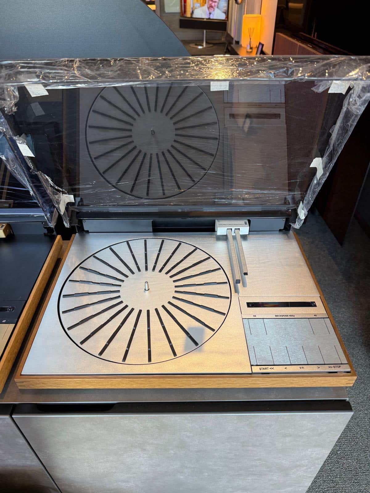

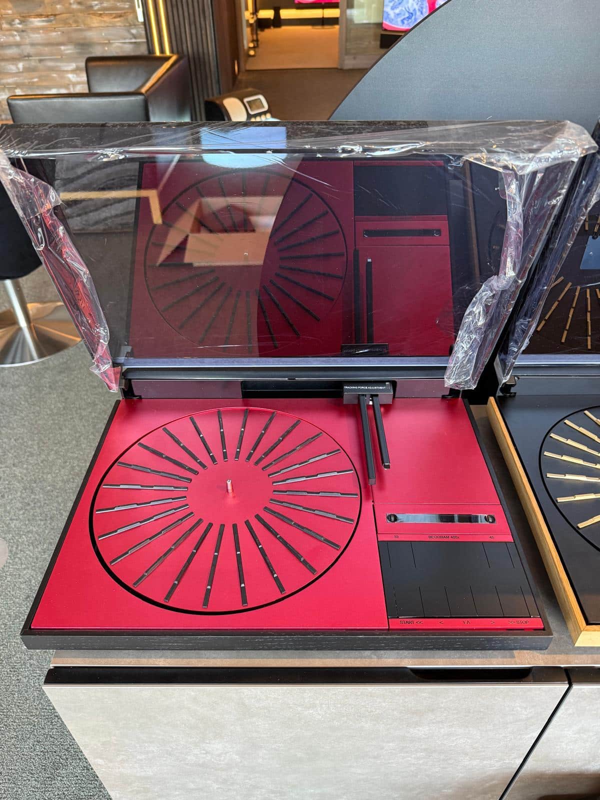

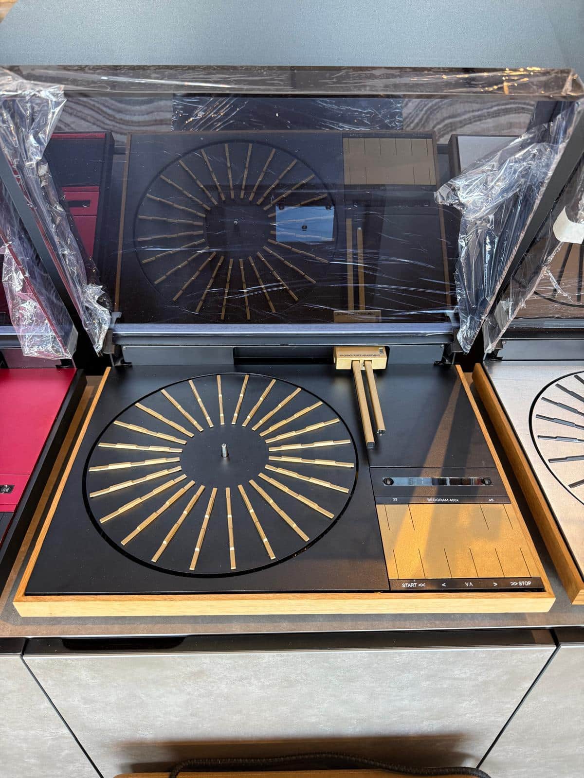

    multicare
    GOLD Member
    We don’t usually post about what we’re working on – mainly because there’s always so much coming through our repair centre that we barely get a minute!
    But we thought we’d take a moment to share a few BeoGram 4002/4004 turntables we’ve recently refurbished using the official Bang & Olufsen kits.
    This time around, we’ve gone a little further and introduced some coloured aluminium finishes – all properly anodised and refinished.
    A bit of a change from the original silver – what do you think?
    Do you have a favourite, or would you stick with the classic look?
    Photos attached 👇

    #65653
    Glitch
    Perhaps I misunderstood your original post…
    Are the turntables in the pictures planned products or samples for a service to provide bespoke turntables?
    Either way, I’m curious about how you created the gold “rays” on the third turntable. Is is possible to provide a close-up picture?
    Glitch
    #65657
    multicare
    GOLD Member
    They are currently our samples for demonstration.
    We have been asked to produce them in bespoke colours by a few customers – black and gold seemed to be a popular request.
    The black, blue and red aluminium surfaces were sent off for stripping, refinishing and anodising in the colour.
    We have been getting replacement keypads laser cut locally, we took some of them and painted them along with the arms etc.
    The gold ribs “rays” are solid gold bars 🤣 – only joking
    The ribs were 3d printed in a gold colour, then sprayed to match the keypad and arms in a gold paint.
    #65667
    TK
    Very interesting.  The color versions would not be to my particular taste, but IMHO it illustrates the possibilities quite well.  Does the anodization process require you to remove the rubber parts, and/or the glued-on studs? I know that vinyl does not survive the acid cleaning  process intact, but I did wonder about rubber? You do your own stencil work for the arm cover? Overall, IMHO a nice service option to offer, even if it’s only to refinish to original colors.
    #65728
    multicare
    GOLD Member
    That’s correct, we remove all the rubber/plastic parts before the anodising process. The studs dont need to be removed, they survive the process.
    All the lettering is added after the process so we can have a consistent finish across all the aluminium.
    We are processing more in the original colour vs the colour options.
    #65792
    Glitch
    I just stumbled across the Beosystem 4000 Masur Birch.    https://www.bang-olufsen.com/en/us/story/atelier-editions-beosystem-4000c-masur-birch
    I have to say that I like all of the Multicare sample colors above better than the chartreuse. Once again, I don’t seem to be the target audience for the latest offerings. 😉   (However, I really like the cabinet)
    I have one question about the platter that relates to both the Masur Birch and a couple of the Multicare variants. How does the record detect work when there isn’t contrast between the platter “rays” and the platter?
    Glitch
    #65793
    multicare
    GOLD Member
    Thank you.
    We developed an additional PCB that allows us to do some stuff 🤣
    basically the system still works as it should.
