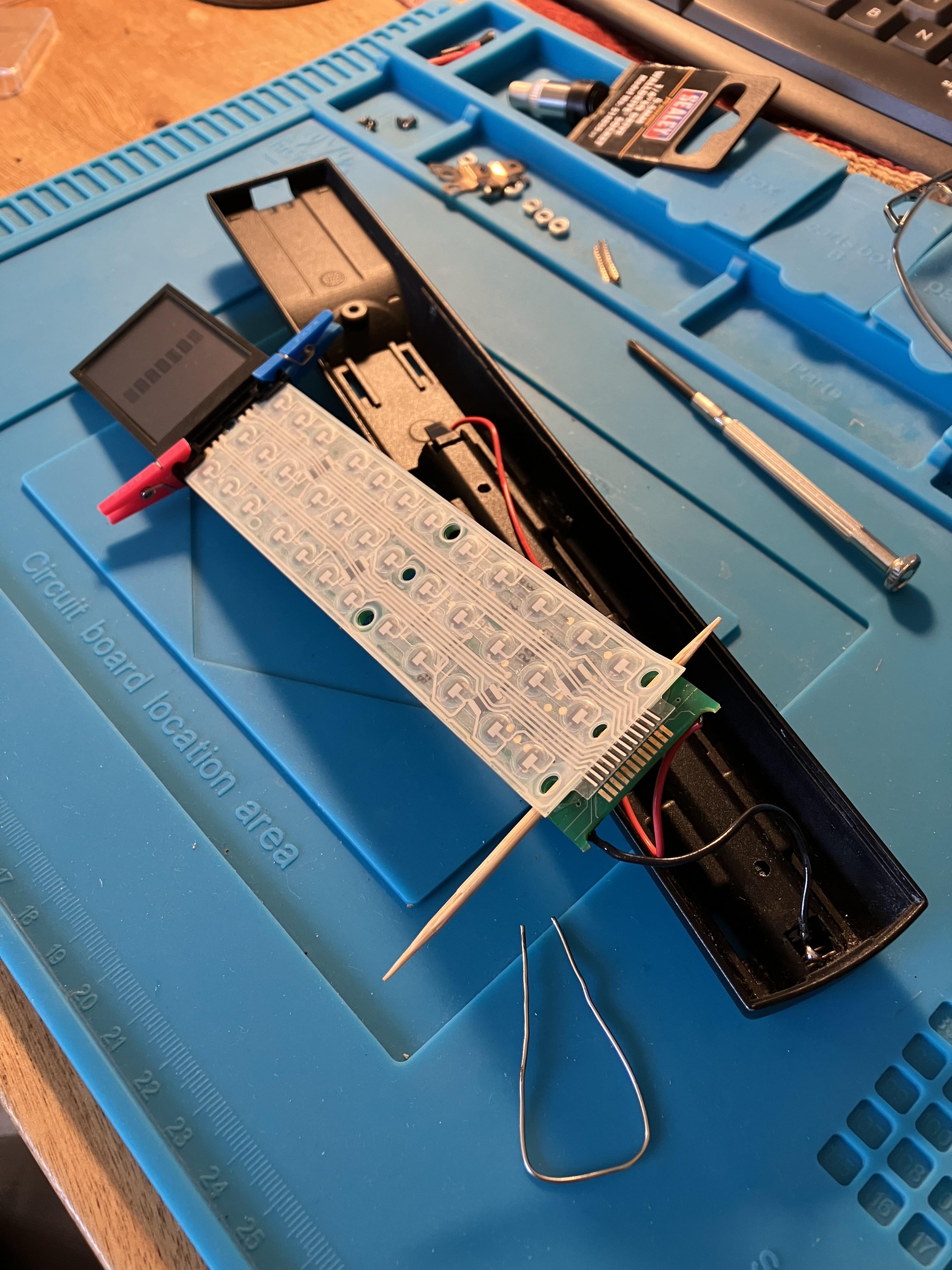

    I revisited the faulty Beo4 today.  I tried to get away with just cleaning the contact points where the foil is clipped to the PCB, but I couldn’t get it to work reliably so I ended up fitting a contact foil that had been removed from another remote.

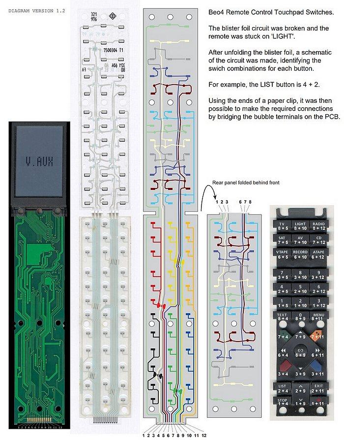

    Whilst testing I used the following useful picture/diagram to test the remote and prove that it was the contact foil at fault.  I got the diagram from one of Peter Pan’s excellent threads on the hifi4all forum here:  https://www.hifi4all.dk/forum/forum_posts.asp?TID=78664&PN=1&TPN=9
    (there are a few of my Beoworld photos in Peter’s thread so I guess that’s a fair swap of copyright, but the diagram may have originated elsewhere because Peter usually annotated his work in Danish)
    Beo4 foil Diagram - from Peter Pan's thread
    As before, I’ll be leaving the Beo4 powered up overnight to see if it still works in the morning!

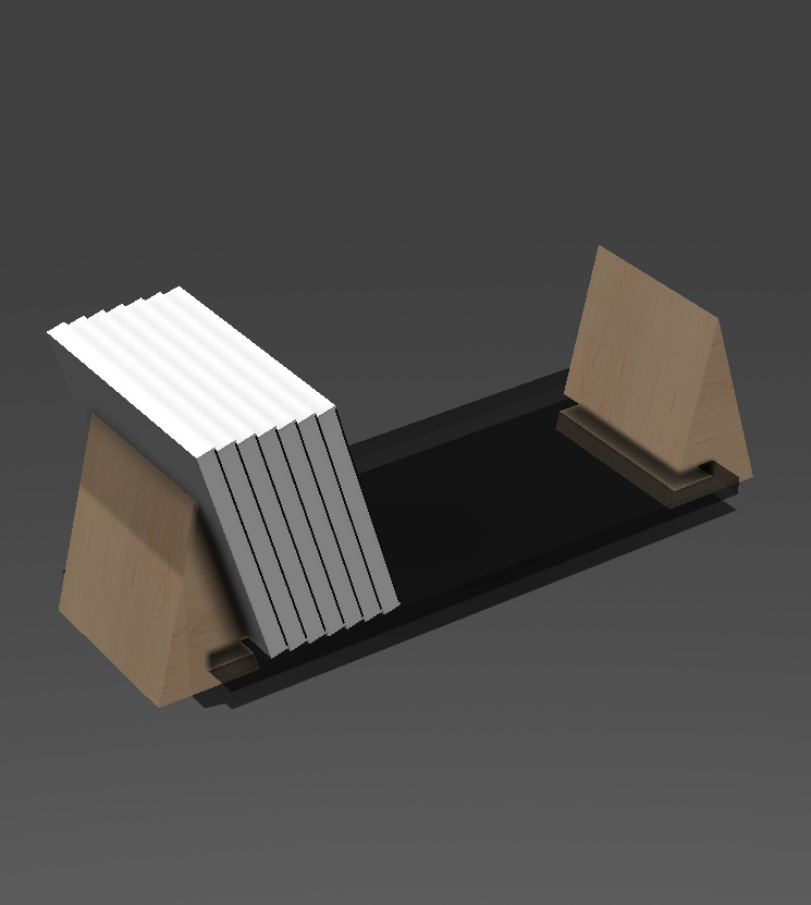

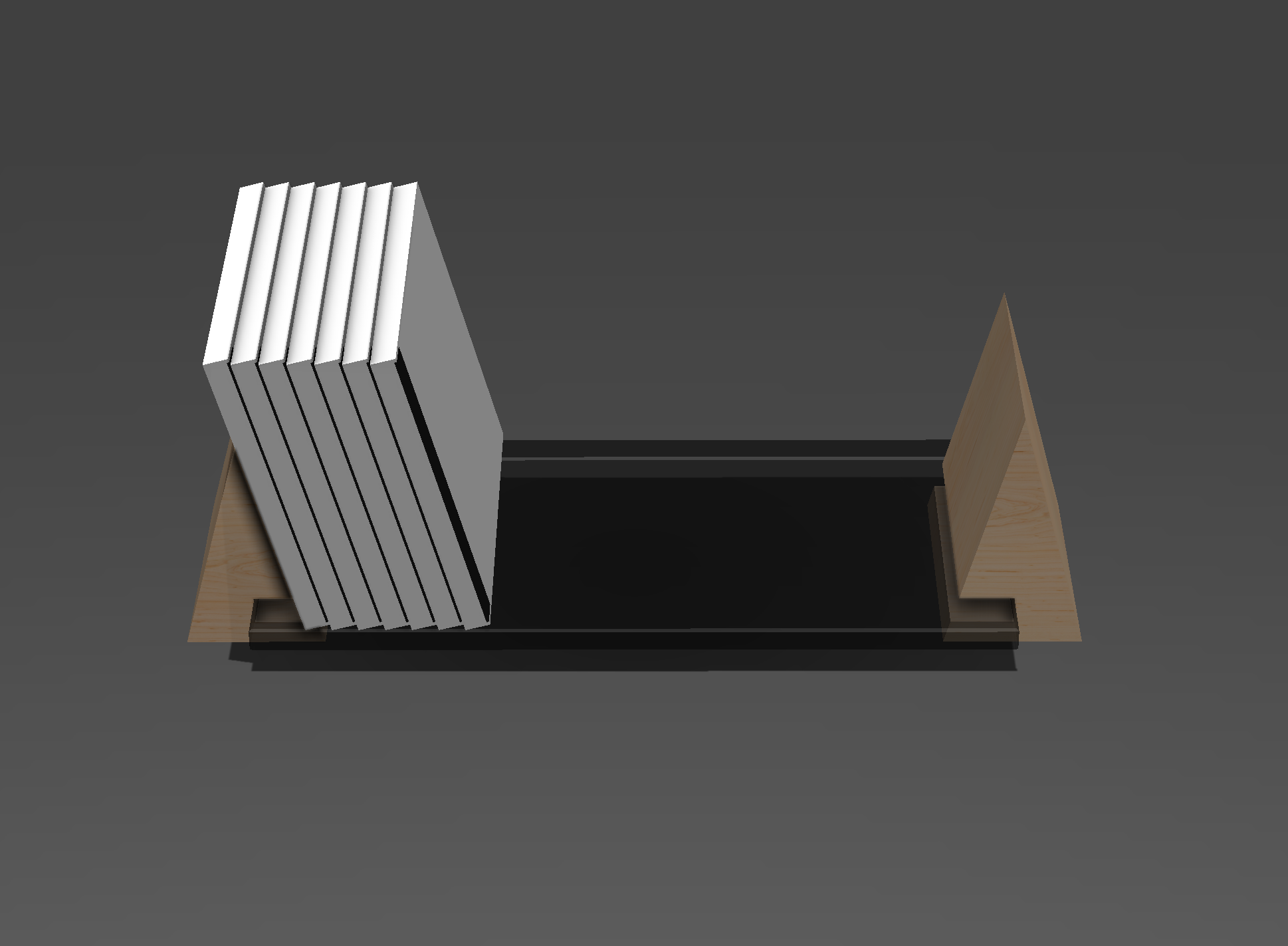

    As always, I am starting random DIY projects and this one *should* actually make it to the finish line in a few weeks. I have modeled up a clone of the A5/A6 CD rack! I am currently getting quotes made for the glass in both sizes like the originals. The end pieces will be 3D printed.
    I am a huge CD listener and have a few hundred CDs that will be put on display in my new music room here at home. I plan on building at least four or five of these eventually. I like the idea of having a few groups of CDs to organize by genre instead of organizing alphabetically like I usually do.

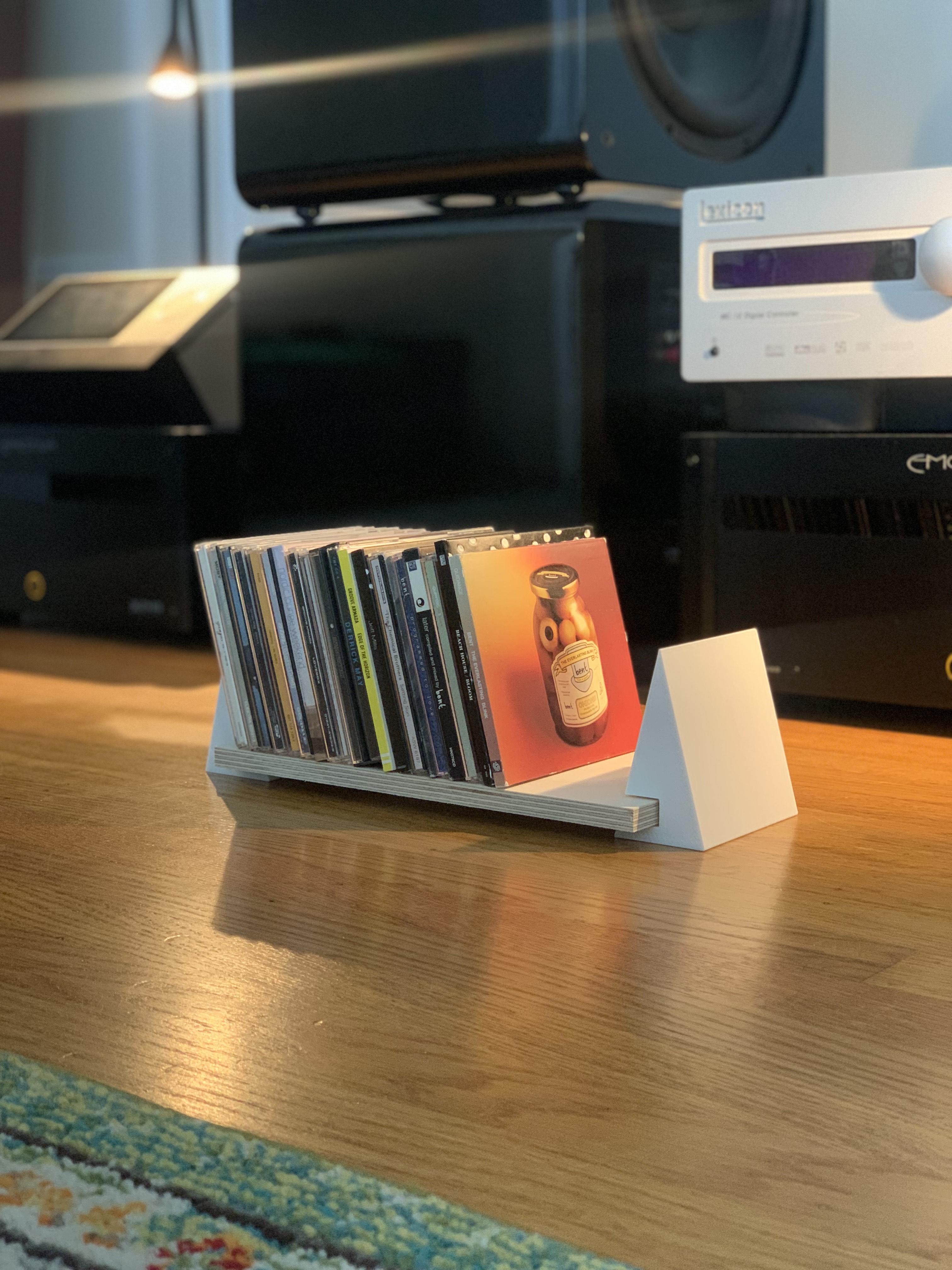

    I received some quotes for glass shelving and boy was it pricey. Seems like B&O negotiated a good price with its suppliers back in the day… the tinting and beveled corners seemed to drive up the cost a lot. Largely though there was a ton of polishing involved to get the edges smooth.
    At any rate, I decided to just move on with some scrap ply from the woodshop. this is ~12.5mm ply with some white PLA printed ends. I made 4 shelf plinths last night, two in each length. Going to make a few different colors to see what works best with the birch ply visually.

    Looks nice so far.
    Have you considered making the glass/plywood piece out of granite? A countertop shop might be able to do this at a reasonable price using off-cuts. Just a thought…

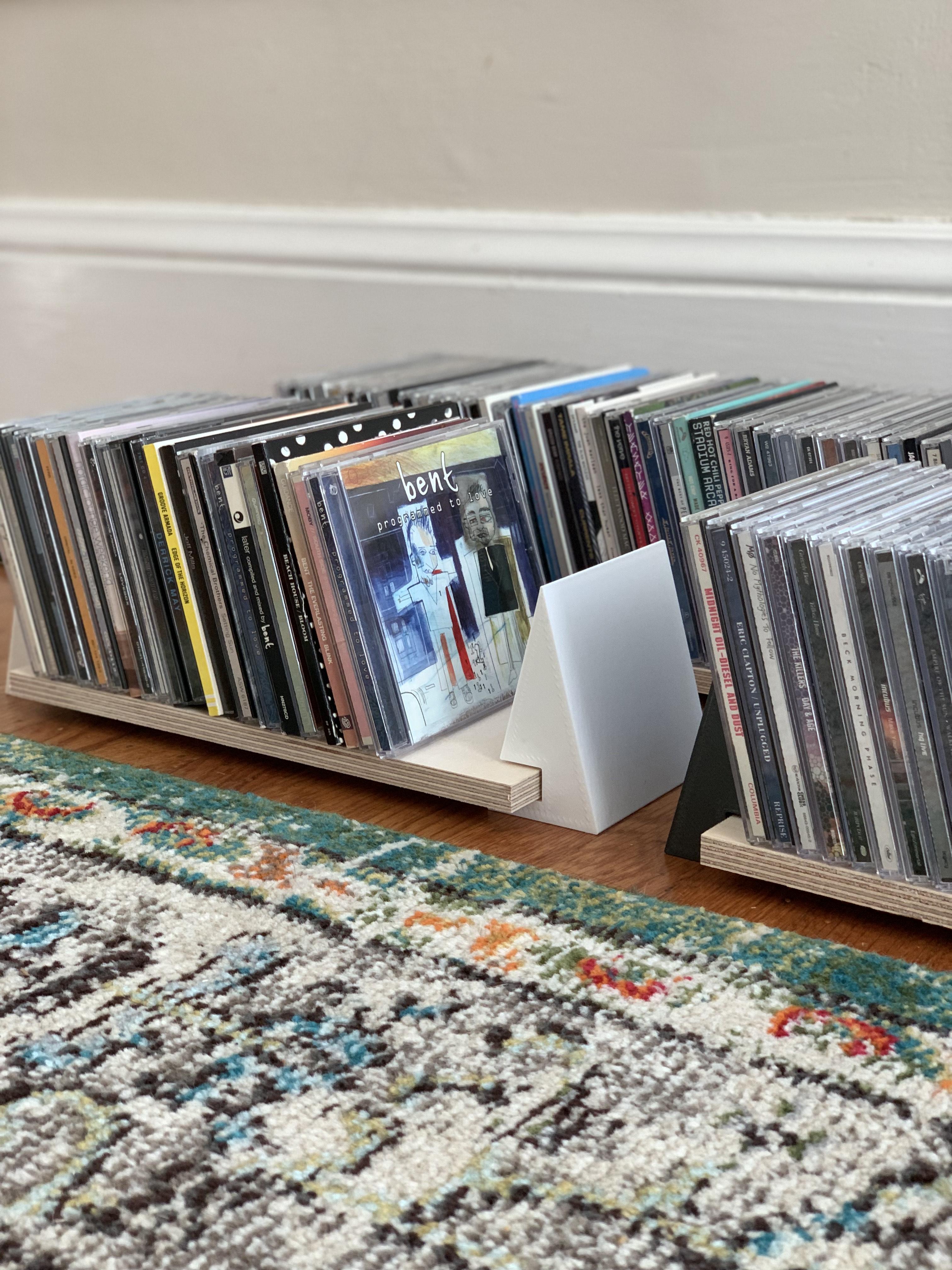

    The plywood was for sure not the original direction but it makes for a nice, warm and light-hearted version of the design.
    IMG_6435
    If anyone would like to make their own, feel free to download here: evanbunner.com/downloads or reach out to me if you are interested in getting them printed.
