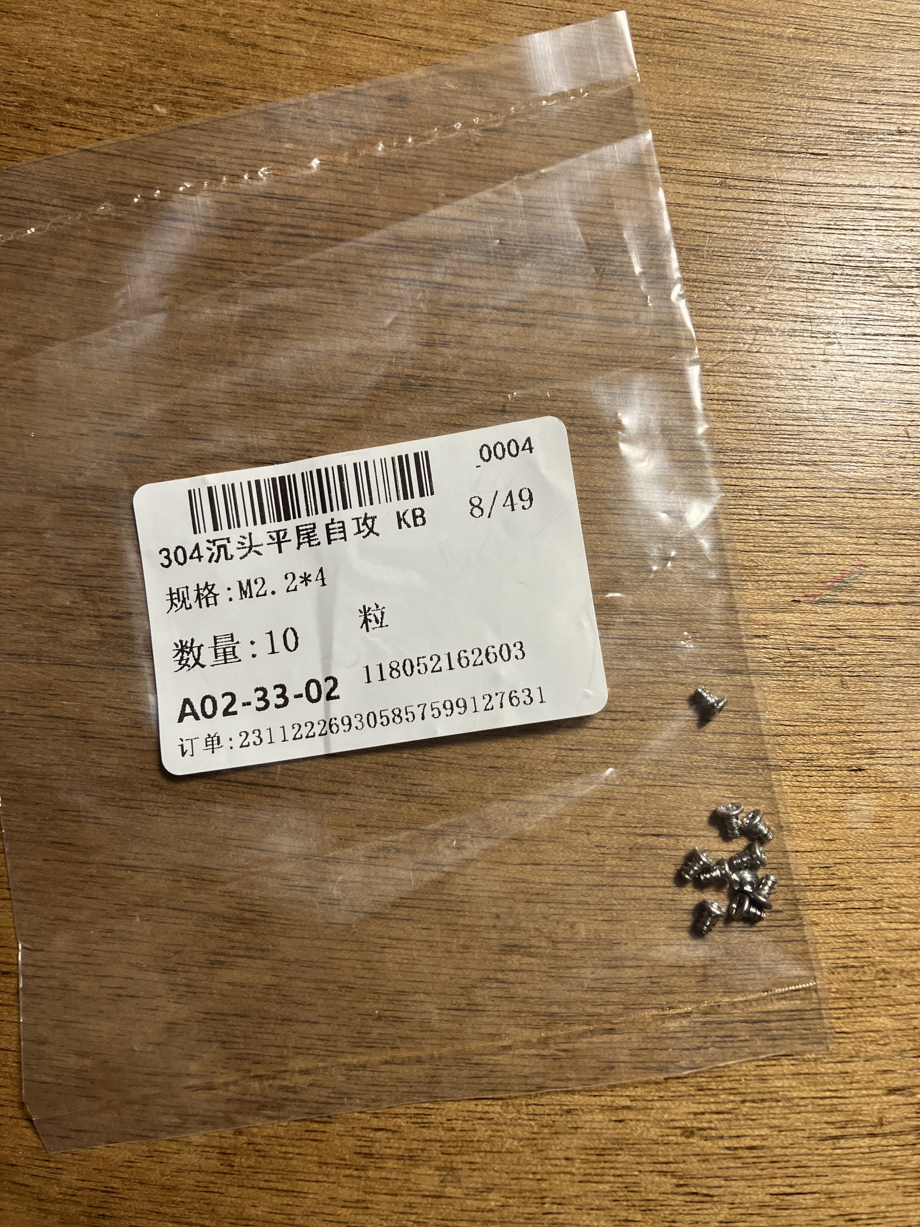

    An easy fix today – replacing a couple of missing screws in Beo4s; the four tiny ones that hold the overall remote together.  I found the size in the service manual (M2.2×4) and ordered on eBay.  I couldn’t find a UK supplier (size M2.2 seems rare) but these came from China and fit well.
    https://www.ebay.co.uk/itm/186149792663 (Choose ‘M2.2x4mm’ from the drop down menu)

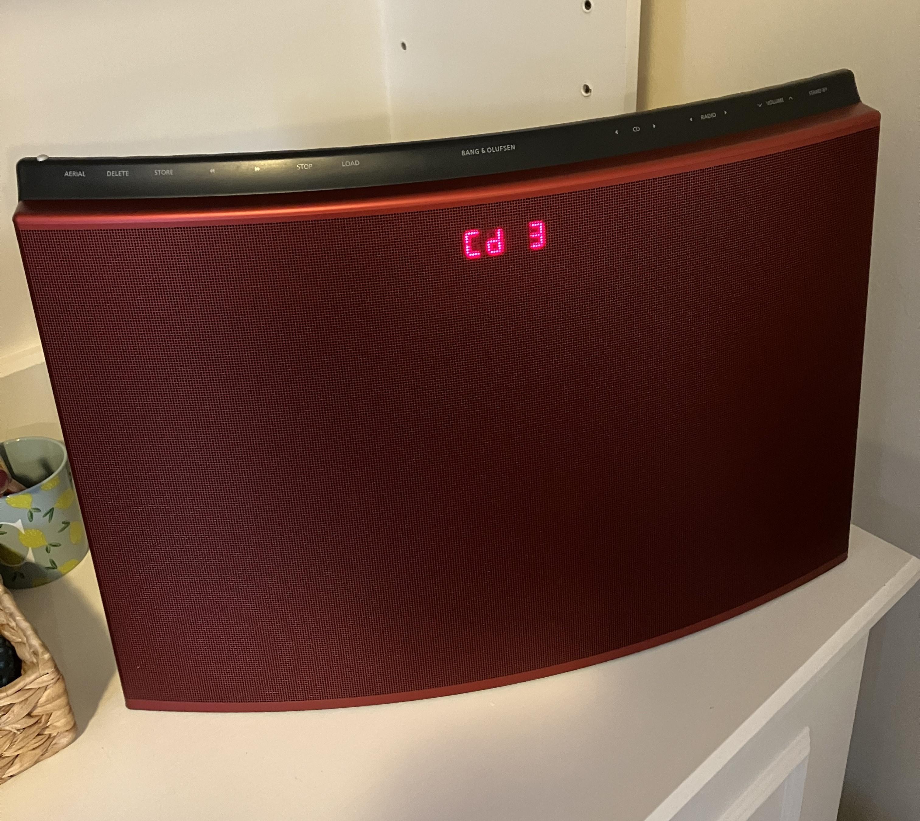

    I ‘won’ a spares-or-repair BeoSound 1 (my second!) yesterday on eBay, and collected it to avoid the risk of damage in the post. The listing stated that the CD player wasn’t working, so I was quite looking forward to stripping it down and attempting a repair.
    Anyway I plugged it in and tested – sure enough any CD would start to spin and then stop/eject. I gave the lens a little clean and tried again but there was no difference. Out of interest I then went to Service Mode and it showed CD module errors: OF6 and OF10. I then tried a couple of the CD tests – just the first two from the list below (focus and then turntable on/off):
    I then took it out of Service Mode and tried the CD again and it worked flawlessly!  I can only assume that the focus was stuck and the Service Mode tests got it moving again.  I have tried several CDs including a couple that won’t play in my other BS1, and all is well.  Strangely I can’t help being disappointed that it wasn’t more of a challenge to fix!
    The only other fault was that the aerial protruded about 5mm when in the down position.  I realised that it just needed a few clockwise turns to screw it down fully into the mechanism.
    Here it is in position in the lounge after further cleaning:

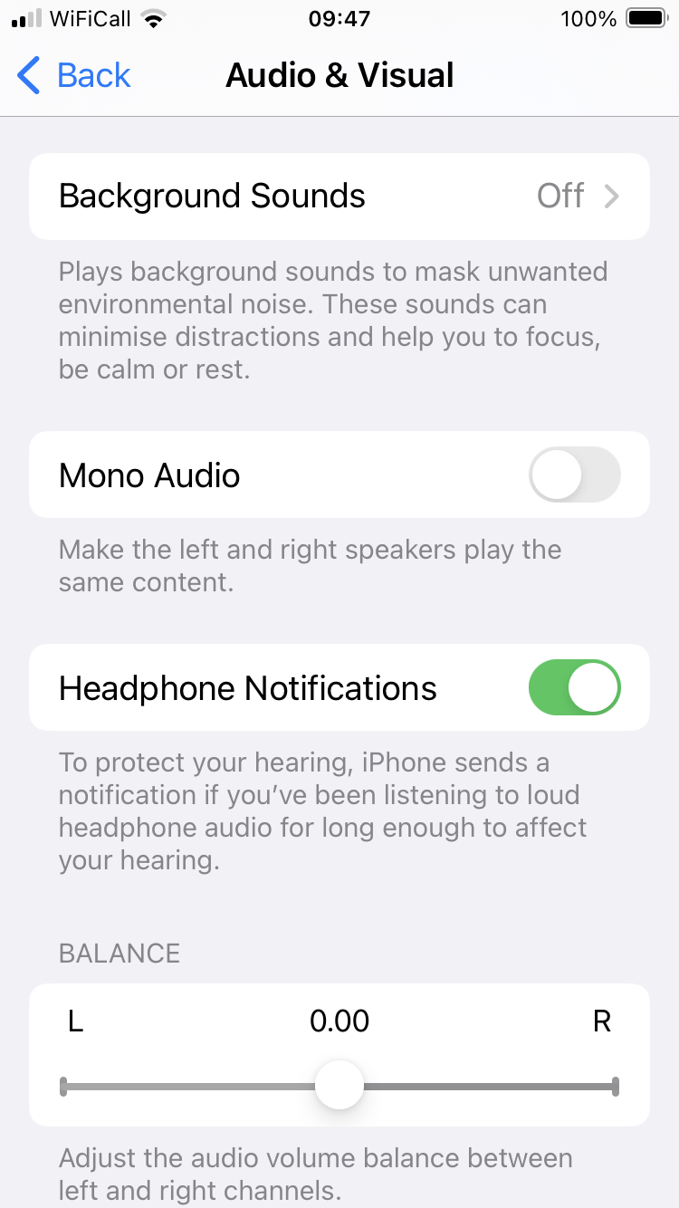

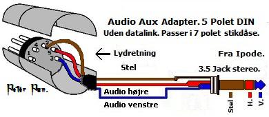

    This is not something that I am currently working on, but I have made an interesting (to me!) observation during my recent tests using iPhone inputs to Beolink Converter 1611/BL3500.
    Like many legacy B&O enthusiasts, I have amassed a number of 3.5mm to 5 pin (or 7 pin) DIN connectors, useful for connecting such devices as iPhones or Airport Express to B&O DIN aux sockets.  Typical connector shown below:
    In testing, I noticed that two of my four connection leads have the L&R channels reversed!
    In the 3.5mm ‘headphone’ plug, the tip is ‘left’, the ring is ‘right’ and the sleeve is ‘ground’.  For a B&O DIN input, left is pin 3, right is pin 5 and ground is pin 2 – with the pins numbered as shown below (solder side of 7-pin plug shown):
    Pins 3 and 5 are incorrectly reversed in two of my leads, including the one in the photo above.
    EDIT:  For clarity, here’s one of the late Peter Pan’s excellent diagrams, where ‘venstre’ is  ‘left’ and ‘højre’ is ‘right’:
    Obviously you can check with a multimeter, or just connect up a phone and adjust the balance.  On the iPhone the balance control is strangely hidden under Settings > Accessibility > Audio & Visual, as shown below:

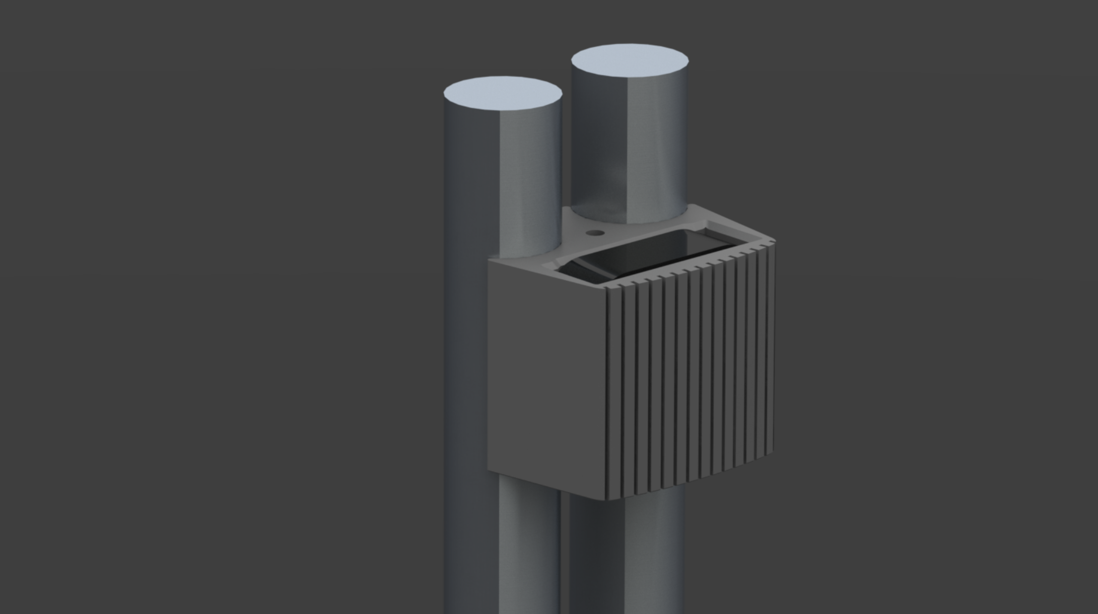

    Working on the first iteration of a printable BeoLab 4000 upright / angled table stand. This is an eye-balled clone right now and will have the opportunity to fit-test tomorrow!
