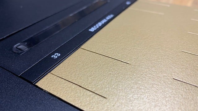

We don’t usually post about what we’re working on – mainly because there’s always so much coming through our repair centre that we barely get a minute!
But we thought we’d take a moment to share a few BeoGram 4002/4004 turntables we’ve recently refurbished using the official Bang & Olufsen kits.
This time around, we’ve gone a little further and introduced some coloured aluminium finishes – all properly anodised and refinished.
A bit of a change from the original silver – what do you think?
Do you have a favourite, or would you stick with the classic look?Photos attached 👇

Are the turntables in the pictures planned products or samples for a service to provide bespoke turntables?

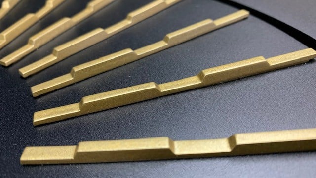

Either way, I’m curious about how you created the gold “rays” on the third turntable. Is is possible to provide a close-up picture?
Glitch
16 May 2025 at 15:28 #65657GOLD MemberThey are currently our samples for demonstration.
We have been asked to produce them in bespoke colours by a few customers – black and gold seemed to be a popular request.

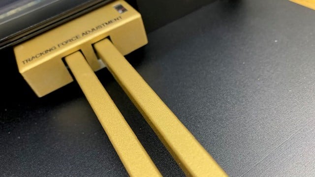

The black, blue and red aluminium surfaces were sent off for stripping, refinishing and anodising in the colour.
We have been getting replacement keypads laser cut locally, we took some of them and painted them along with the arms etc.The gold ribs “rays” are solid gold bars 🤣 – only joking
The ribs were 3d printed in a gold colour, then sprayed to match the keypad and arms in a gold paint.Location: Leeds, West Yorkshire, UKFavourite Product: BeoGram 400xSignature: Multicare Electronics - Authorised Bang & Olufsen repair.My B&O Icons:17 May 2025 at 00:55 #65667TK
