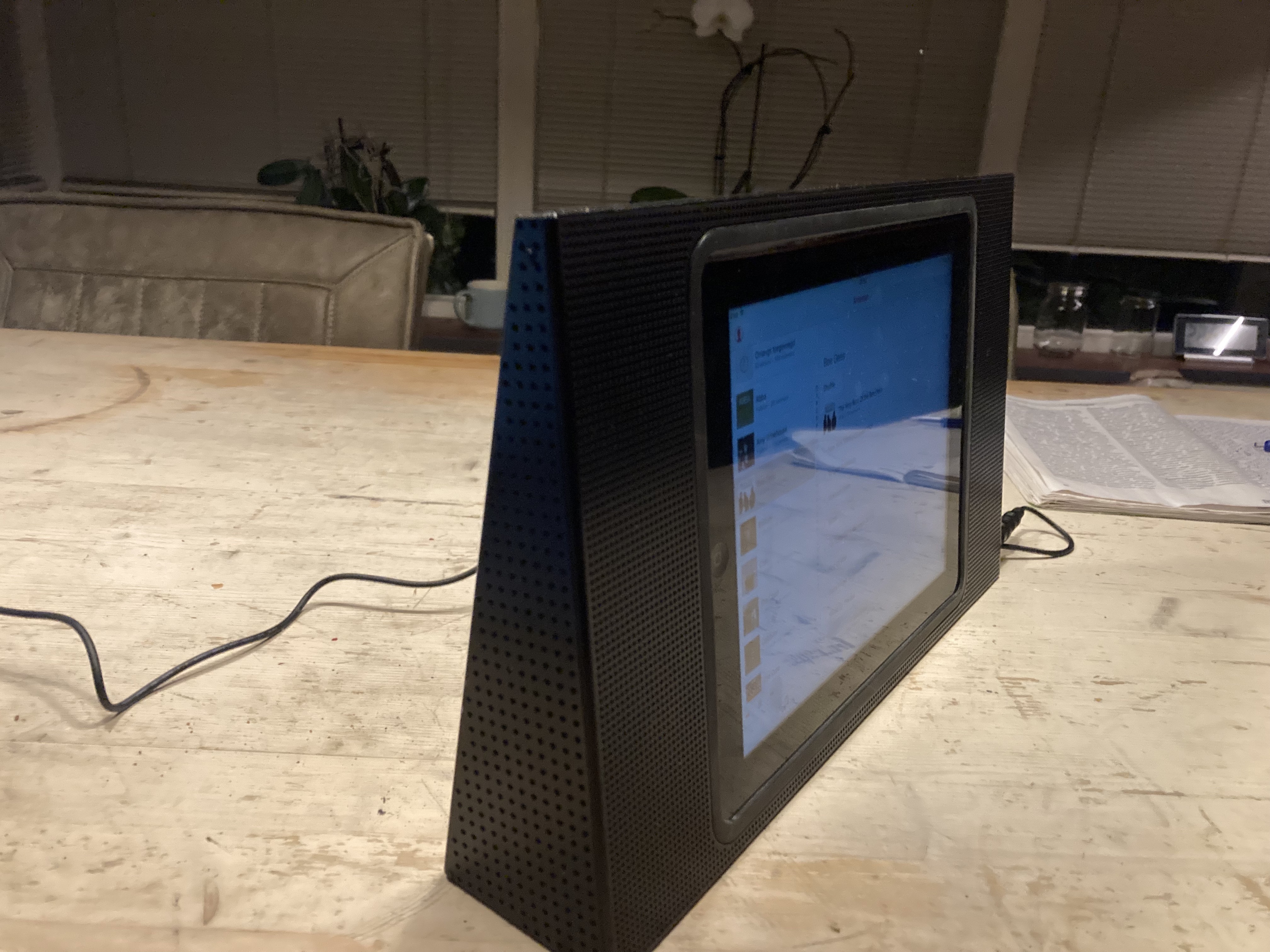

With very little work (but some trial and error) I have now adapted an iPad 6 to the Beoplay A3. On this thread I will provide instructions. With the right materials at hand, this is a 1/2 hr project that requires minimal skills.
This project requires that the iPad be left more or less permanently on the Beoplay A3. It can be removed, sure (I’ve done it a couple of times already), but it’s best to just let it be. My iPad 6 cost me all of $160 last week, so it is an extra to my main iPad: for patio use, or as a B&O multiroom interface, which are my two purposes with this initiative. Of course, it is great for YouTube watching, if that’s your thing.
The iPad 6 offers the same 9.7 inch (24.6 cm) diagonal screen size as iPad, iPad 2, and iPad 3, but much higher resolution. iPad had a 0.79 megapixel screen; iPad 6 has 3.1 megapixels, so the resolution, or image quality is more than four-fold. It is a reasonably speedy machine and still a joy to use, unlike, say, my iPad 4. The 6 now runs iPadOS 16, and Apple has already stated it will run iPadOS 17, to be released next month.
Apple is unlikely to provide iPadOS 18 for iPad 6: this means security patches will stop after September 2025, so this project prolongs the life of BeoPlay A3 at least two full years, but probably not much more.
The good news is that in late 2025 you could remove the iPad 6 and install a now current iPad mini 6th generation, thereby prolonging the life of the Beoplay A3 until the end of the decade, or beyond.
Here’s what the adaptation looks like. Materials and instructions to follow.

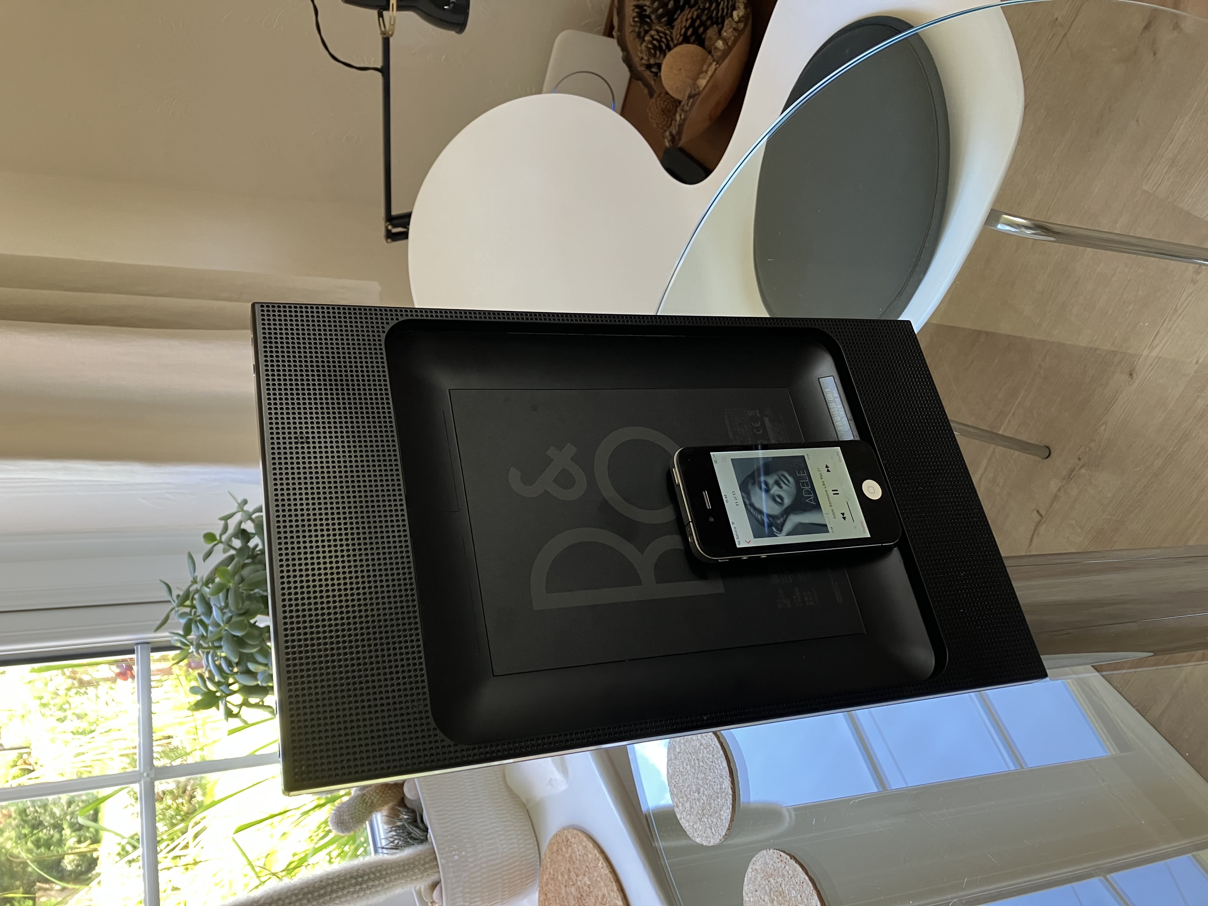

BRONZE MemberBy the way, you can’t use the original Beoplay A3 gasket anymore: the modern iPad is not wide enough to fill it in.
Here is a photo showing an interesting conundrum: if you can tolerate the following, you can side-step the entire velcro/double-sided tape process! In that case, this becomes a 10 minute project: just Dremel and paint.
Look: per pure coincidence, the height of the A1468 adapter is such that, when fully inserted into the dock connector’s cavity (post-Dremel widening), the iPad just happens to exactly catch on the A3′ original gasket-retaining slots! Like in this picture:
The iPad 6 is inserted, the A3 is fully functional as designed, and the iPad 6 is 100% secure: it absolutely will not fall from the A3 even if inverted. It is being held by the A3 factory slots designed to retain the old gasket, except the slots are now retaining the glass/aluminum directly. The iPad also sits perfectly symmetrical and even in the other dimensions.
You could use your A3/iPad like this forever. The “bottom” part of the iPad is held, as per the A3 original design, by the dock connector itself. The “top”, by the slots.
I couldn’t. The lack of depth symmetry would drive me up the wall. I just can’t.
Since I can’t use the slots for holding, my alternative is velcro. Originally I used two full layers: a fuzzy side on the A3, then a hard side velcroed into it, then a hard side adhered to its back, and then a fuzzy side on the iPad. Too much! The iPad, quite secure, stood proud. The exact opposite problem of the photo above.
The solution was the two layers of double sided tape plus the one full velcro layer (hard side adhered to the top tape and fuzzy adhered to the iPad). The iPad sits slightly proud, but almost unnoticeable. I can live with it.

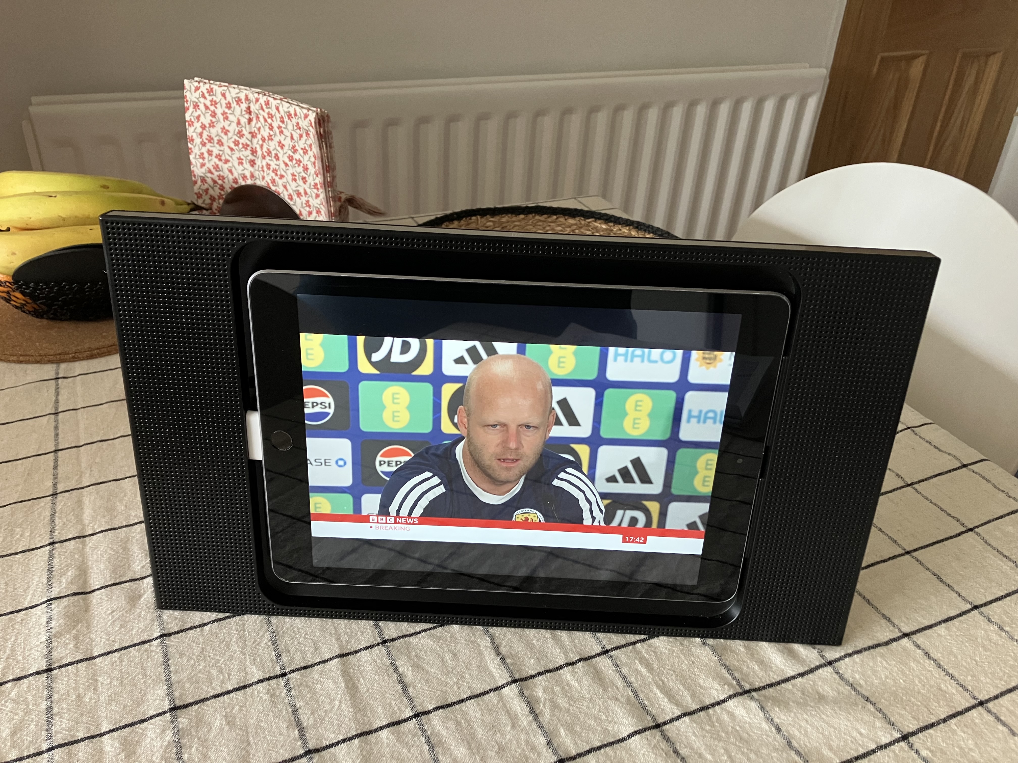

I have ordered an A1468 adaptor and an iPad 6th Gen and hope to replicate @xavieritzmann’s setup above – thanks very much for an excellent series of posts! The adaptor and iPad have not yet arrived, but I remembered that I had some old iPhones in my ‘iphone repair box’ so I dug out an iPhone 4 which has the 30-pin connector. Luckily I also had a 30-pin charging lead, hence soon had the iPhone up and running with some music transferred across.
Here it is up and running:
I’m quite impressed with the sound quality – less impressed with the stability especially in the position shown! Once I have the iPad I’ll mainly be using in the horizontal position.I’ll post again once I have the iPad etc.Location: Warwickshire, UK

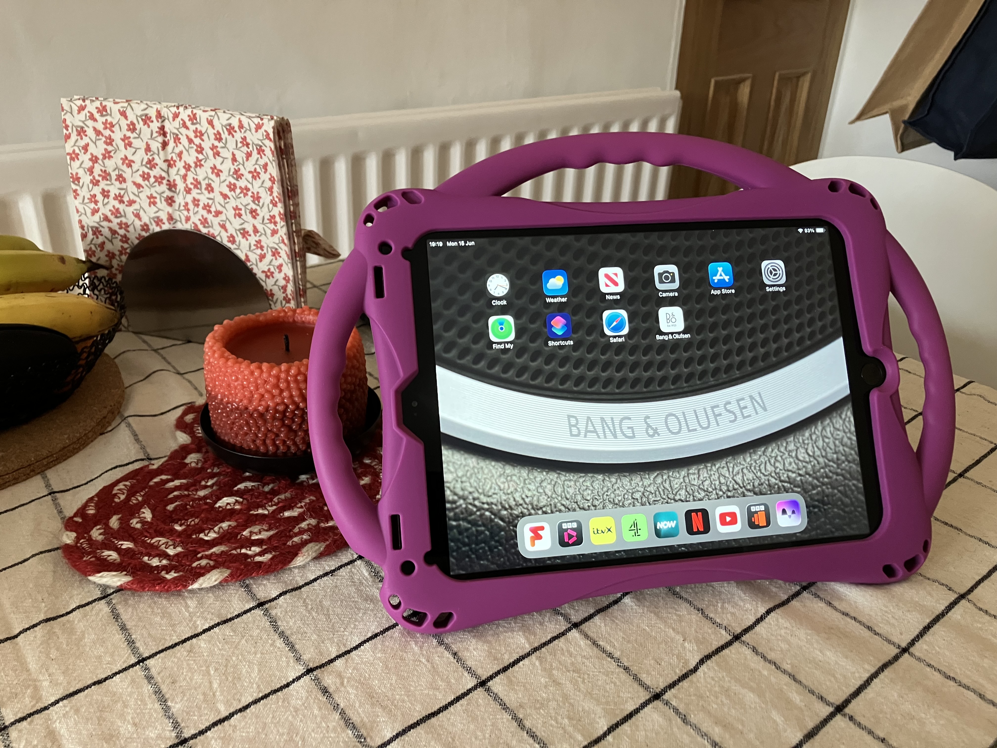

15 June 2026 at 19:49 #124031 GuyModeratorOK so the iPad 6 and adaptor have arrived and I have enlarged the slot so that the A1468 adaptor now fits. I don’t have a dremel hence used a nail file (for the flat bits) and carefully used a larger drill for the rounded ends of the slot – these worked fine.
So here is the A3 with iPad 6 inserted (no velcro and no painting at this stage):
Knowing about the instability of the A3, one of my wife’s first questions was ‘can I remote control it so I don’t have to touch it?’ A quick bit of research tells me that you can use ‘accessibility options’ on an iPhone to control an iPad (on same network, with same Apple ID) but it is very limited – the only useful control was volume. (This may be more useful for music playback than TV, with next track, play, pause etc).However, here’s the problem: The second-hand iPad that I purchsed on eBay arrived on Saturday and also came with a children’s iPad holder in a rather fetching colour; I had intended to throw this away as not needed/wanted. Having received and set up set the iPad up on Saturday, I temporarily fitted it into the children’s iPad holder whilst waiting for the Apple A1468 adaptor to arrive. Here’s a picture:Bearing in mind that I wanted to use the ‘new’ iPad in the A3 as an extra TV in the kitchen that could be moved around (table to worksurface etc) and generally ‘abused’, the pink children’s iPad holder is actually far more suitable! It’s very stable on any surface, can be hung from a hook, is easy to handle, easy to charge (lightning), and easy to operate. (It’s easy to find also because the garish colouring seems to stand out!) The only downside (apart from the looks!) is the sound quality.I’m not sure now how to move forward. I might get an iPad 1 and stick VLC on it as Matador suggested- it will be far more acceptable to the discerning viewer/audiophile. I could use it in the garage …Location: Warwickshire, UK

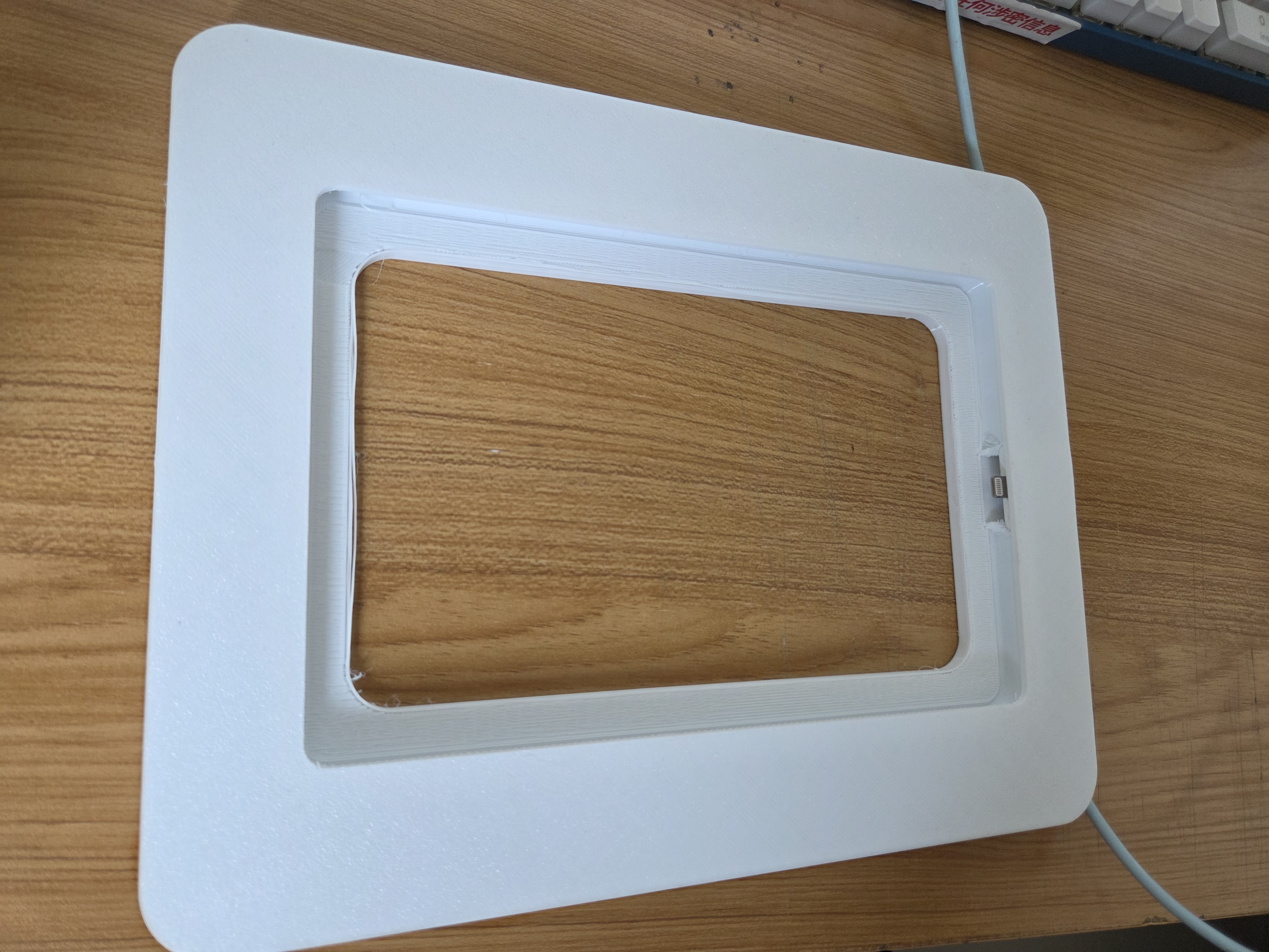

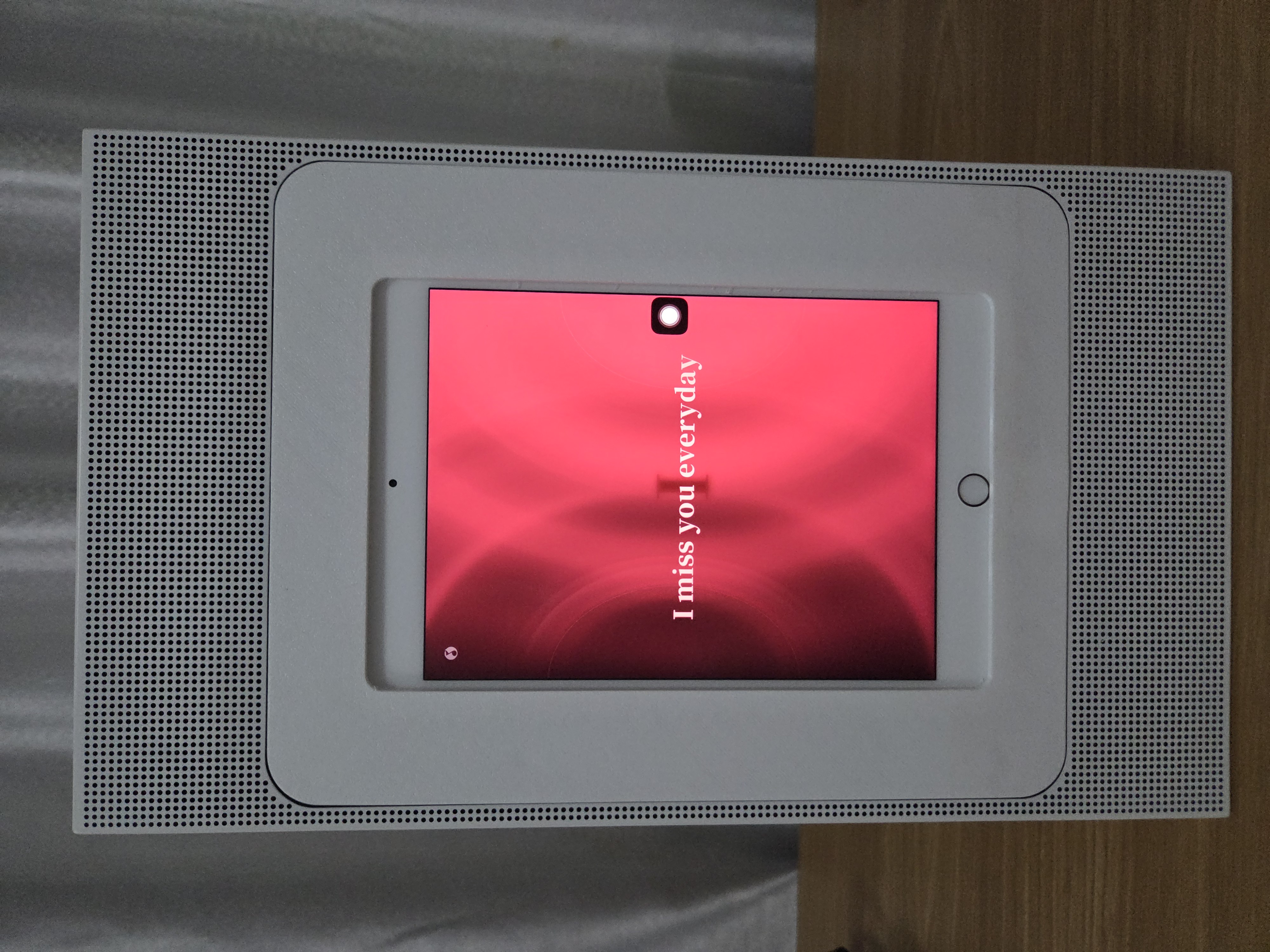

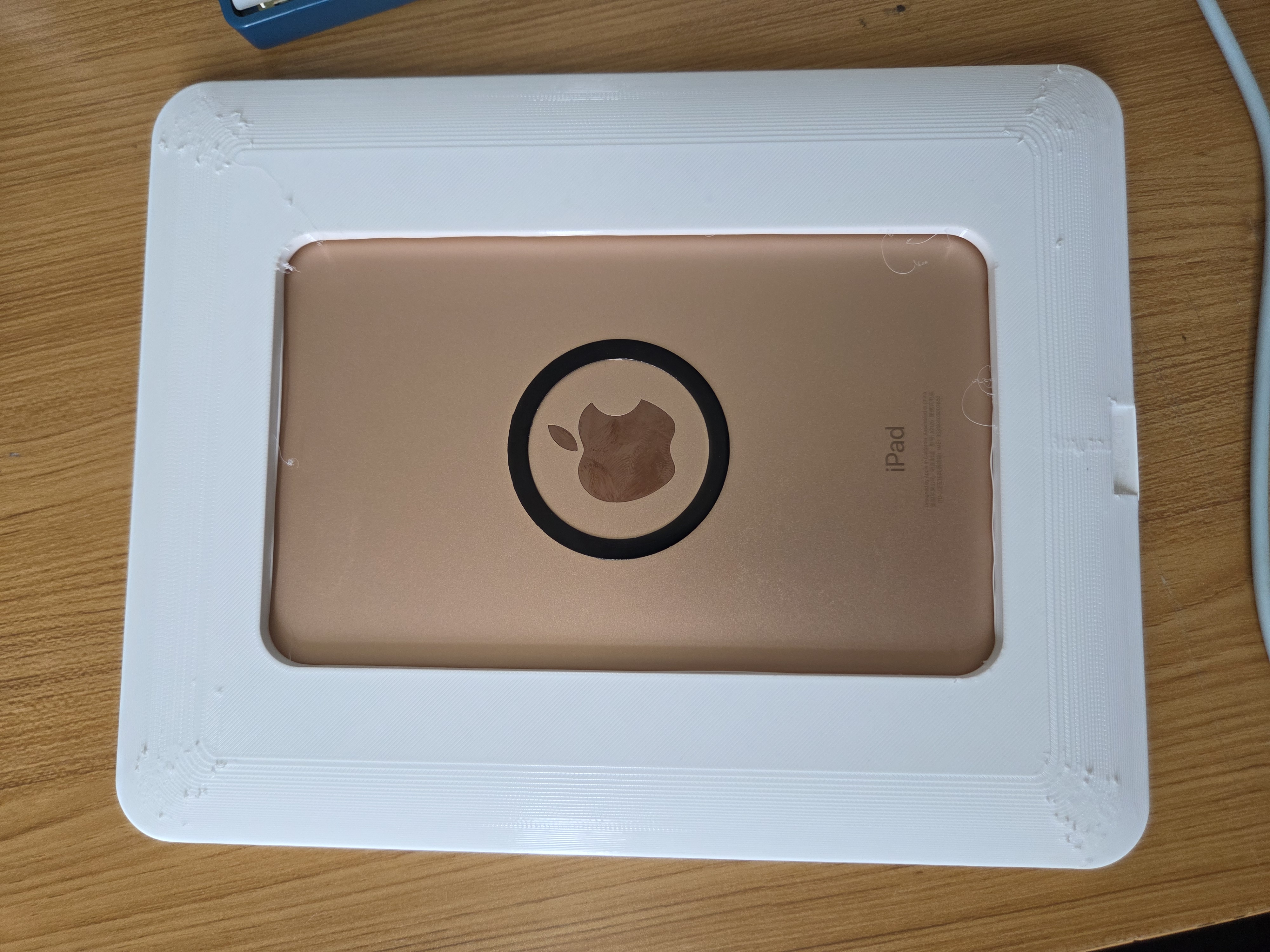

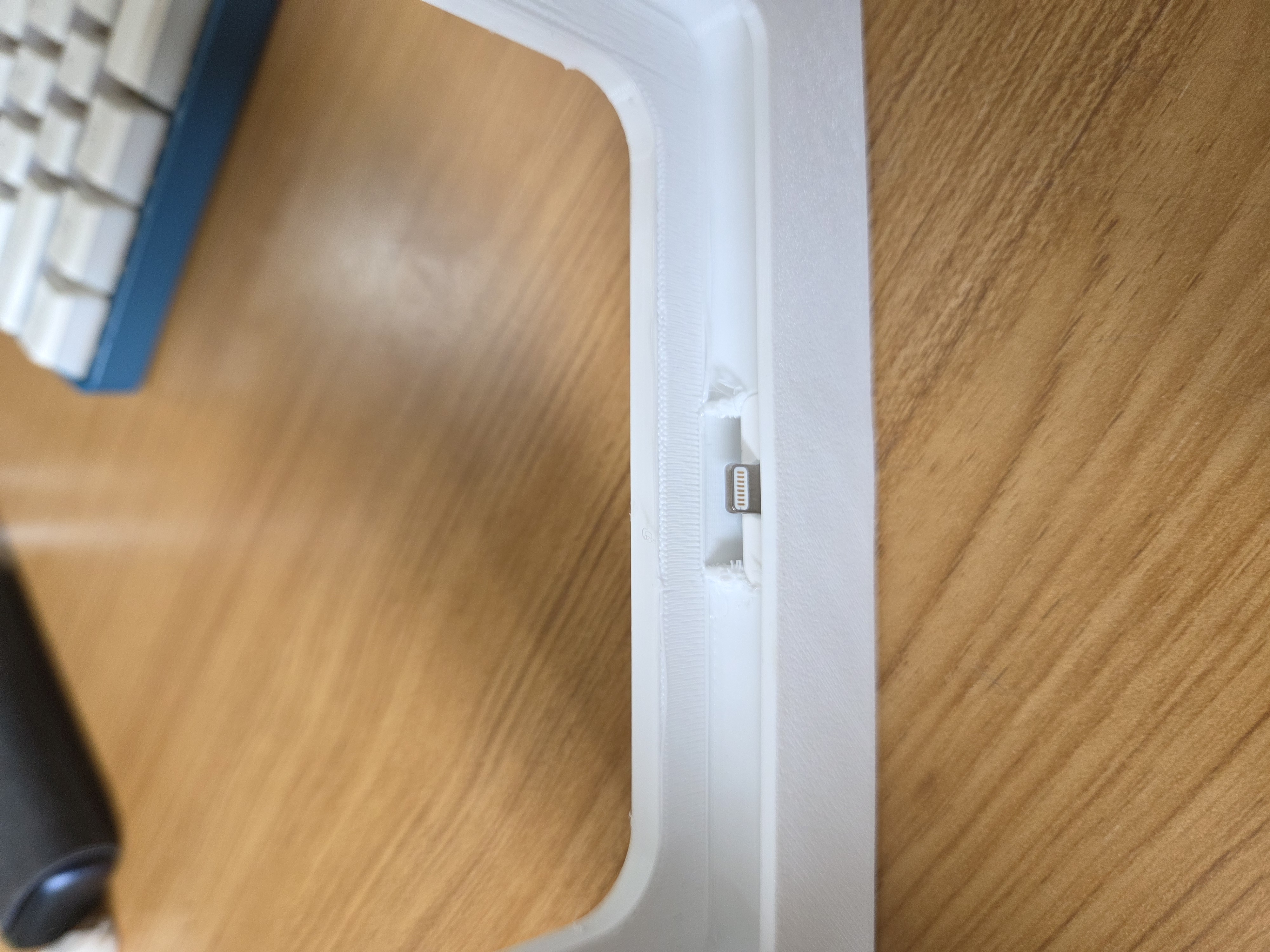

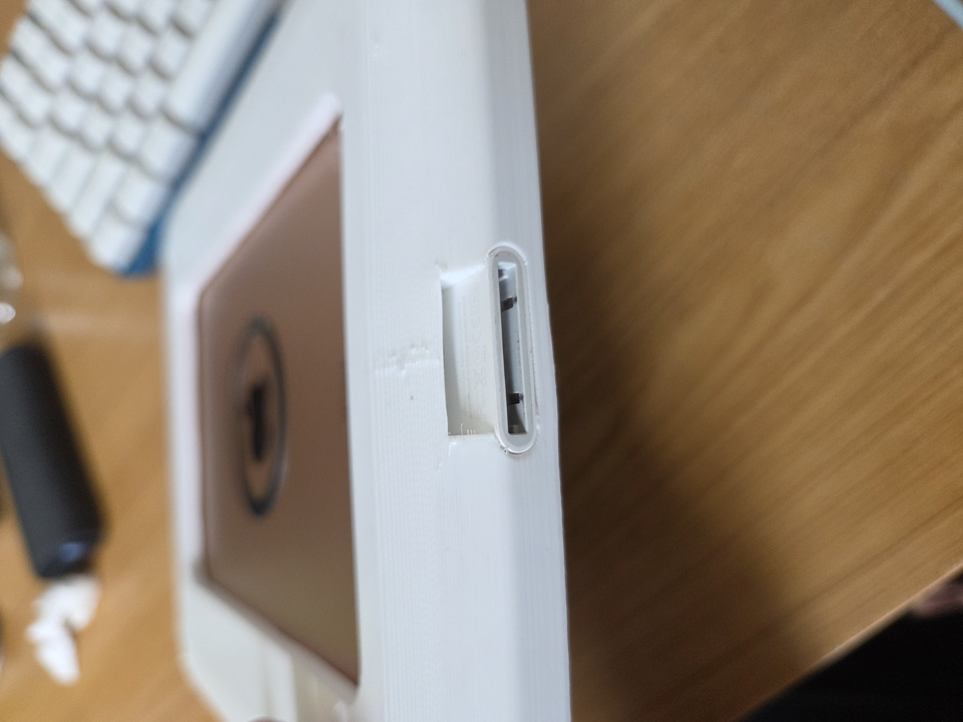

1 August 2026 at 11:51 #124791Li tian

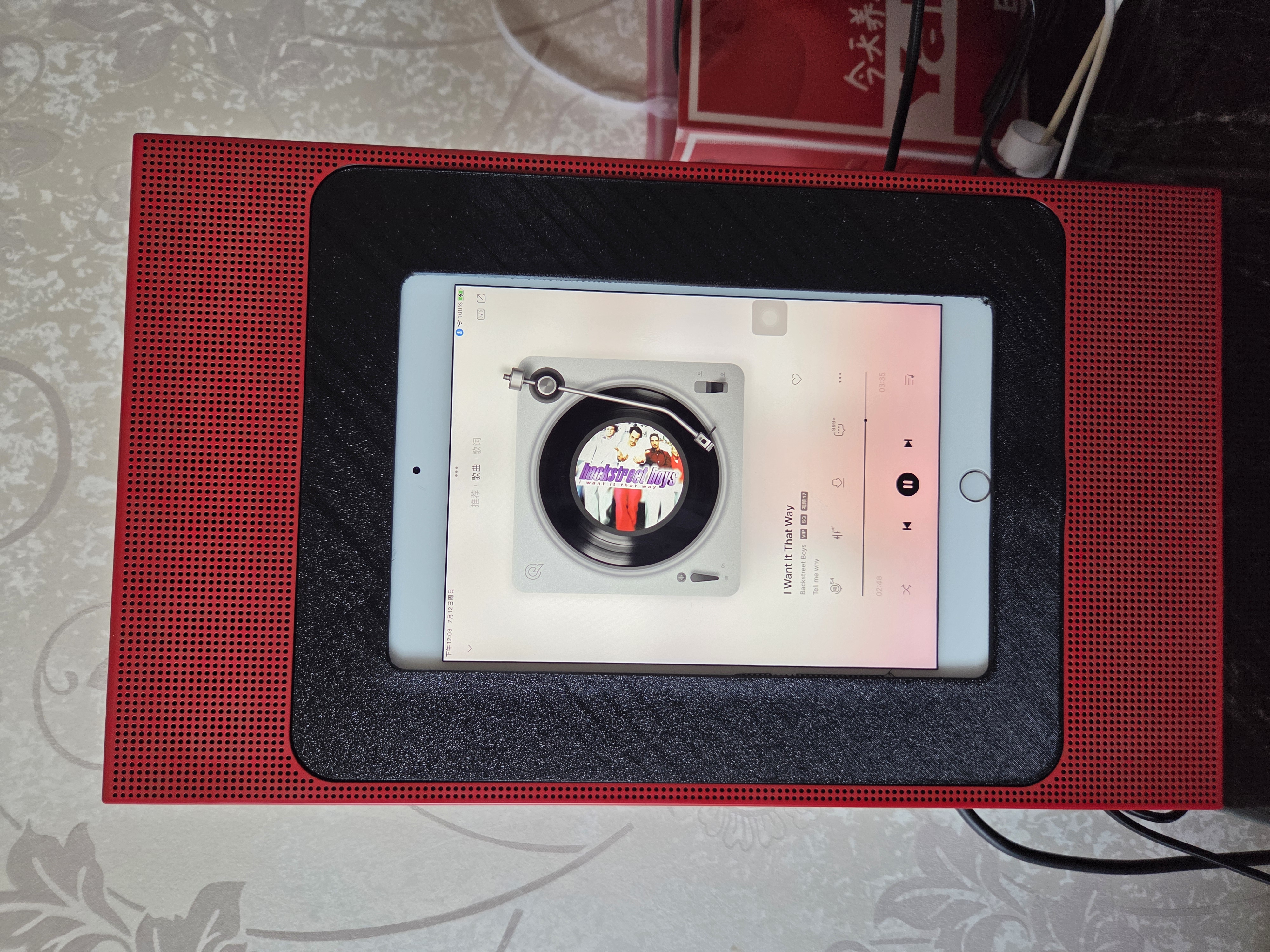

BRONZE MemberModeling is carried out using 3D scanning technology, followed by fabrication with a 3D printer. Paired with an original Apple adapter, the finished product is compatible with the new iPad mini models 1 through 5. I made it in two color options: white and black.In addition, the A3 device has been upgraded with a 3500mAh Samsung 18650 battery,resulting in significantly improved battery life.
1 August 2026 at 11:55 #124794Li tian
BRONZE MemberThe iPad mini 5 is the best model. Released in 2019, it is equipped with the A12 processor and can still be updated to the latest operating system to this day. Other iPads with Lightning ports are either too large in size or inferior in performance. I have tested USB‑C port iPads, and they do not work with an L-to-C adapter.
1 August 2026 at 18:33 #124799 T.W.G
GOLD MemberGreat work!!
Did you completely remove the original inner casing and replace it or is this a custom fit into the original A3 shell without removing anything?
Do you consider to provide the 3D files for other people to print them, t00?
I guess inferios ipads with bigger sizes would be okay, too for other members if you just use the A3 as some kind of music- and smarthome terminal that runs the B&O app, Home Assistant etc.
2 August 2026 at 05:33 #124806Li tian
BRONZE MemberFirst, perform a 3D scan on the original protective case, iPad mini 5 and Apple OEM adapter. Then modify the model based on the scanned data of the original case. Since I need to use the genuine Apple adapter, I want to avoid damaging the speaker base. If adopting the solution for standard iPads, the base would require hole enlargement to conceal the adapter inside the speaker enclosure. My design mounts the adapter within the protective case instead, leaving all original hardware completely untouched. A second-hand iPad mini 5 only costs $74 in China. My cellular-enabled iPad mini 5 was purchased at the same price, with zero scratches or dings. In addition, the genuine Apple adapter is $12, and the B&O A3 speaker is around $40.
