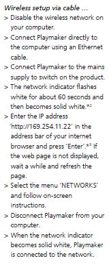

    • After a further factory reset, I was able to complete to complete a ‘wireless setup via cable’ using a laptop (switched to airplane mode) and the following instructions:
    I found the Playmaker setup menu under the published IP address of http://169.254.11.22 – so perhaps it is indeed just different for the Mk2 Playmaker (or perhaps it is only for first time setup via cable – I haven’t seen a Mk2 manual).
    I am not sure how the above helps @TWG, but am happy to experiment further if required.  It would be useful to know if his Playmakers are Mk1 or Mk2, but I would recommend webpage setup using a computer on his home network to find the individual devices by IP address (look in computers Network folder for Playmakers) and change settings as required.
    Ok I just realised that when I used http://192.168.1.1 I was actually connected to the wireless network the Playmaker makes, so at least for the MK2 it is possible to connect to the Playmaker network and set it up via this IP adress.
    But to check the cabled network setup I did a double factory reset (first with the button as per instructions in the manual, and next in the web interface). At no point was I able to connect to the Playmaker by using  http://169.254.11.22 . However when using an IP scanner I found that the Playmaker had the IP adress http://192.168.1.175 which I also have noticed at another point.
    Accesing the web interface without having done any setup the status page on my MK2 Playmaker shows this which confirms the wireless and wired network IP adresses
    Edit: The IP adress http://192.168.1.175 may just be a DHCP provided IP from my router, but none of the less it is not the fixed IP that is mentioned in the manual for cable setup of the Playmaker.
