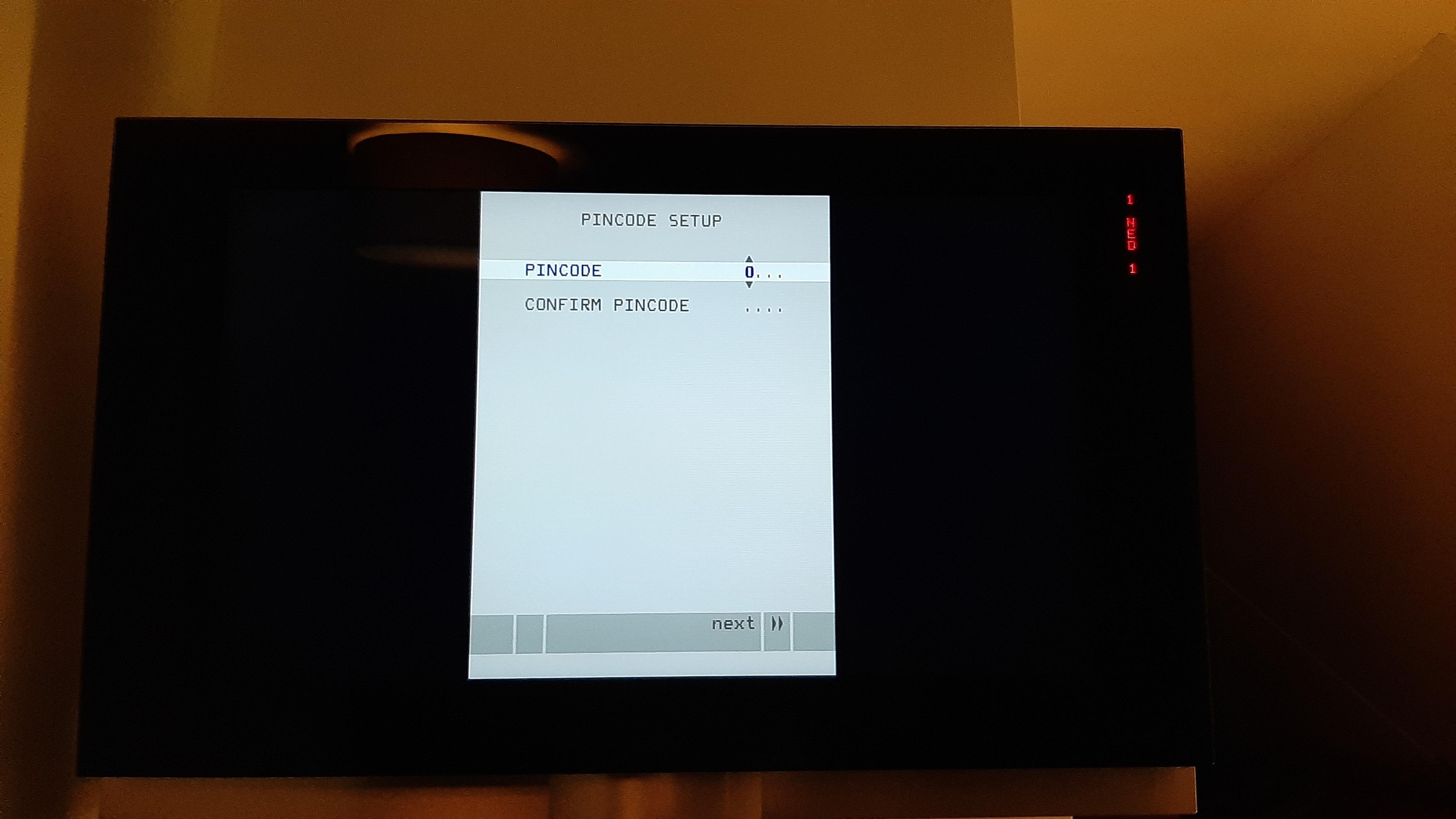

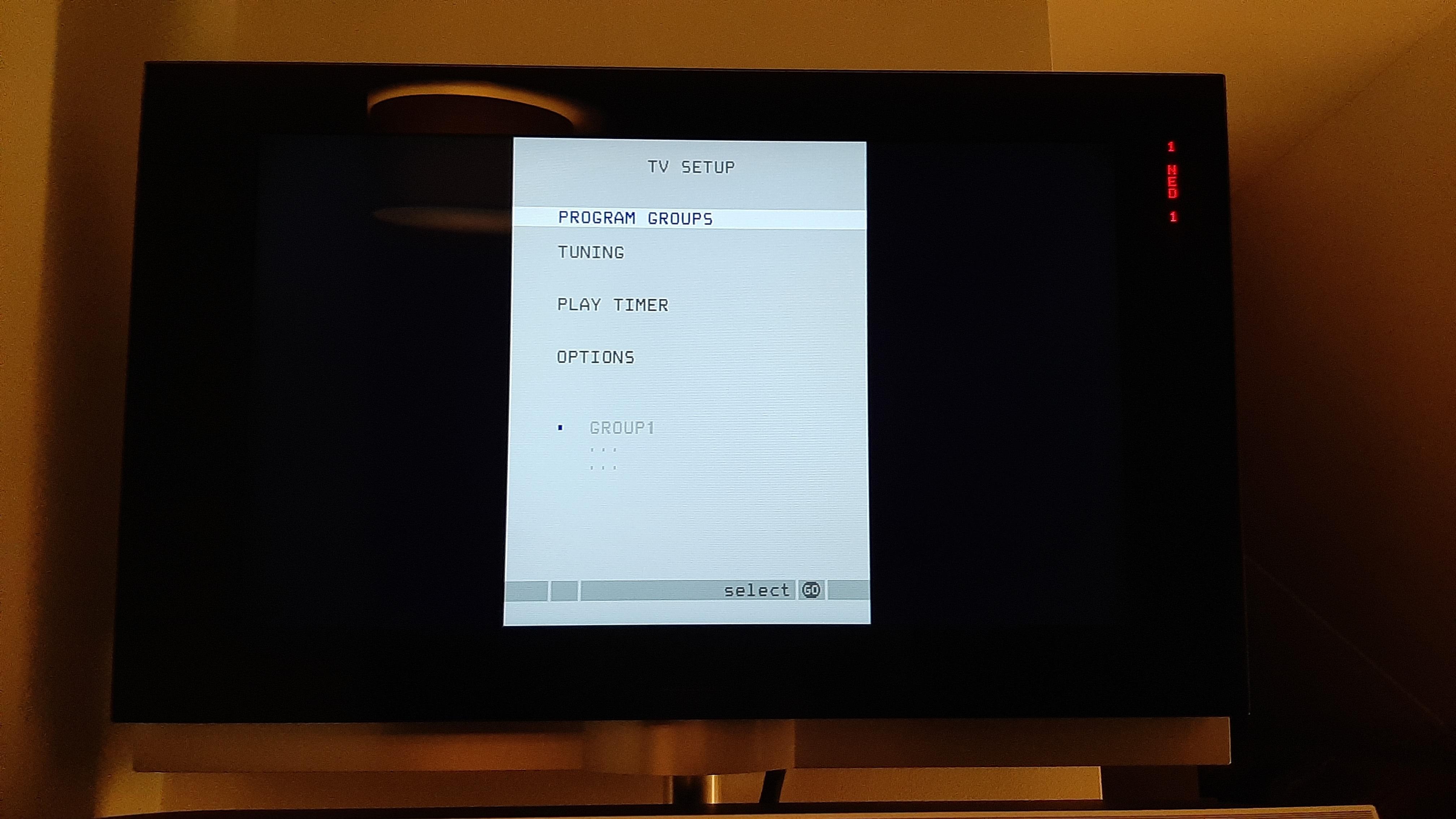

10 January 2024 at 08:28 #51857 TignumGOLD MemberHello, on my 7-32 9331 it just works as described, using a normal ‘GO’ Beo4:
When seeing the above screen I press << << STOP and I get the screen here below.
Hope this helps. Johan

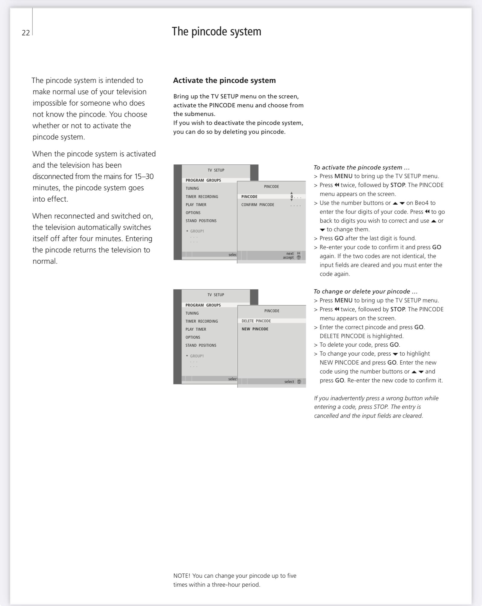

10 January 2024 at 12:39 #51858 9_LEEBRONZE MemberJ0han is of course correct. Left, Left, Stop works on quite a few products. Usually when highlighting over the Options tab on the TV’s.
Lee
