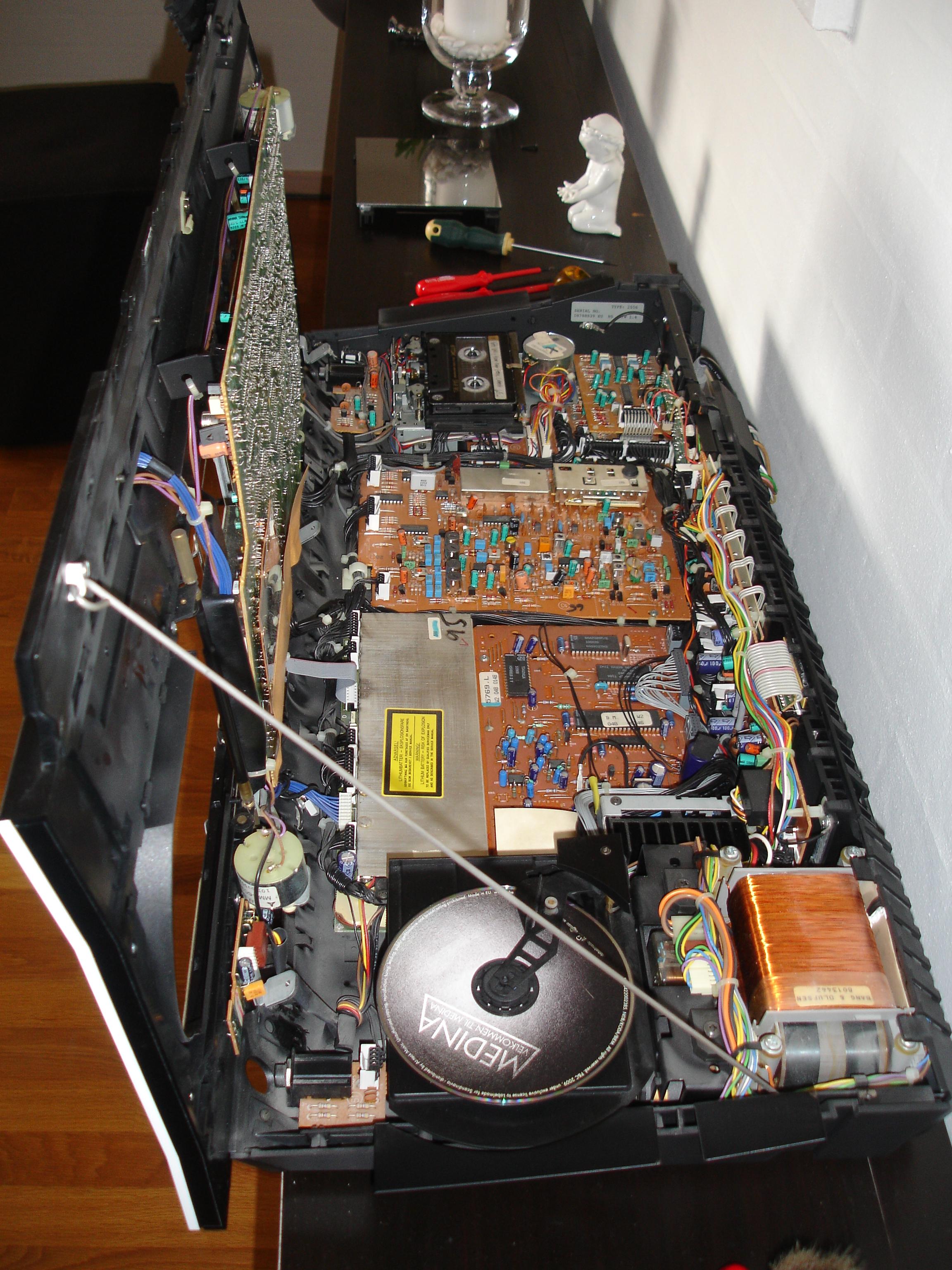

5 April 2024 at 08:51 #54047 GuyModeratorFurther to all the excellent advice above, you will see from the picture of my similar BC9500 below that all the cables and connections should be routed through the front edge of the BeoCenter, thus allowing it to pivot forward and upwards freely:
(Note that it was opened up with the CD/Tape doors closed – the doors were then opened whilst in the service postion)
Location: Warwickshire, UK
