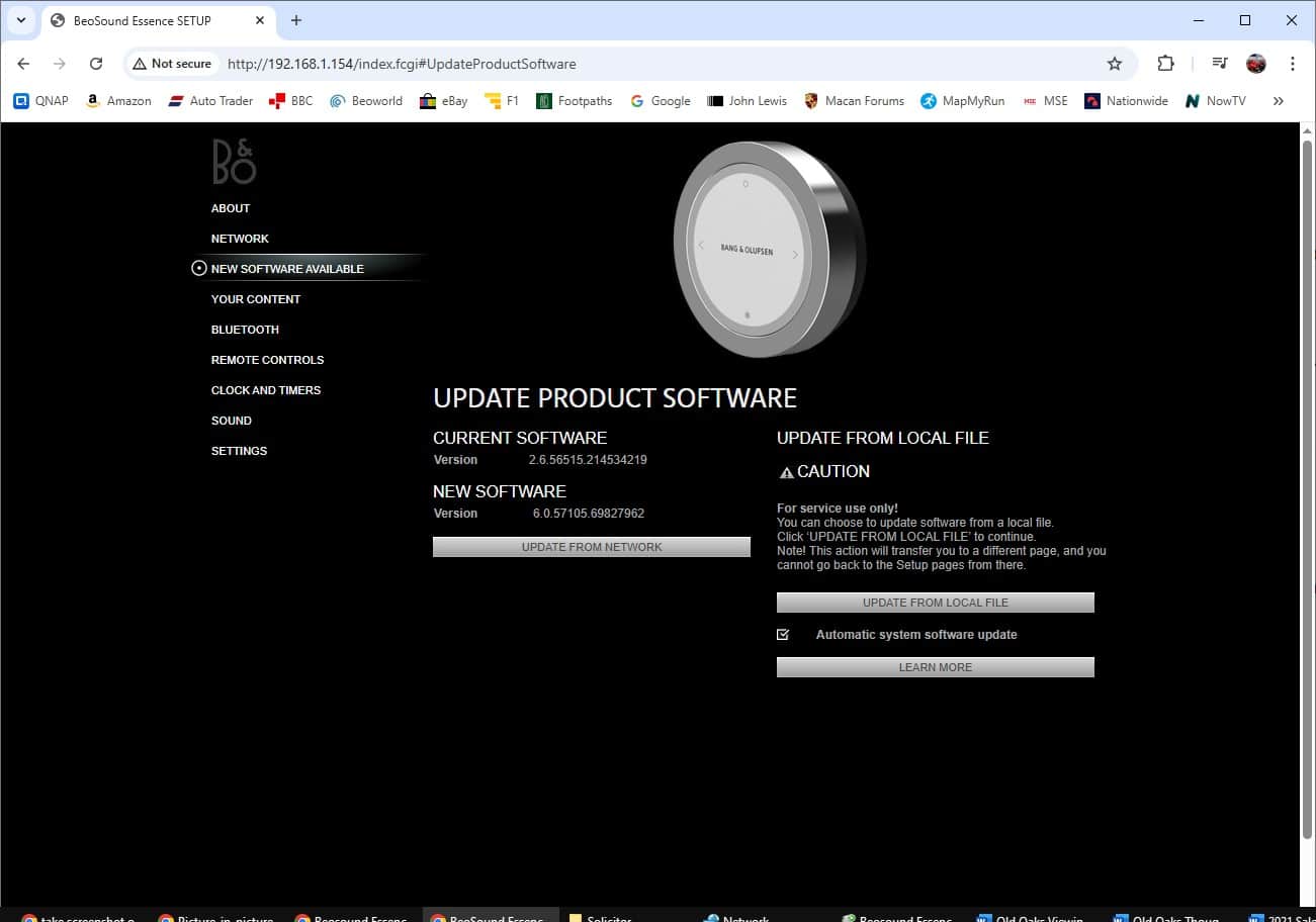

But the Essences and the Beosounds will not recognise that there is newer software available. All stuck a few versions earlier.27 April 2025 at 11:03 #65343 GuyModeratorI just connected my Essence – it is showing as avail:
Location: Warwickshire, UK

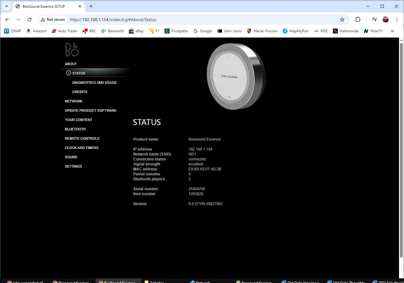

27 April 2025 at 11:07 #65345 GuyModeratorAnd has successfully updated to version 6.0.57105.69827962
