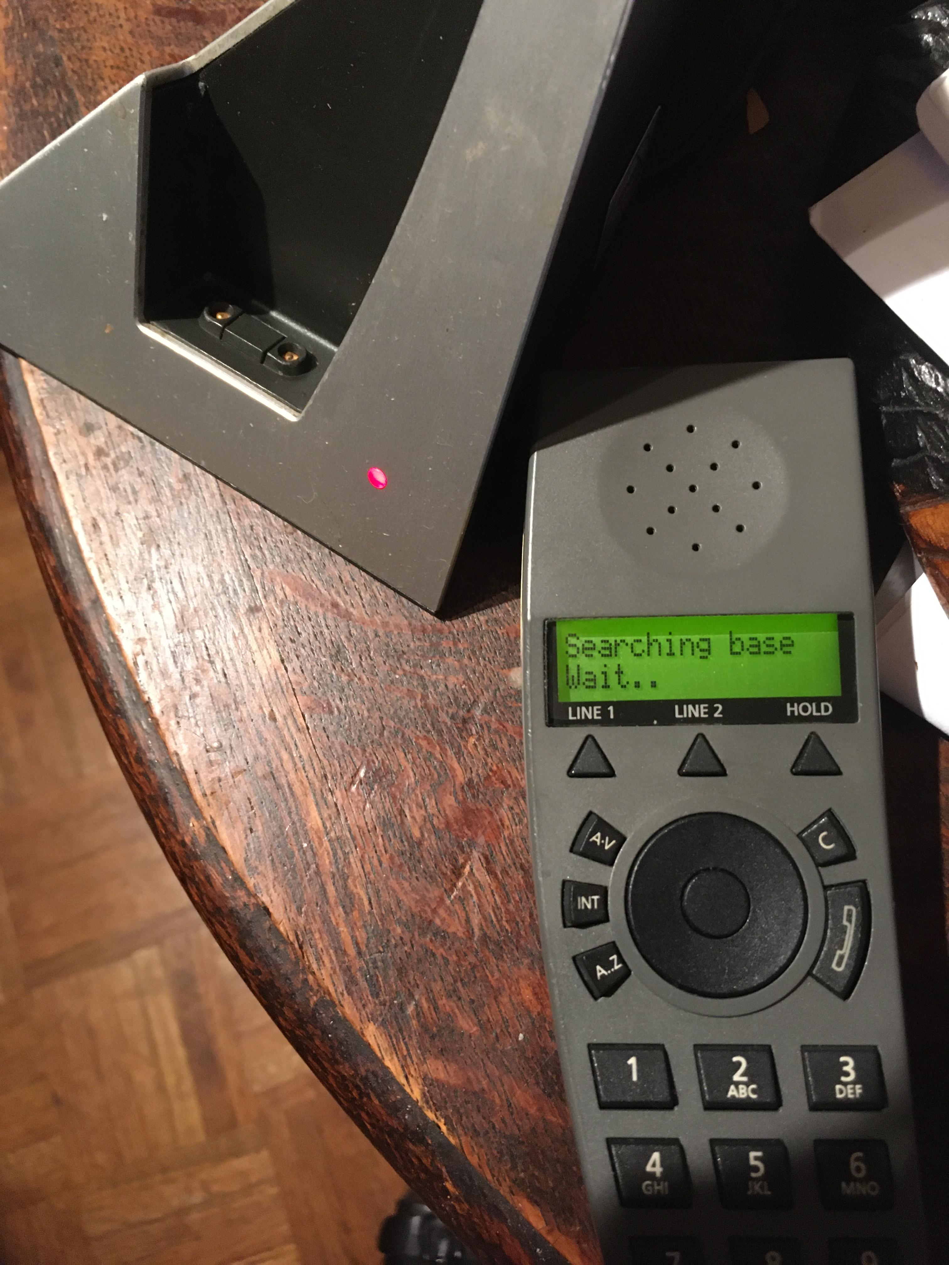

    Hi everyone, so I got as far as this. the extra phone which sits in its charger will be my bedroom phone, the base with your original phone that I purchased 18 years ago is in the living room. So far the extra phone can’t seem to find the bace, even when the base is blinking red I tried to follow the owners manual directions but I must be missing something please advise I would like to use this new lovely yellow version of the phone. Thank you so much

    I am not sure what your first (PSTN) base type is, but has it reached the maximum number of handsets connected (hence won’t be able to connect any more)?  If your PSTN base is the one in the picture then it has a maximum of 6 connected handsets.
    Using the initial (already connected) handset, go into settings then the ‘base’ menu and then remove any handsets that you don’t currently use (or recognise).  Then try to connect your new handset again.

    The base that you show in your picture seems to be a BC6000 base, which I do not think was produced for the US market. This may be because the DECT frequencies (between base and handset) were not to US standard for cordless phones.
    Have you seen this table:
    phones
    The above shows that a Beocom 1 is not compatible with a BeoCom6000 base.  It needs to connect to a ‘Beoline US’.
    Is your other working handset actually a UK/european spec BC6000 Mk2 – where the three buttons to the left of the wheel are ‘R’ ‘INT’ and ‘AV’?  If so, this will connect to a BC6000 base without problem.
