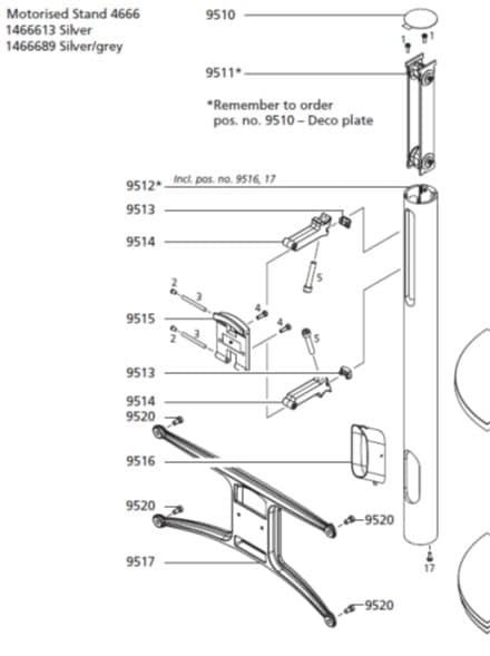

31 August 2026 at 15:46 #125319 GuyModeratorHi and welcome to Beoworld!
Your photo shows a BV10-40 or 10-46, I am not sure which. Either way, even if you had the correct ‘spider’ piece (labelled 9517 in the diagram) which fits onto the back of the BV10 ready for stand-mounting, the black holder piece at the top of your current stand is too wide to fit into the slot. On the proper stand (see below) the part labelled 9515 is narrower.
Diagram is from the service manual (full manual available on site to Silver/Gold Members): (click to enlarge)
I would look for a second-hand BV10 stand – they do come up on the usual sites very occasionally!

BRONZE MemberThat’s exactly what I hoped someone could help with, thanks Guy. My head was battered looking at flat plates, ALIEN spiders and a couple of other options and there was just no definitive, easily understood answer.
It seems a shame to waste the present stand, I may see if I can source a 9515… though if a BV10 stand came up, I could sell the stand for the BV7.
