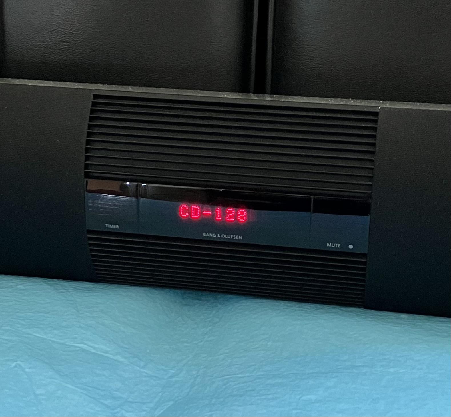

Location: Denmark10 January 2024 at 11:43 #51009ModeratorAs an aside, an example of BL3500 displaying something different , albeit not metadata. When my BL3500 was connected to Beoport and PC computer, selecting/playing the PC’s CD from the BL3500 would display this: (and it wouldn’t display CD track number)

Great, thanks for sharing that info! That’ also what I’m seeing here. I thought the laster versions of BL3500 might have introduced metadata – but probably not.
