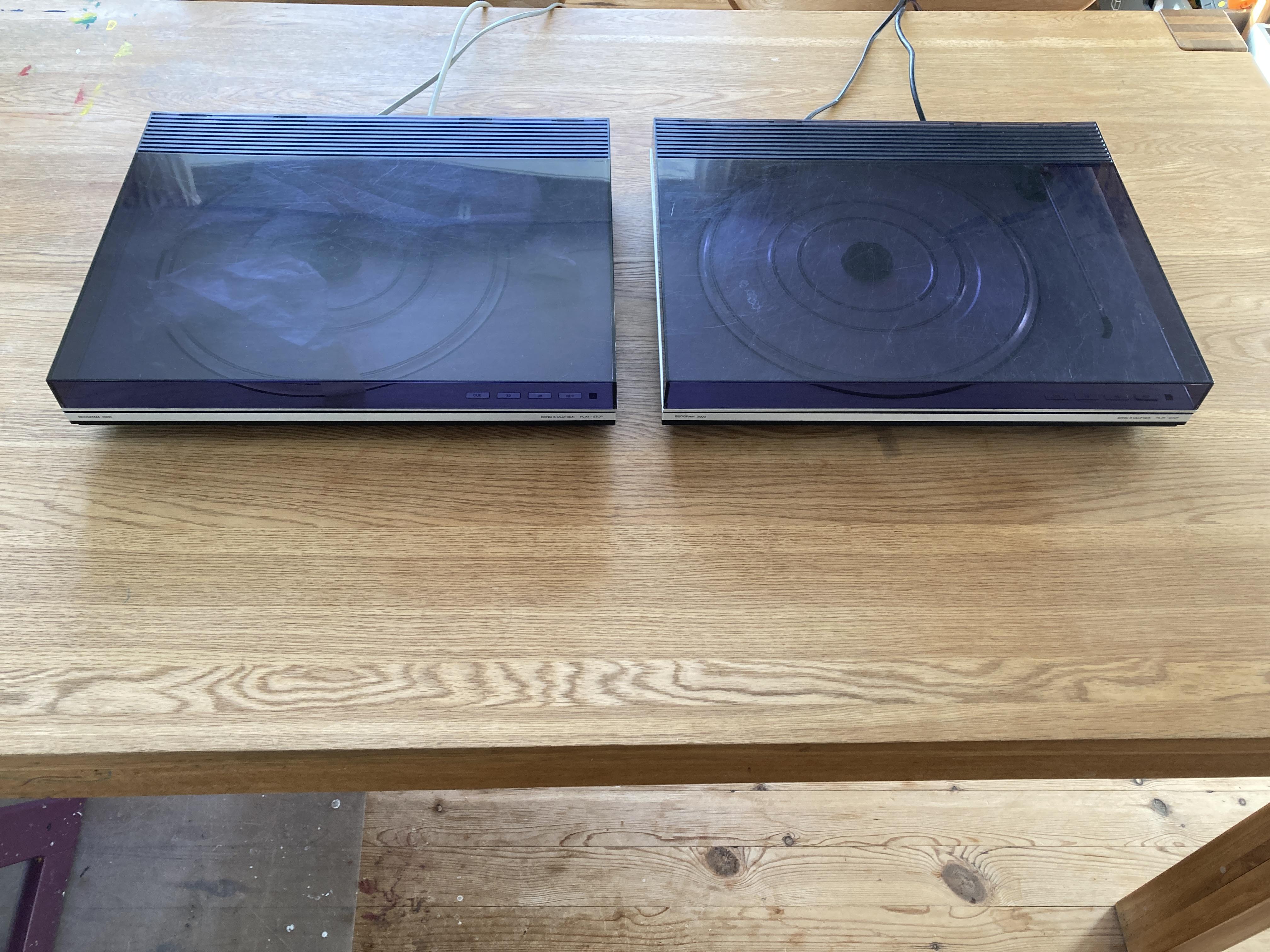

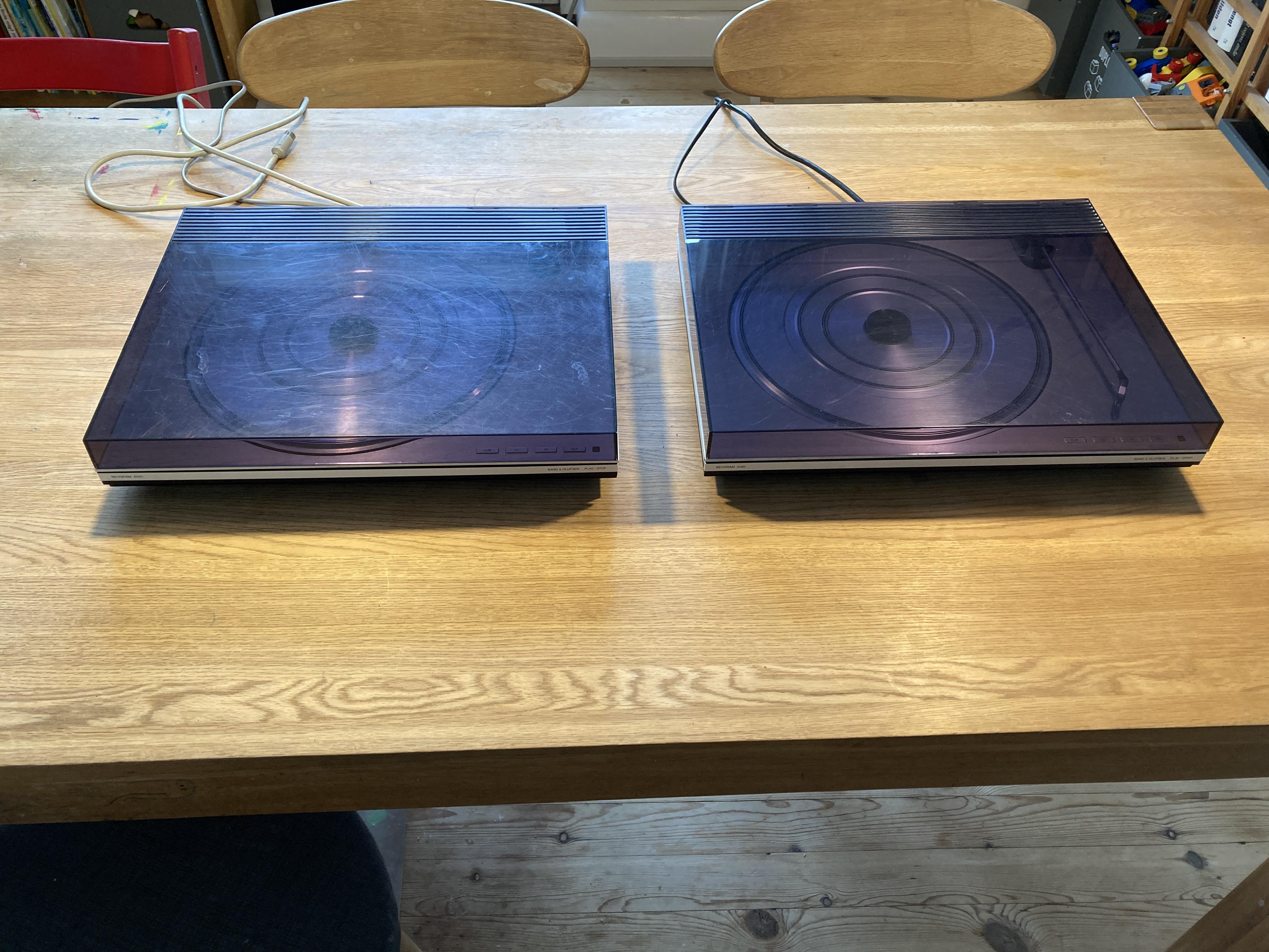

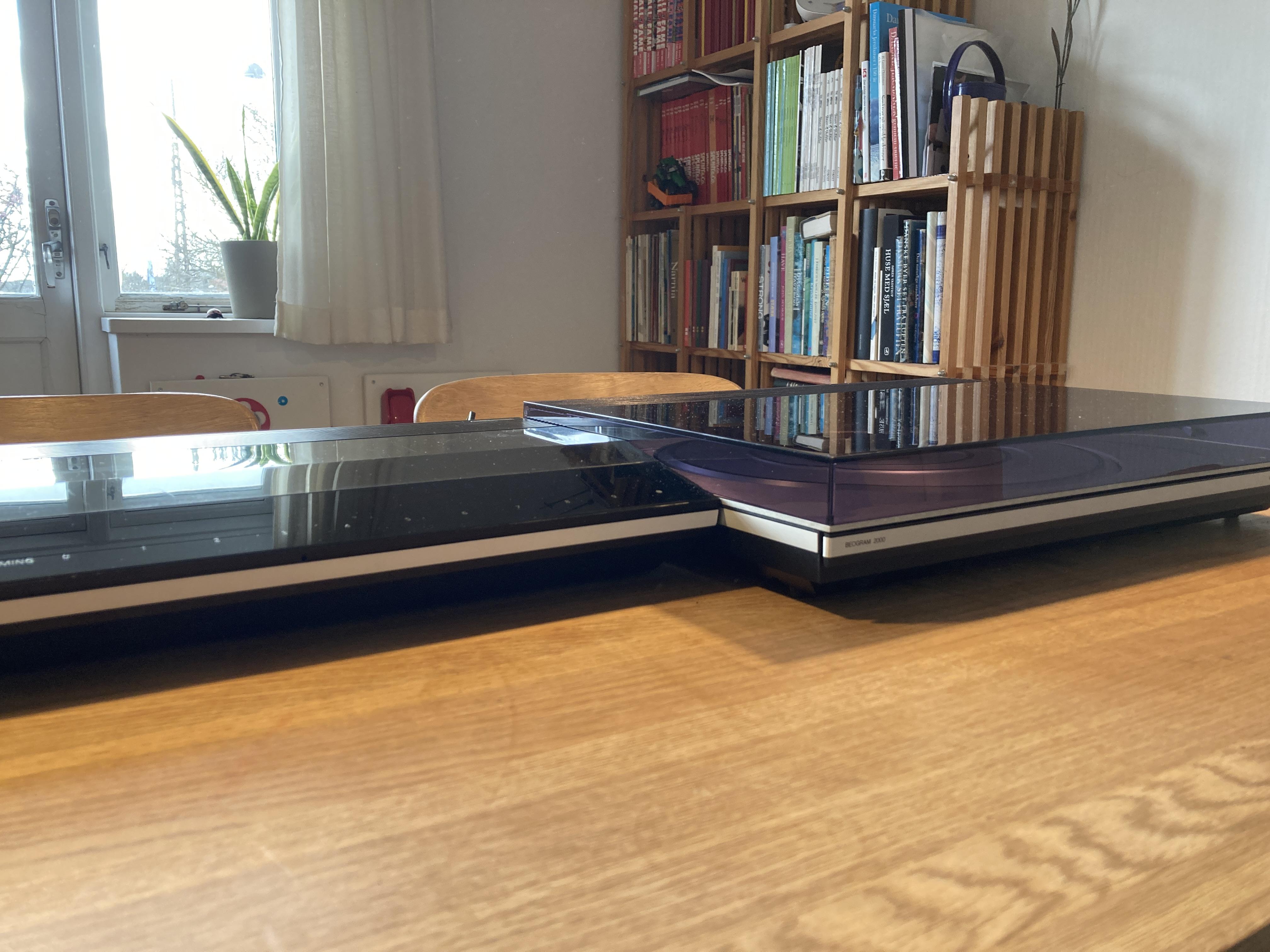

23 February 2024 at 18:52 #52536Madskp
GOLD MemberLast week I found another Beogram 2000 for the same price which is in much better cosmetical condition, but where the pickup arm i broken off. I now hope I can combine the best from these 2 decks and get a decent Beogram out of it for almost the same bargain price that you got yours for
I now got around to combining the 2 Beogram 2000’s to one fine unit and the one that may end up as spare parts ( I am waiting for B&O to launch the Beogram 2000c upgrade program 😉 )
First a before picture with the non working, but cosmetically fine on the left, and the working one with the very scratched dustcover and stained aluminum surfaces on the right. The cosmetically fine one do have scratches in the dust cover, but not near the amount on the other unit.

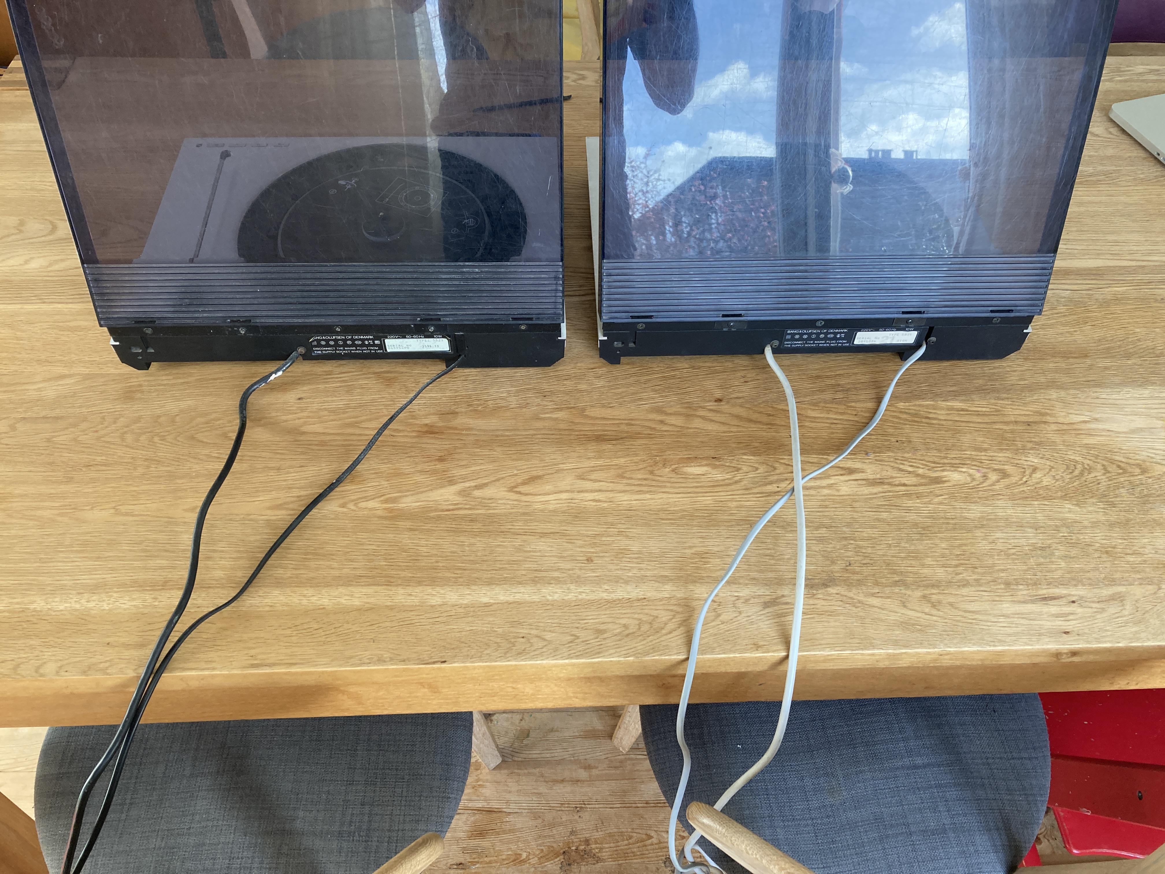

I noticed that the one unit has grey cables while the other one has black ones. The one with the black cables has a higher serial number, so might have been a little design change along the production life.

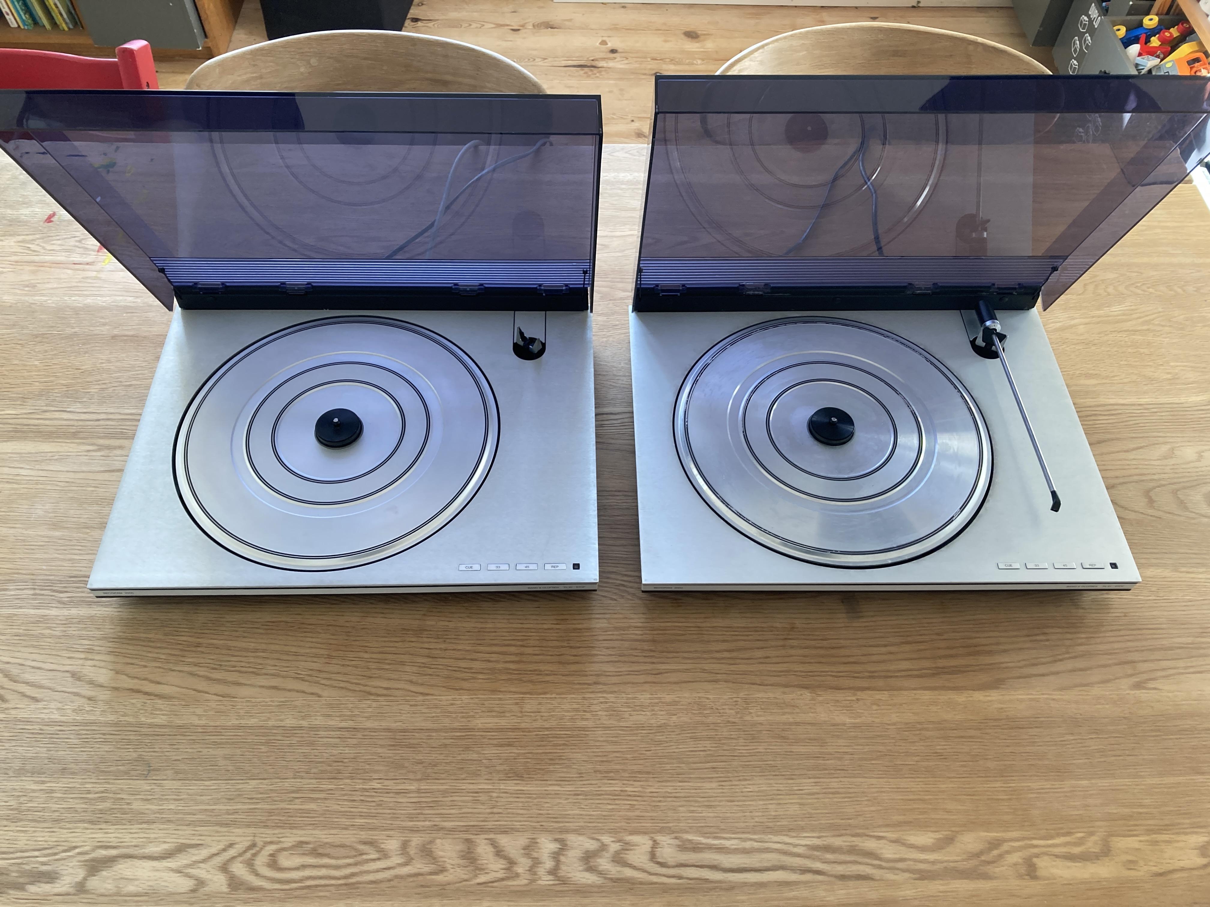

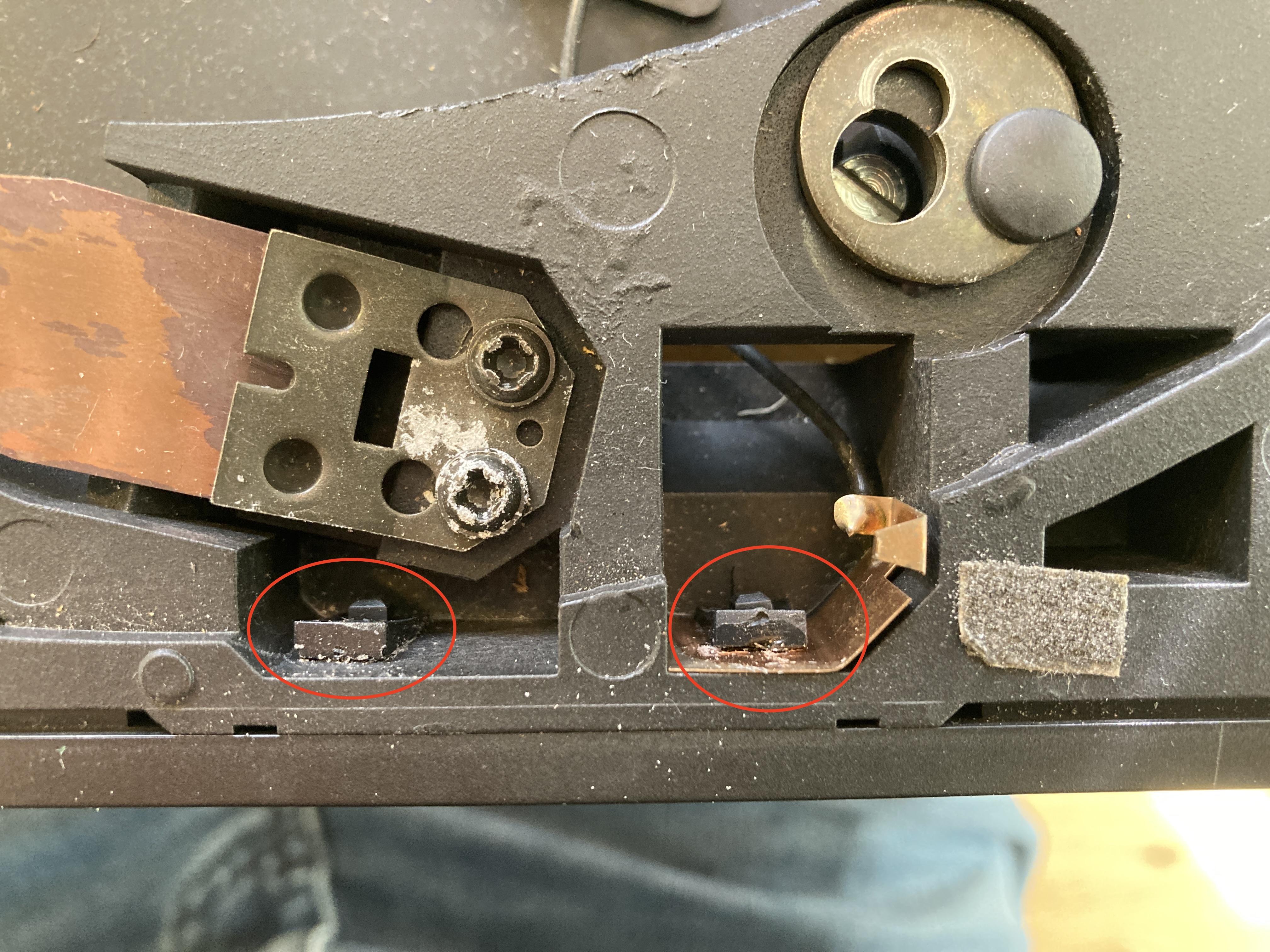

During the disassembly I leart the on the working unit one of the transport screws was still secured, and while it was wokring I had to do some height adsjustment of the platter after loosening that screw.
The front strip also had scratches on the aluminum on the working unit so had to replace that. It is held in place by three plastic clips that is secured with glue. At first I was not sure If I could get those plastic clips of without breaking them, but with a sharp knife and a little wigeling it was succesfull.
While I was in there I also replaced the belt and the caps. I did not change the speed trimmers as I do not have the equipment for testing the speed for now, so that must be for another time.
On the non working unit i noticed that the motor rattles when I move it arround so it might have other faults that just the broken of pickup arm.
And an after shot of the 2 units
So all in all a succes. It might need some tweaking of the speed and some other adjustments, but for now it is ok. Also the only thing I have with a RIAA amplifier for now is a Beomaster 2400 where the right channel is not working, so no in a hurry with the adjustments.
Whilst the 5000 is essential as a part of the 5000 system as it matches correctly, when taken in isolation I think the Beogram 2000 is the nicest looking – sleek plinth styling and a full clear lid
One thing I have noticed is that the Aluminum line on the sides on the Beogram 2000 lines up nice with a Beosystem 4500 and the aluminum nearly matches the white color on the Beosystem 4500
