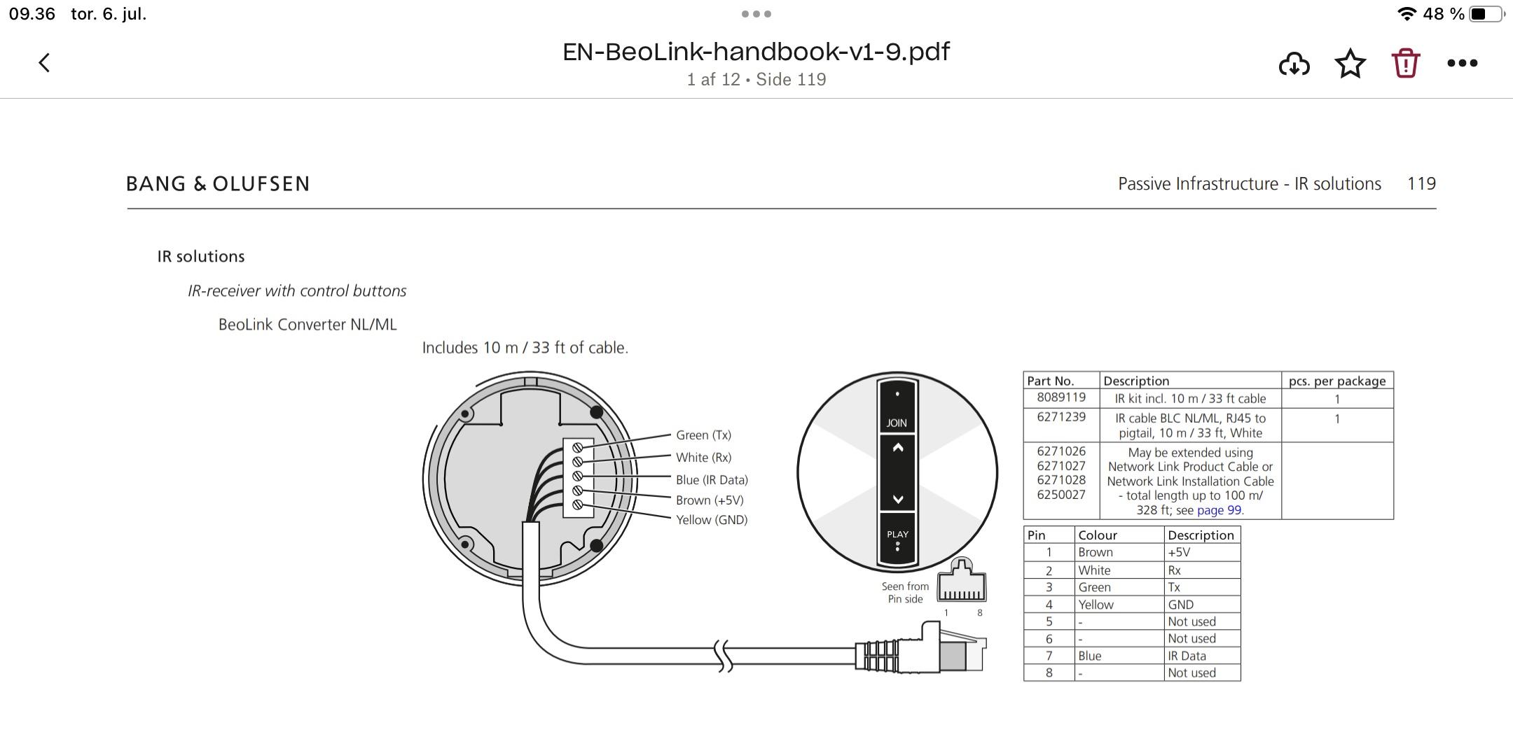

    #47499
    Madskp
    GOLD Member
    I am buying an IR Eye for my BLC.   After all these years, I had failed to realize that there are multiple “buttons” available.  From when we first got a B&O decades ago, I had thought the only button was “LIGHT”! Well, it seems to me that a “Join” button would be spectacular, if were able to make our BL 6000 speakers to join in whatever is playing elsewhere.  Or are there better-suited IR Eye options for our setup?   Thanks in advance.
    I don’t know if there are better suited IR options, but if you only need the IR functionality you should be able to use most of the external IR eyes B&O has made including the rectangular ones from the MCL products, as long as only GND, 5V and IR data is used and wired correctly.
    But If you need the button functionality of the IR eyes you are limited to the one with the JOIN button as the other IR eyes use different BUS communication between the IR eye and the unit it is controlling.

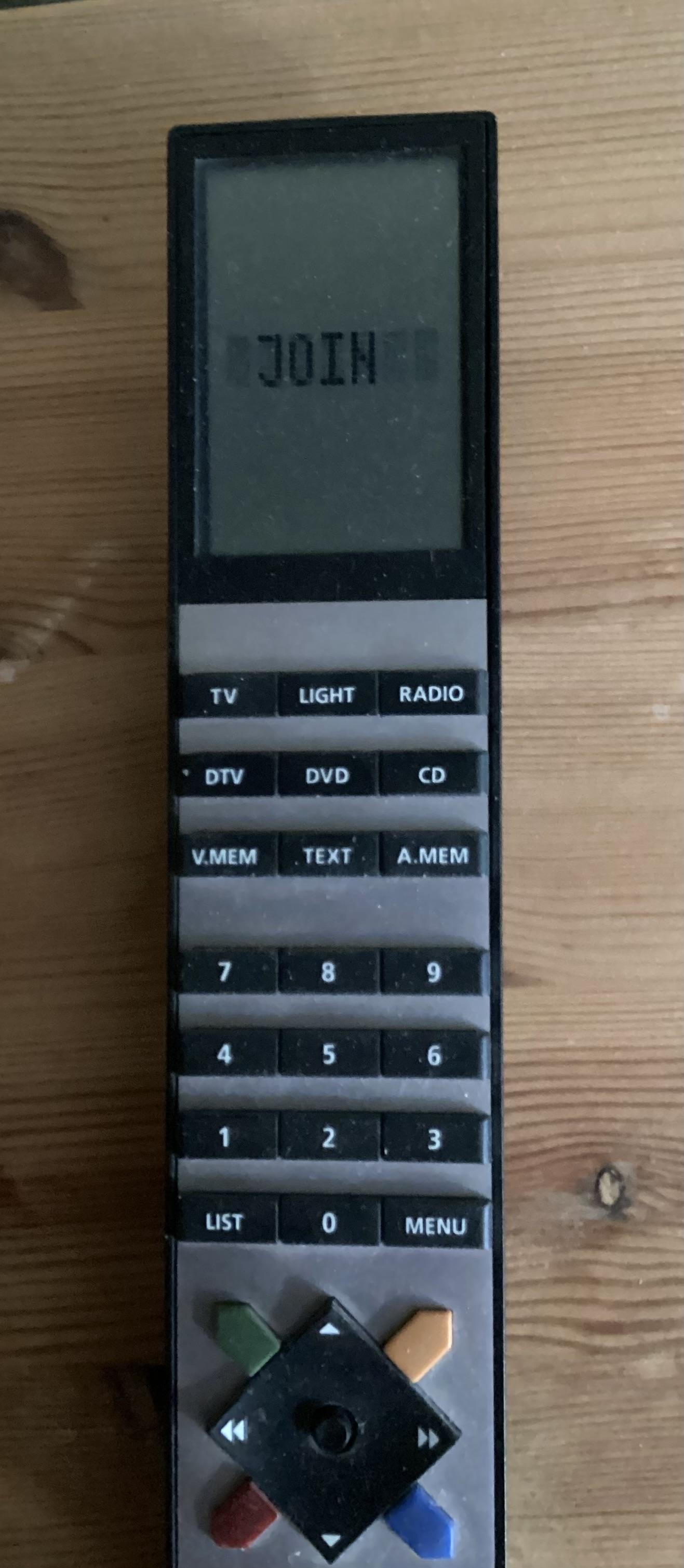

    #47500
    Millemis
    This is it:
    IMG_0609

    #47502
    Guy
    I have no experience with the NL/ML converter, but according to the lexicon the JOIN function can be added to the LIST Button of a Beo4 Navi (the one with the little joystick)
    join
    EDIT:  And according to this the Beoremote One (IR version) can send the command also: https://support.bang-olufsen.com/hc/en-us/articles/360041742571-How-do-I-activate-sources-using-BeoRemote-One-or-Beo4-
    Location: Warwickshire, UK
    #47503
    Millemis
    #47504
