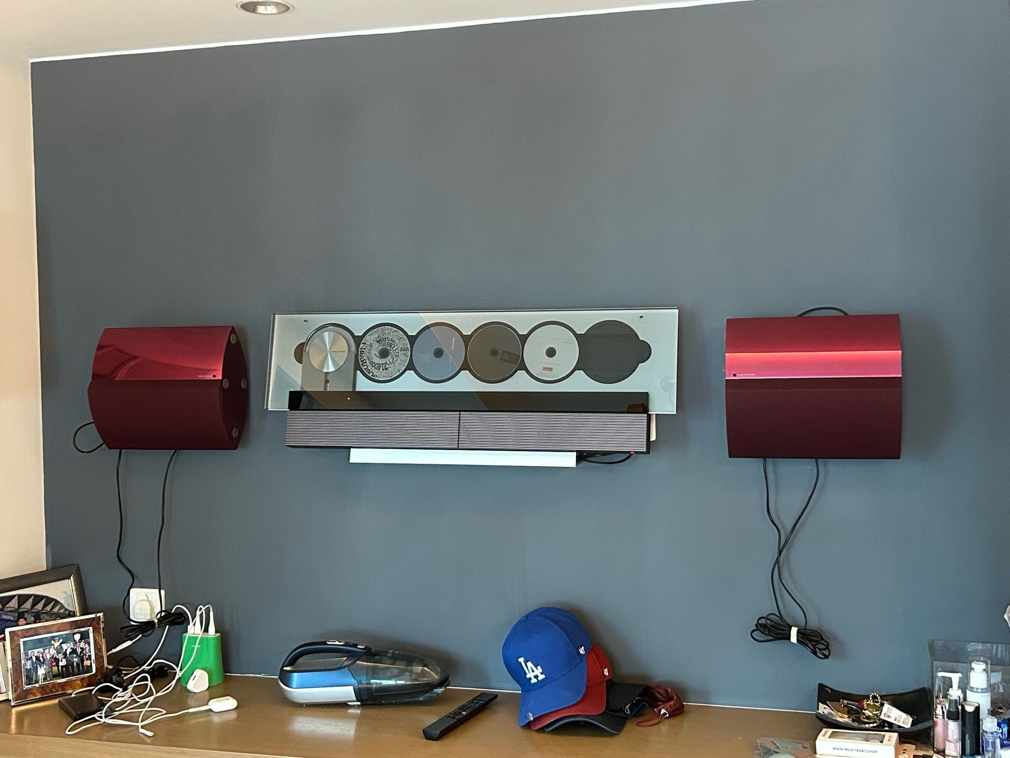

BRONZE MemberHi all,

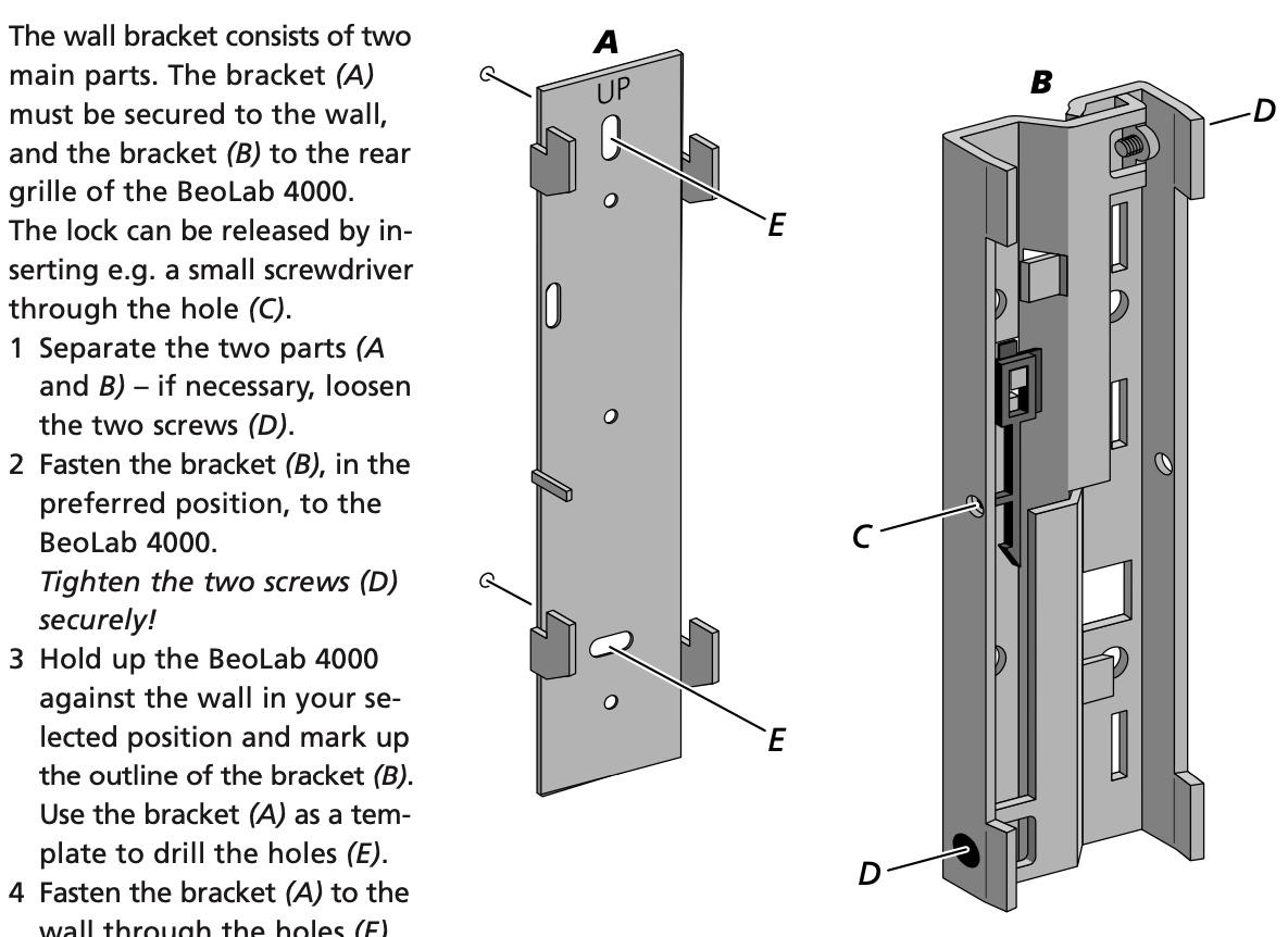

So I have my Beosound 9000 6 cd changer mounted on my wall and want to remove it for cleaning. I didnt actually install it on the brackets when I moved in. What is the best way to remove it? My sound has become a bit distorted sometimes and I just cleaned my CD lense reader which helped alot.
Also have my speakers on brackets on the wall too that dont want to budge. They are raindrop shaped ones if that makes sense …
Any help would be appreciated. Thanks
14 November 2023 at 08:04 #50443 TignumGOLD MemberHello George, on the sides of the wallmounts you should be able to see a (bit of) the red latch through hole C (see below). Pushing with a suitable pin will release the hatch, and you should be able to slide the speaker off.

15 November 2023 at 01:26 #50444George M
BRONZE Memberthanks johan this is very helpful …
Anyone able to help me with the BS9000 also? Thanks
15 November 2023 at 06:58 #50445Valve1
GOLD MemberI am not familiar with this wall bracket or way of mounting it. From the 2 brackets I do know the 9000 usually is hanging on two pegs so its just a straight lift up.
BUT do have a second person to assist as once you have lifted it just above the wall bracket you will need to disconnect the power cable and speakers. Its a bit fiddly but you will have to do this in reverse to put it back up.
15 November 2023 at 16:41 #50446 matador
ModeratorThis is the usual B&O table stand hooked to the wall.
Tilt and lift the main unit to separate it from the wall hooks part. See Below.Location: Paris France
15 November 2023 at 18:13 #50447 jmenBRONZE MemberIf the Beosound 9000 is mounted flat on a wall, then there should be a plate with hooks mounted to the wall and a plate with openings mounted to the BS9000. As mentioned above, dismounting the BS9000 from the wall is accomplished by lifting the unit vertically (to clear hooks in wall plate) and then away from the wall (to separate unit plate from wall plate).

16 November 2023 at 02:52 #50448George M
BRONZE Memberthanks .. I got it off the wall but still trying to get it off the bracket … seems almost glued onto it haha … Any special way to take it off the bracket or just tilt and lift off?
Thanks
16 November 2023 at 06:58 #50449Valve1
GOLD MemberThanks Matador, I did not know the table bracket could be wall mounted.
George M, it looks like a tilt and lift is the solution.
17 November 2023 at 10:02 #50450 matador
ModeratorAny special way to take it off the bracket or just tilt and lift off?
They should be screws in the top and bottom side like 30 cm from the side edges.
On the top side I think I remember they go through the bracket into the unit.
On the bottom side they are just like pegs sitting in a groove in the stand.Location: Paris France
