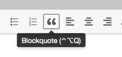

    matador
    Hi Millemissen,
    When you quote someone’s post you may want to unclic the “Block quote” button in the toolbar after a carriage return to have your message displayed as a plain message.
