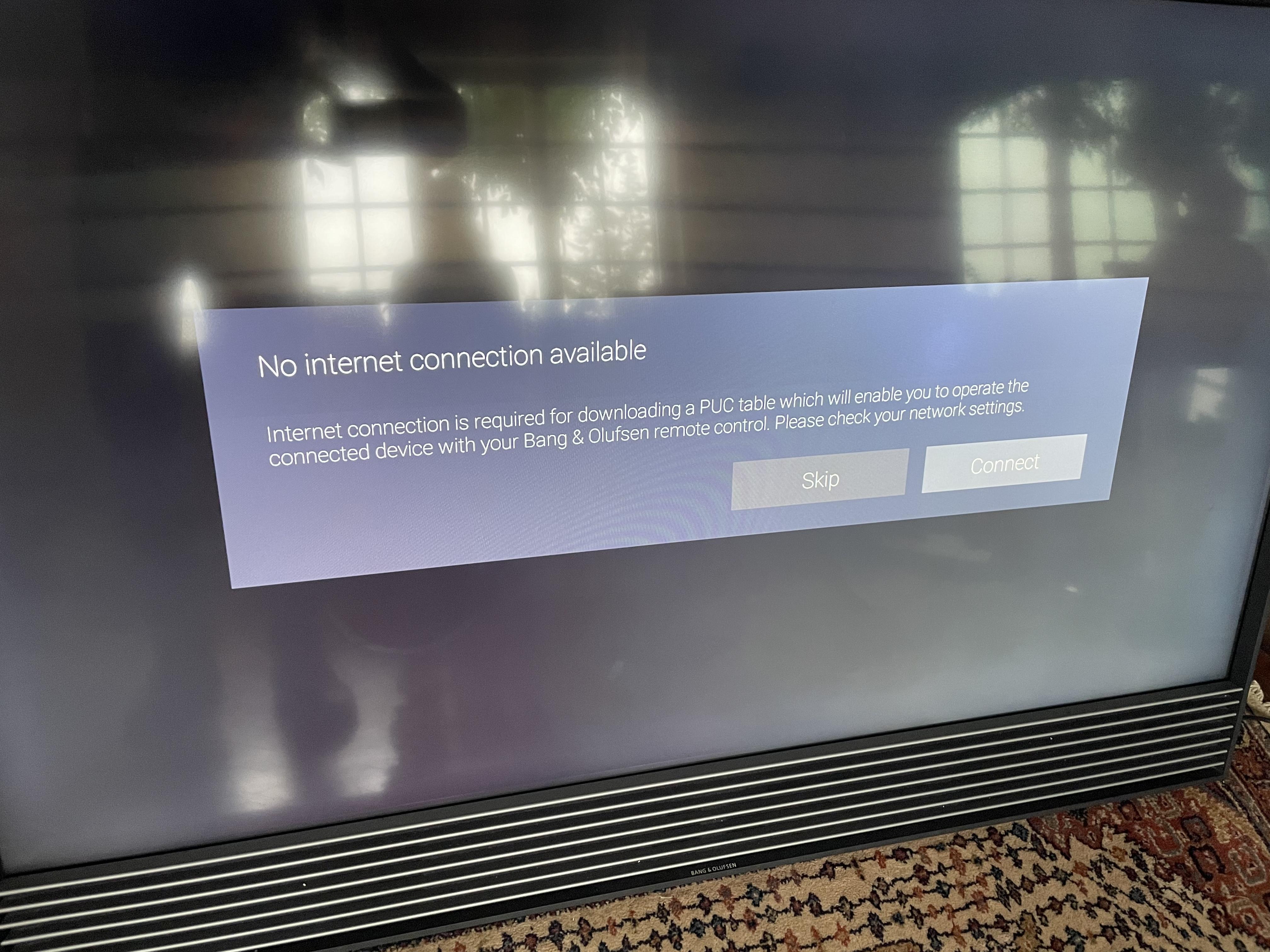

27 September 2023 at 12:05 #49342Pipeandslippers
BRONZE MemberWell this is a result. It seems to have got past the boot loop so real progress…I’m reluctant to turn it off now!
I cannot click connect because it isn’t paired with the remote. I’m going to try the remote app again if I can find it.
27 September 2023 at 17:40 #49343 RavstedBRONZE Member… and it won’t pair now by pressing the pairing button on the backside of the TV ?
27 September 2023 at 21:34 #49344Pipeandslippers
BRONZE MemberThere’s a pairing button?! Where’s that? I haven’t seen it. Thanks!
