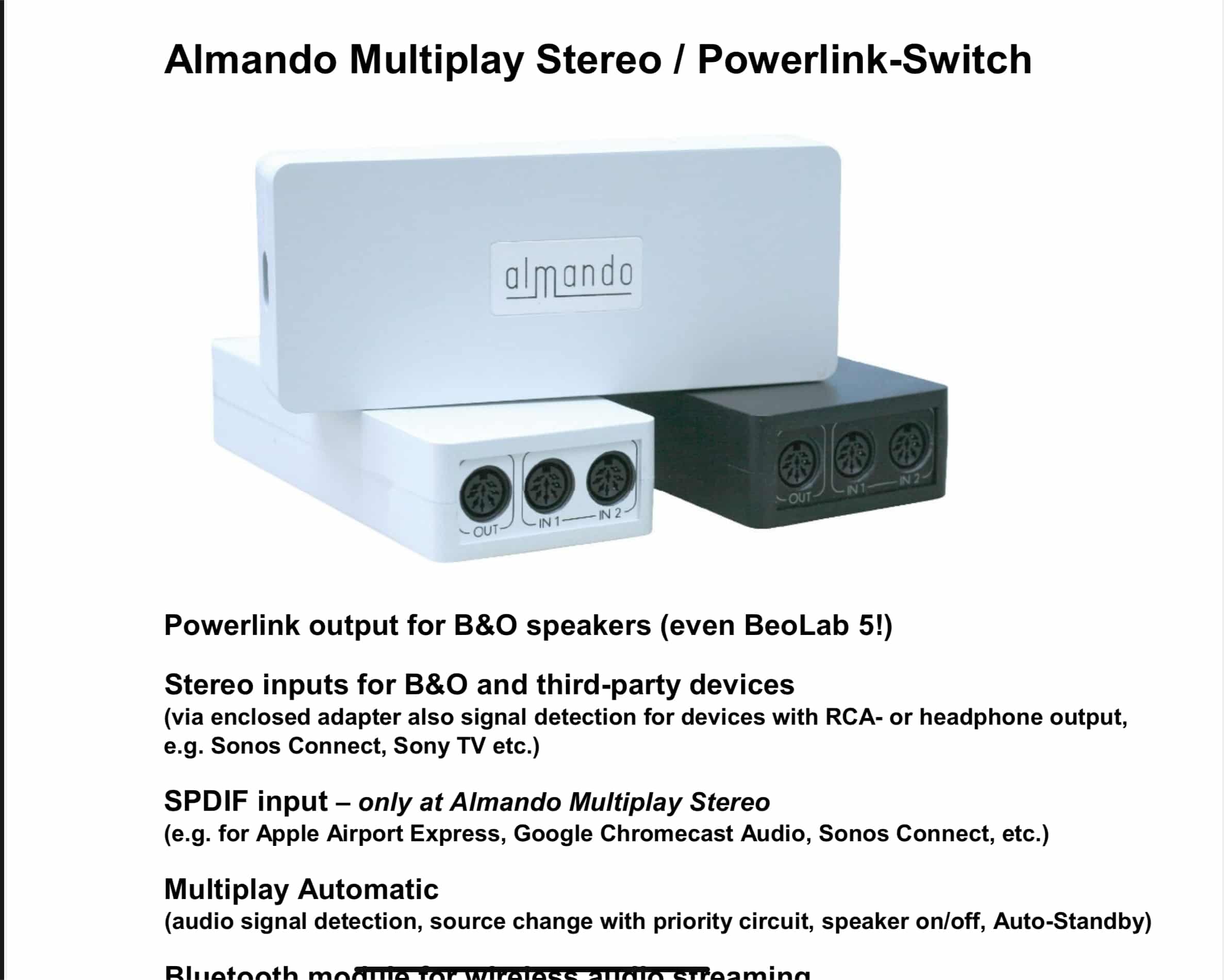

GOLD MemberI agree with guy that the two proposed solutions are the most user friendly options.A powerlink switch like this to enable two devices to share the speakers: https://shop.oneremote.dk/shop/69067-powerlink-switch/4162-powerlink-speaker-switch/
If you do not need multiroom features the powerlink switch might be the simplest of the two suggestions as it’s mostly plug and play. I would just like to mentions that there are other products like that. For example the brand Almando has similar solutions which can switch between even more inputs so you can add a music streamer like Sonos Port, Airport express, Chromecast Audio or whatever you wish. https://almando.com/Multiplay-Stereo-III_1
I do not have experience with the current version, but have an older one that has been working without issue for around 10 years now.
Location: Denmark
21 April 2025 at 21:18 #65266Paul Verbruggen
BRONZE MemberDear Guy and Madskip,
thank you for your feedback. When you mentioned the Almando I remembered that I do have such a device installed to connect my Apple Airplay to the BeoLab speakers. Since that is a SPIF connection I realised that I should have one PowerLink input port available. And so it was. I connected the BeoSound to the Almando and it works like a charm.

GOLD MemberGreat to hear that it was so relatively easy to solve the issue 😀
my Almando switch only have the 2 Powerlink inputs which is fine in my setup, but great that yours had an extra input
