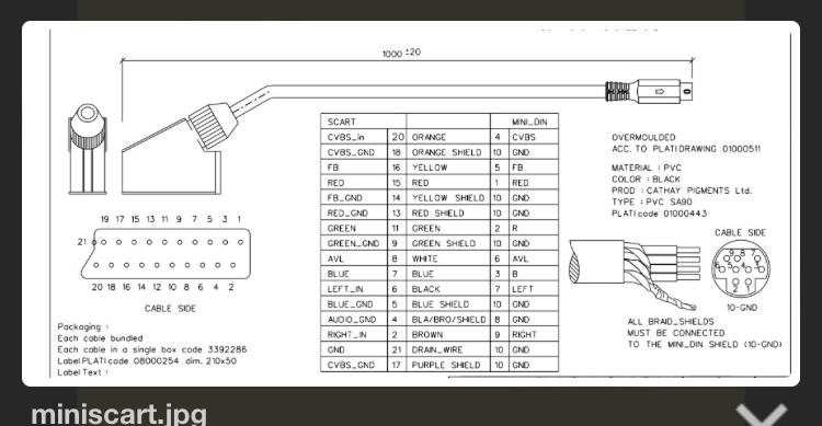

24 June 2023 at 09:38 #47343Madskp
GOLD Memberhello Steve
here is the cable drawing
It is indeed scart data from pin 8 to pin 6 in the mini Din and called AVL
