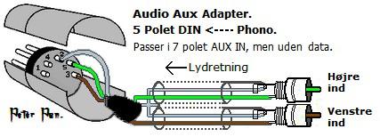

    Hello! I just visited your website and had a question. I have a beolab6000 connected to a Beosound Ouverture. I was trying to connect an external network adapter for AirPlay and Bluetooth. I bought a Wiim Mini, and a 7pin to rca cable. I connected the aux out on the wiim mini to the ouverture with the 7pin adapter and no sound comes out the speakers. If I try to put the Wiim directly on one of the speaker and set it on « Line » It works. Do you have any solution for me? I wanted to have everything connected through the beosound ouverture.

    You need to make sure that your DIN to RCA connector sends the input to pins 3&5 of the DIN connector.  Your lead is probably a DIN output using pins 1&4. (EDIT:  You don’t need a 7-pin DIN, a 5-pin DIN will work)
    The correct connections are as follows:
    2010-05-18_125944_Til_7_polet_DIN_IN_fra_RCA
    EDIT:  And make sure that you connect to the AUX input of the Ouverture and not one of the Powerlink sockets!
