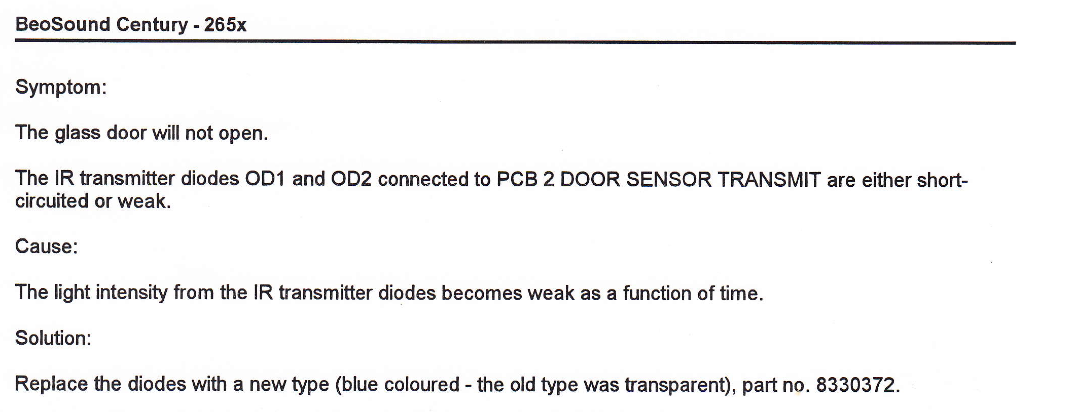

13 January 2024 at 15:43 #52111 Guy
ModeratorIn the Service Manual (avail on this site to Silver and Gold Members) there are two mentions of ‘fixes’ for problems with door sensitivity. One involves changing a single resistor, and the other changing the IR transmitter diodes. Sneak preview of the latter below:
