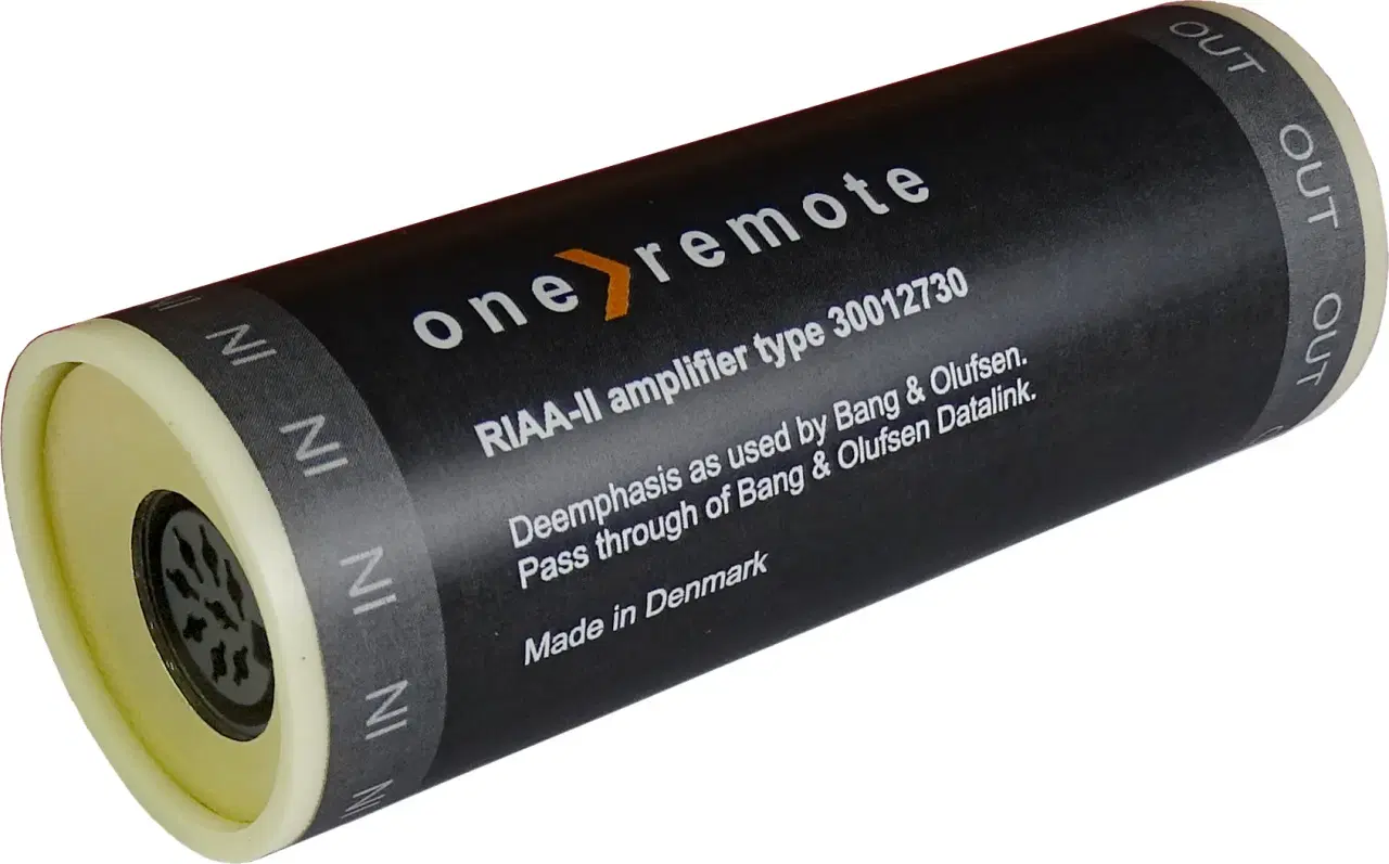

    Madskp
    GOLD Member
    An easy solution instead of making special cables could be the RIAA from Oneremote which also passes the datalink control signals
    https://shop.oneremote.dk/shop/69068-riaa-amplifier/121270-riaa-ii-preamplier/

    ^ Great solution @madskp  – I would buy that!
    I wasn’t aware of that, so perhaps it’s a new product.  I assume it swaps the datalink across from pin 6 to 7.
    I belive so.
