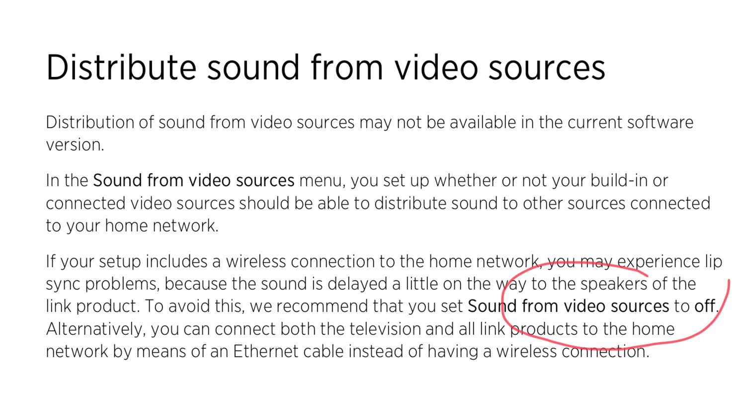

BRONZE MemberI have identified a very odd issue…
I am quite happy with my BV Horizon after various FW updates and modifications. I am using it with an ATV to watch movies.
I also have a NL system with Shape, BS1 and other connected. Some of them with attached Essence Remote.
Now my issue: When I watch TV and press “join” on my BS1 or other devices, nothing happens and the BV Horizon gets audio/video sync delay issues. What seems to happen is that it tries for he BV to join the BV audio stream, which as a result gets delayed to match.
Is there any way that I can take the BV Horizon out of the NL system? One idea is to just disconnect it from wifi (which I may not need), but I was thinking there may be easier/better and less destrutive ways to achieve this.
Any help appreciated!
1 January 2024 at 15:30 #51778 MillemisBRONZE MemberIs this setting ‘on’ or ‘off’?
3 January 2024 at 11:57 #51779steve1977
BRONZE MemberExcellent, thanks, this works.
