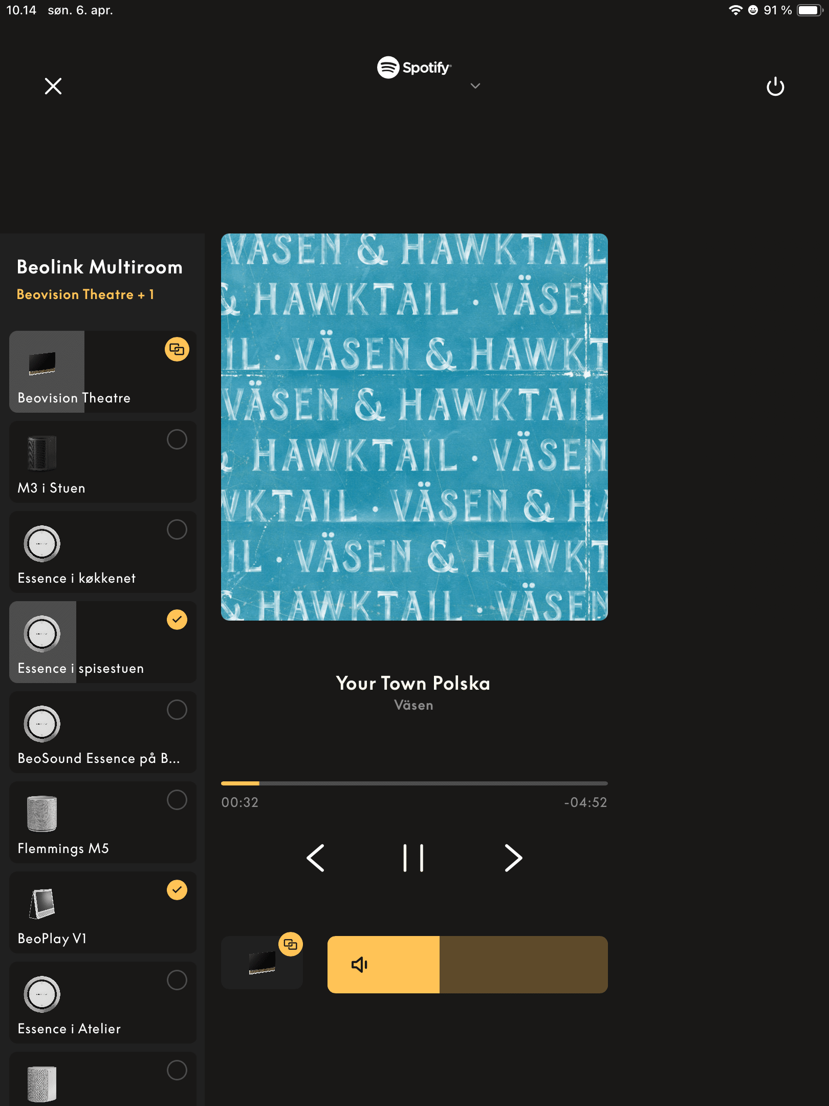

As a Spotify user (for the casual listening) I let the B&O multiroom solution/Beolink do the job, when I want to listen in multiple rooms – I can easily do that with Spotify Connect to one device and then expand to or join in other rooms.
Here is an example:
