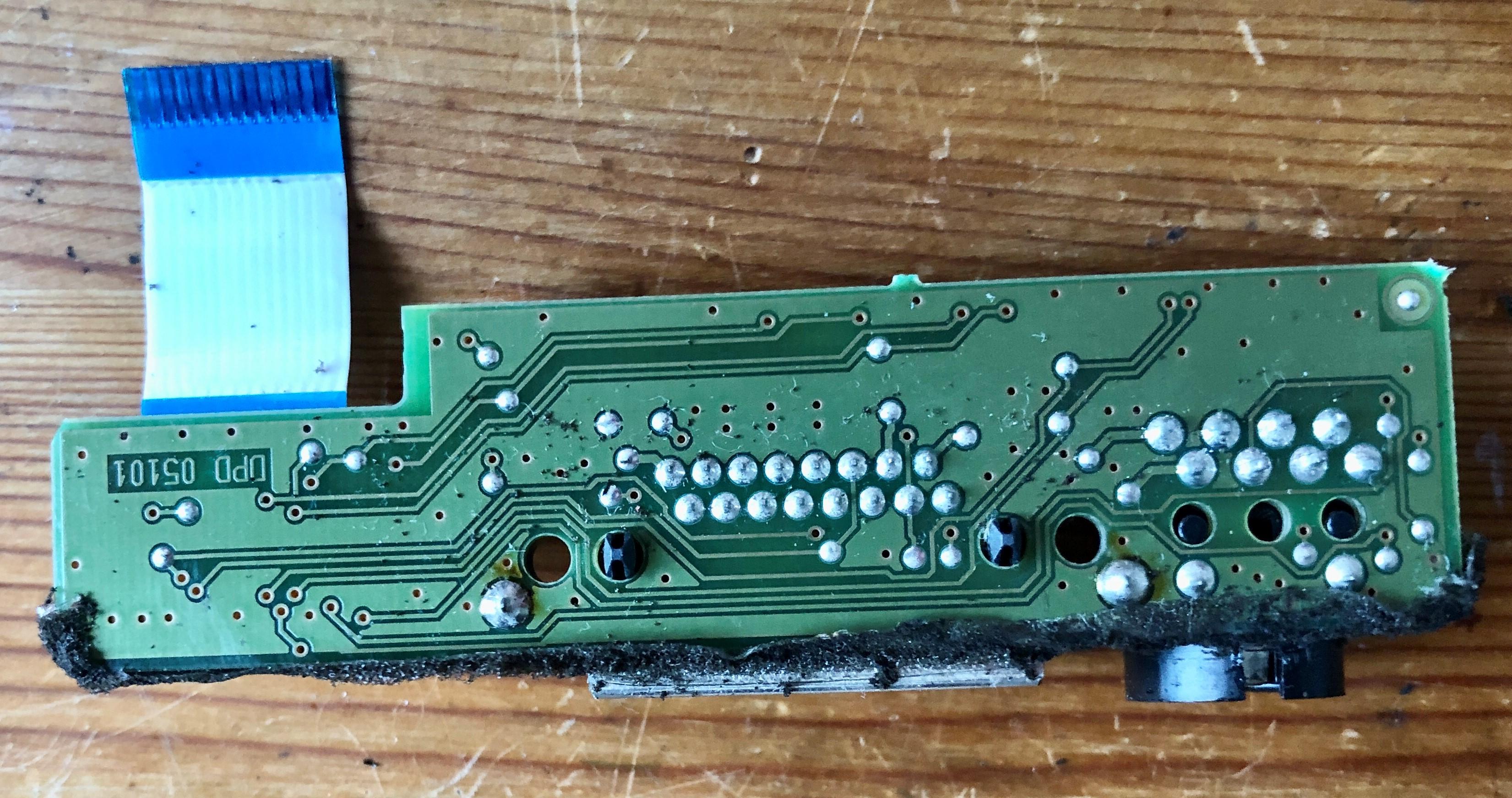

GOLD MemberOne odd thing I noticed when measuring voltages was that pin 1 on the BL W1 Powerlink connector was 12V which seems high, but the BL3500 MKII doesn’t seem to have anything connected to pin 1 so might not mean anything in relation to the BL3500
Just to be sure that PIN 1 in the powerlink connector is not used for turning the BL3500 MKII on I decided to disassemble the BL3500 so I could get full access to the plug PCB. I found out that most of the parts have to removed from the aluminum enclosure in one piece
From there I could unscrew the plug PCB.
There is no sign of connections from pin 1 of the DIN connector on the PCB. To verify further I also tried to do continuity test from pin 1 to all other connections, test points and vias on the PCB, and found no place with connction. So I’m about 99.9% sure that Pin 1 has nothing to do with activating the BL3500 MKII via Powerlink.
Location: Denmark

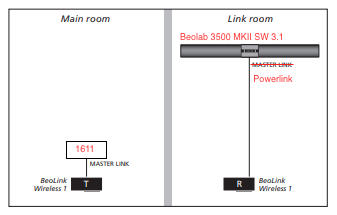

GOLD MemberSome aditionel testing with Bl3500 MKII and BL W1.
The same setup as before with the BL3500 and BL W1 connected via powerlink. In addition I also connected the BL3500 to Masterlink and set ML to on via the submenu Menu, 0, 9, GO to see the Behaviour.
In this case I cannot activate the BL3500 via the BL W1 powerlink conenction

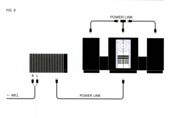

I you refer to what is shown in the Bl3500 user manual I haven’t tried that setup as I gues it will work and is a little outside the scope of this thread.
But to clarify the setup I tried I have modified the sketch from the user manual:
The Powerlink cable has to be fully wire for it to function as it needs both the normal powerlink on signal on pin 4, and the data signal that is on pin 6.
This setup works, but I can’t replicate it with powerlink outputs from BL active, MCL2AV or BS Ouverture, so the data signal from the W1 must be the key for this to work.
Location: Denmark

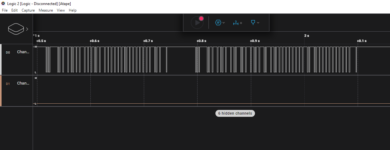

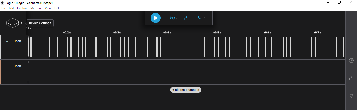

GOLD MemberNow I have a logic analyse and have tried connecting it up to the datalink pin 6 in the powerlink connection between the BW1 and the BL3500 MK2:
When activating the BL3500 MK2 via the BW1 with an ATAPE command I get this
Followed by this
Not that I am able to make sense of this command. But I have insted tried to compare it with the datasignal on pin 6 in a powerlink cable from a Beolink Active conencted to the BL3500 MK2
I can see that there are some differences in the structure of the first two parts of the signal, but also the part from the second picture from the BW1 data signal is not at all in the signal from the Beolink active, so clearly a different datasignal from the BW1 compared to a Beolink active
When presing standby with the BW1 connected to the BL3500MK2 I do not register any data at all. Probably the Bl3500 turn off because the powerlink on signal on pin 4 disappereas.

24 January 2024 at 17:41 #44607B3OHACK3R
BRONZE MemberNice and now we know what’s the difference between the BW1 and a normal PL output.
I see following in your BW1 capture (second screenshot equals the previous message):
0011 0001 1110 0111 1111 0000 0000 1001
0011 0011 0100 1100 1011 0000 0000 0101 0000 0000 0001which equals those hex values:
31 E7 F0 09
33 4C B0 05 00 1The Active kit sends the following:
0011 1011 1100 0000 0100 1000 0110 0100 0001 1000 1
0011 1011 1101 0001 0100 0000 0000 0000 0000 0000 1which equals those hex values:
77 80 90 C8 31
77 A2 80 00 01At least that “33 4C” data block I think I have seen before on AAL/MCL communication.
24 January 2024 at 17:43 #44608B3OHACK3R
BRONZE MemberAh, forget the last 1 bit on each message. It’s the stop bit (should be a little longer than a normal 1 bit)
24 January 2024 at 17:50 #44609Madskp

24 January 2024 at 22:34 #44613B3OHACK3R
BRONZE MemberAlthough I have a hard time figuring out how you interpetered all that data from my screenshots ?
If you know how the data is transmitted you can easily find out just by looking at it.
Data is determined by the spaces (signal at 5V) between pulses (signal at 0V).There are a few different space timings possible:
3.125 ms = logic 0
6.250 ms = “repeat” – same bit value as before
9.375 ms = logic 1
12.500 ms = start bit
15.625 ms = stop bitThe three pulses in the beginning can be ignored. Then there is the long start bit and afterwards you can start interpreting the data.

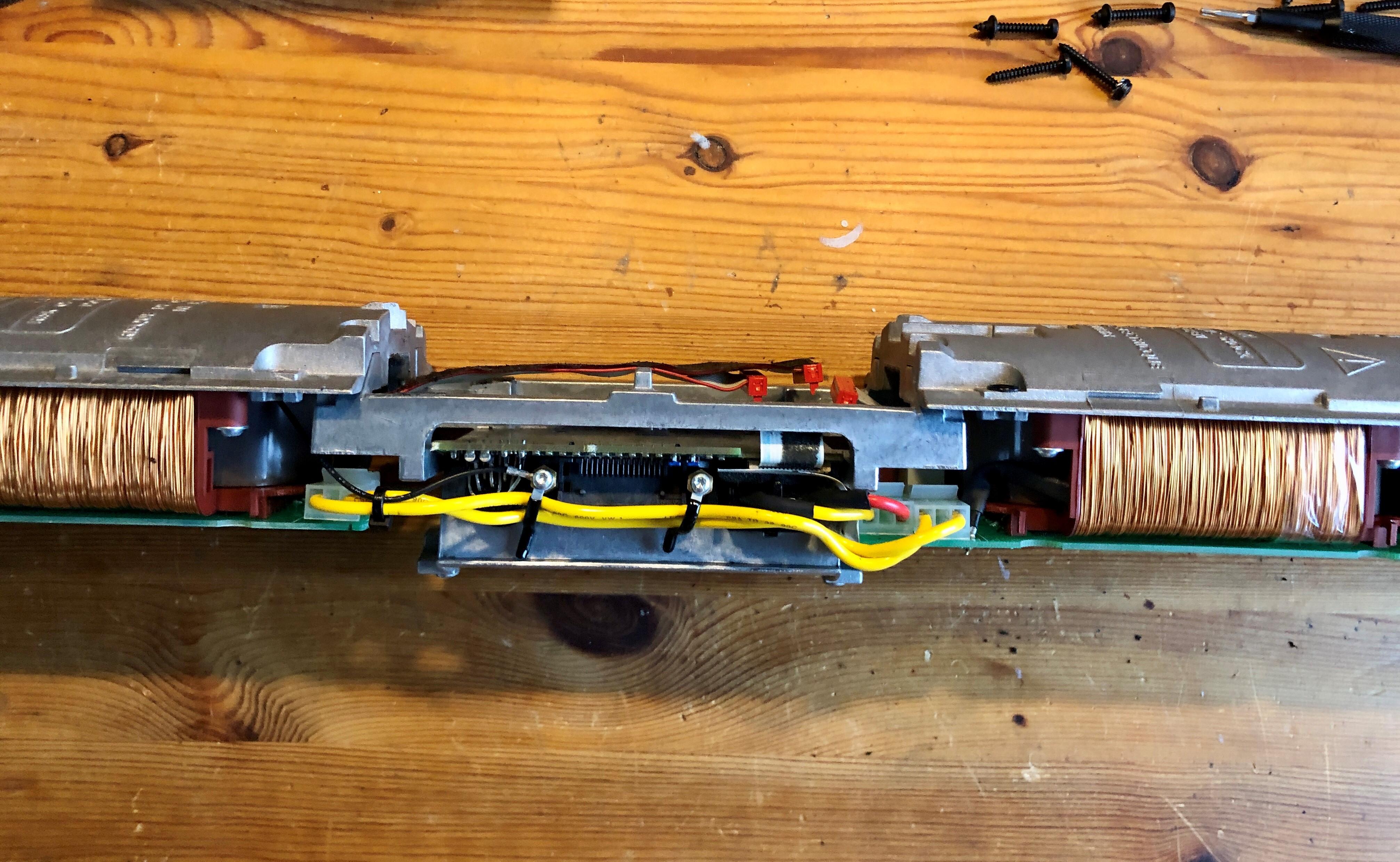

GOLD MemberEarlier on i this thread i did some testing where I connected the Beolab 3500 MK1 MCL connector on some of the products I had then.
I managed to do some control of a Beocord 3500 connected to a MCL2AV by controlling it from the Beolab 3500 IR eye.
However using the powerlink connection on my Beocenter 6 to connect to the Beolab 3500 I was not able to do anything
Since then I have got some more B&O stuff and have now tried to connect the Beolab 3500 MK1 to the powerlink connections on Both a Beomaster 4500 and a Beocenter 9300.
The cable for this connection is wired like this:
Powerlink pin 2 – > BL3500 pin 3, 5 and 7
Powerlink pin 3 – > BL3500 pin 1
Powerlink pin 5 – > BL3500 pin 4
Powerlink pin 6 – > BL3500 pin 6
In both cases I was able to control the sources on the Beomaster and the Beocenter, and the Beolab 3500 display was showing the source that was playing. When i blocked the IR eyes on the Beomaster and the Beocenter they would start up in a muted state like when the are controlled from a link room.
This setup more or less corosponds to the setup where a Beolink passive / ML-MCL converter is used to convert powerlink to MCL.
This explains why this works. In this case however the amplifier is not nessecary as the BL3500 is an active speaker.
Location: Denmark
