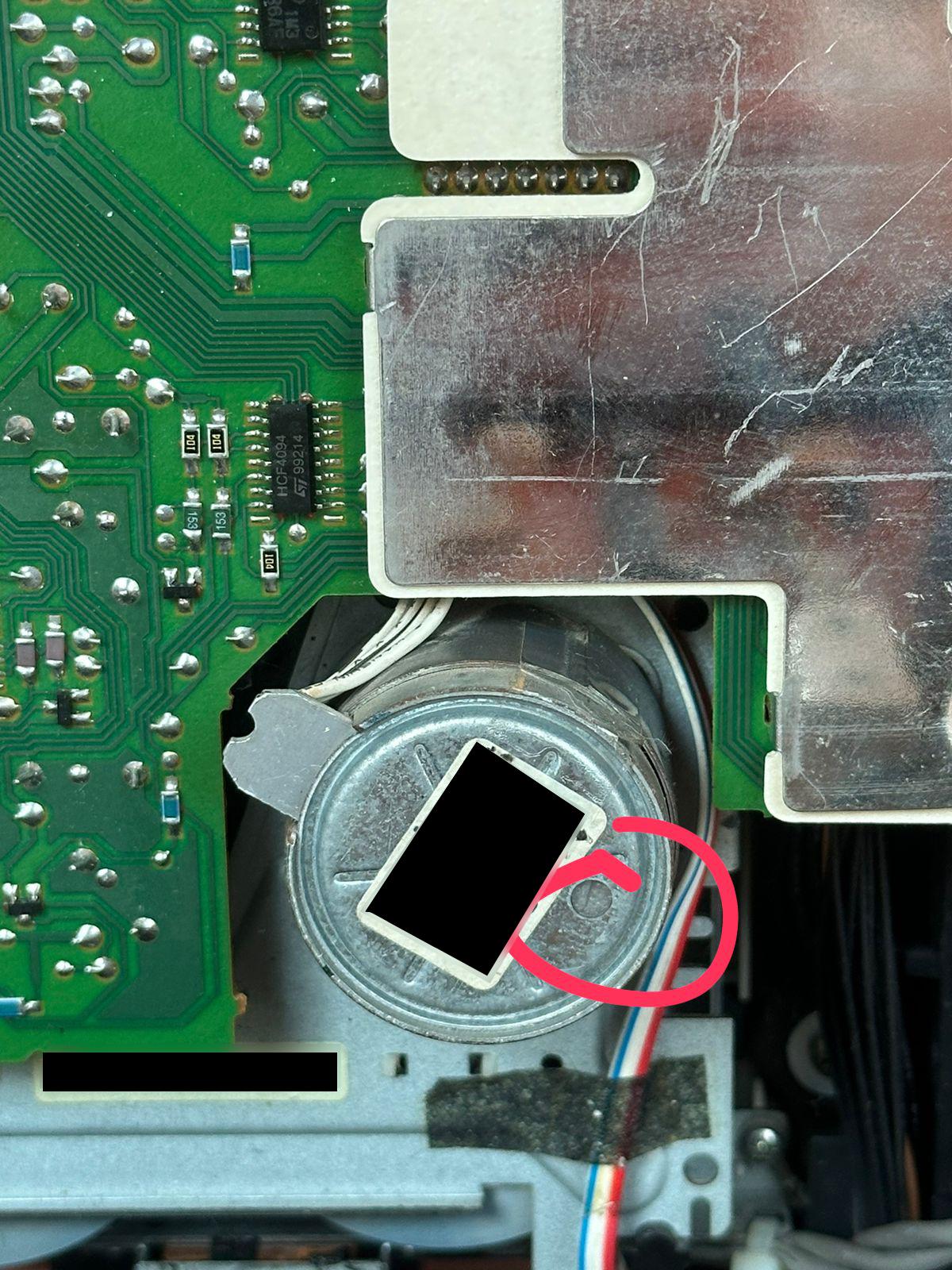

At first glace, the sound system is in fantastic condition. It looks almost brand new and the sound is beautiful.However, I did notice that the cassette deck plays my tapes fast. I did some comparisons and it plays about 10% faster. The CD player and the speakers are fine though. I decided to open the back panel to identify the motor.
Can anyone please confirm that this is the correct place to adjust the speed? (picture attached at the bottom)

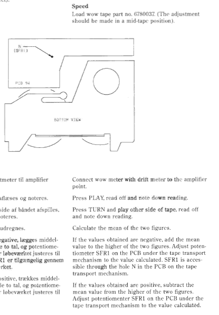

Firstly, do you have the service manual? This is available on this site to Silver and Gold members.
Here’s a snippet from the manual regarding tape speed adjustment:

I am assuming that I will have to also have to disassemble the large green circuit board covering most of the back panel to access the SFR1.
Can you please confirm if I can use a ceramic flat screwhead on the SFR1?
I don’t understand the manual’s text regarding “adjustment should be made in a mid-tape position”. Would it suffice to just play the calibration tape and measure the sound on an app that reads frequencies like the Spectroid app and make these adjustments rather than using a wow/drift meter?The door belts are apparently new so I guess I will have to clean and lubricate the runners and see if that solves it. What lubricant is recommended and is it also sold here?

11 September 2024 at 12:31 #59002 GuyModeratorI am assuming that I will have to also have to disassemble the large green circuit board covering most of the back panel to access the SFR1.
I would assume so. Have a look at this excellent thread from matador – your will have to click on the photos attached to each post. I think that you can see the hole through which SFR1 is accessed in IMG_2798.
I am not sure what tools to use for adjustment but avoid distorting figures by grounding through your body – don’t hold metal screwdriver directly.
