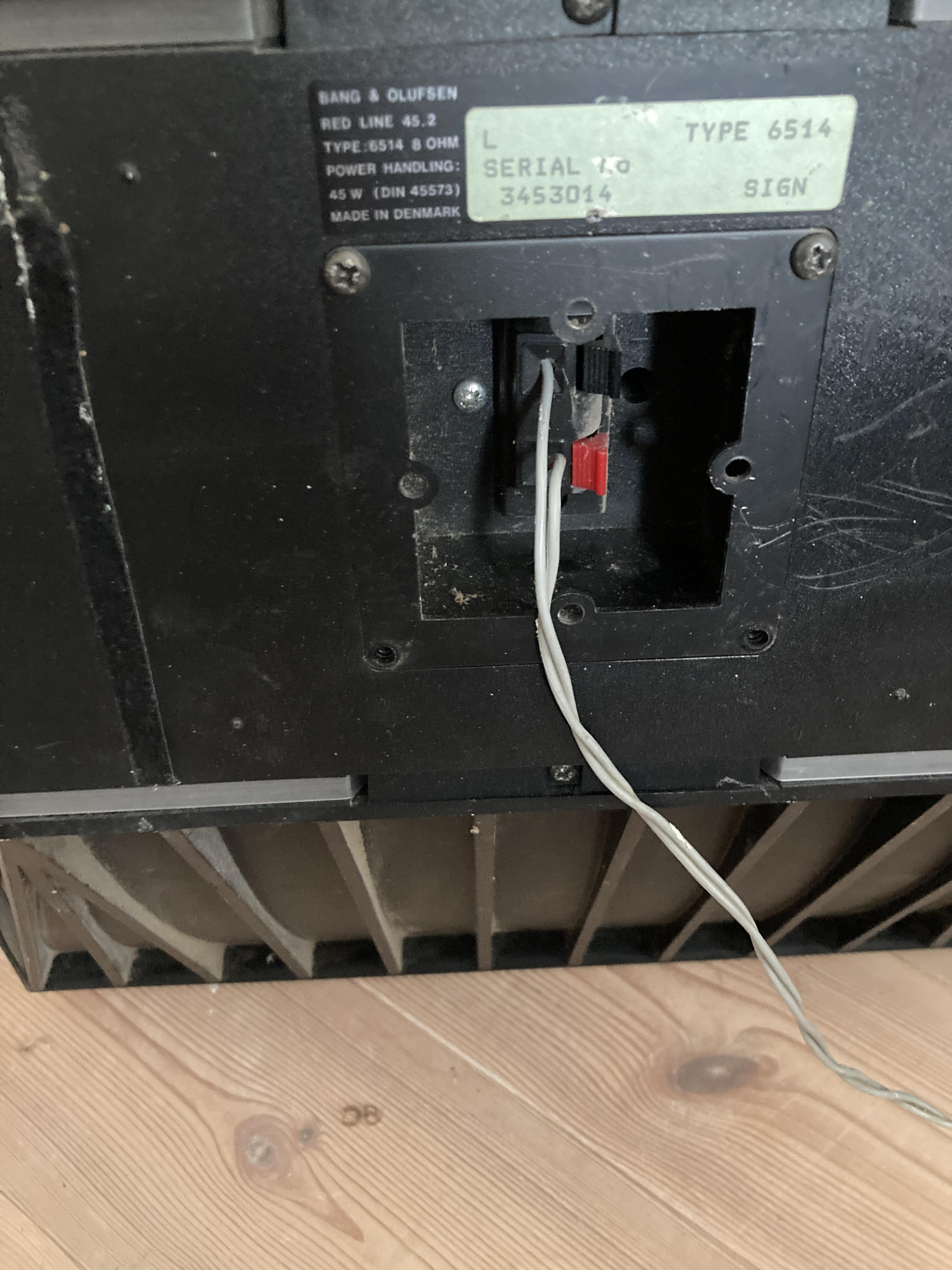

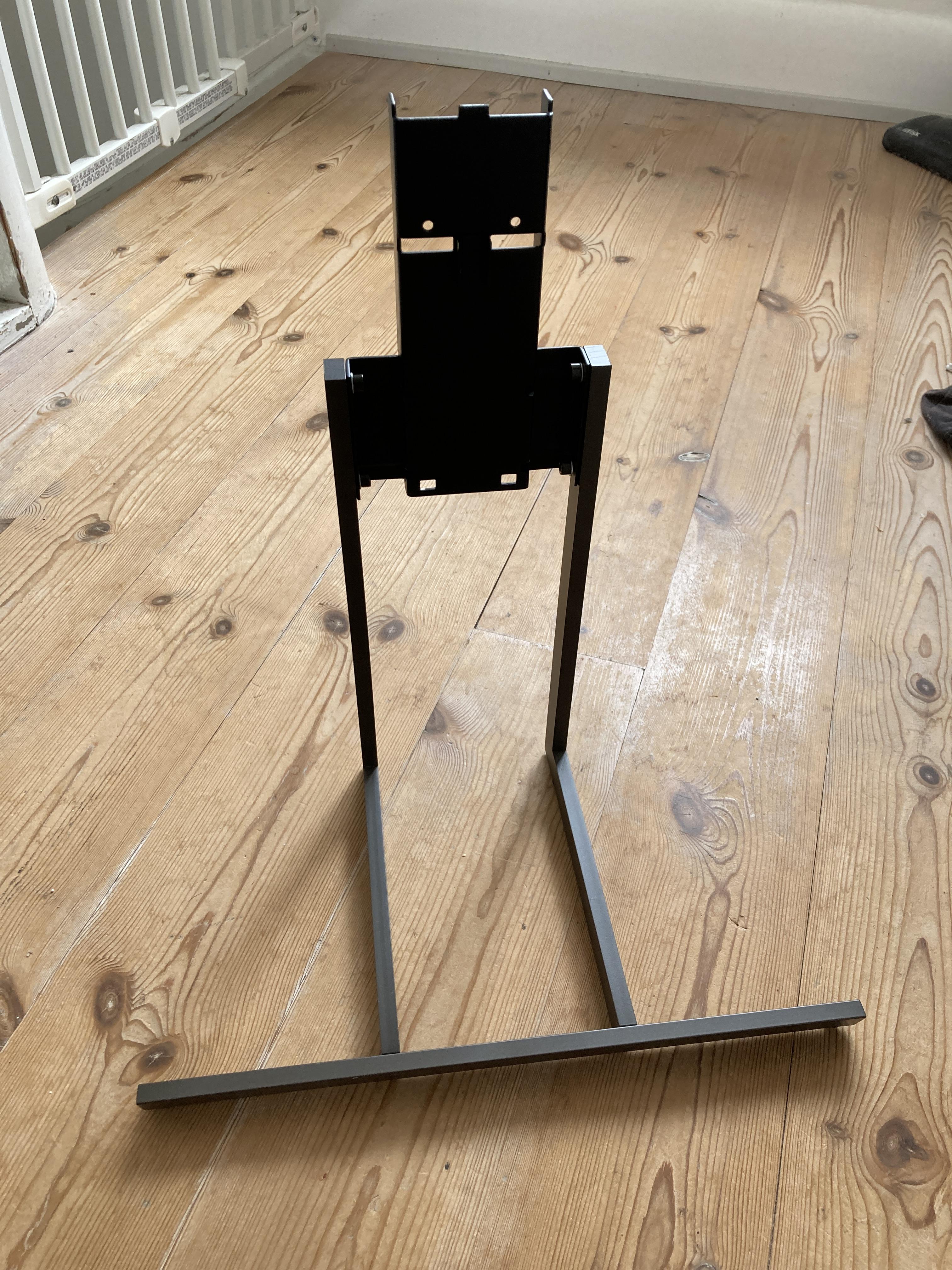

GOLD MemberI have a set of RL45.2 speakers that I want to mount on floor stands.
Recently I was able to pick up a set of floor stands in original packing labeled RL60.
I was under the impression that they would be compatible with my RL45.2 speakers, but now that I have assebled one of the I have a hard time figuring out how to mount the speaker on the stand
Tha stand look like this:
The back of the speaker like this

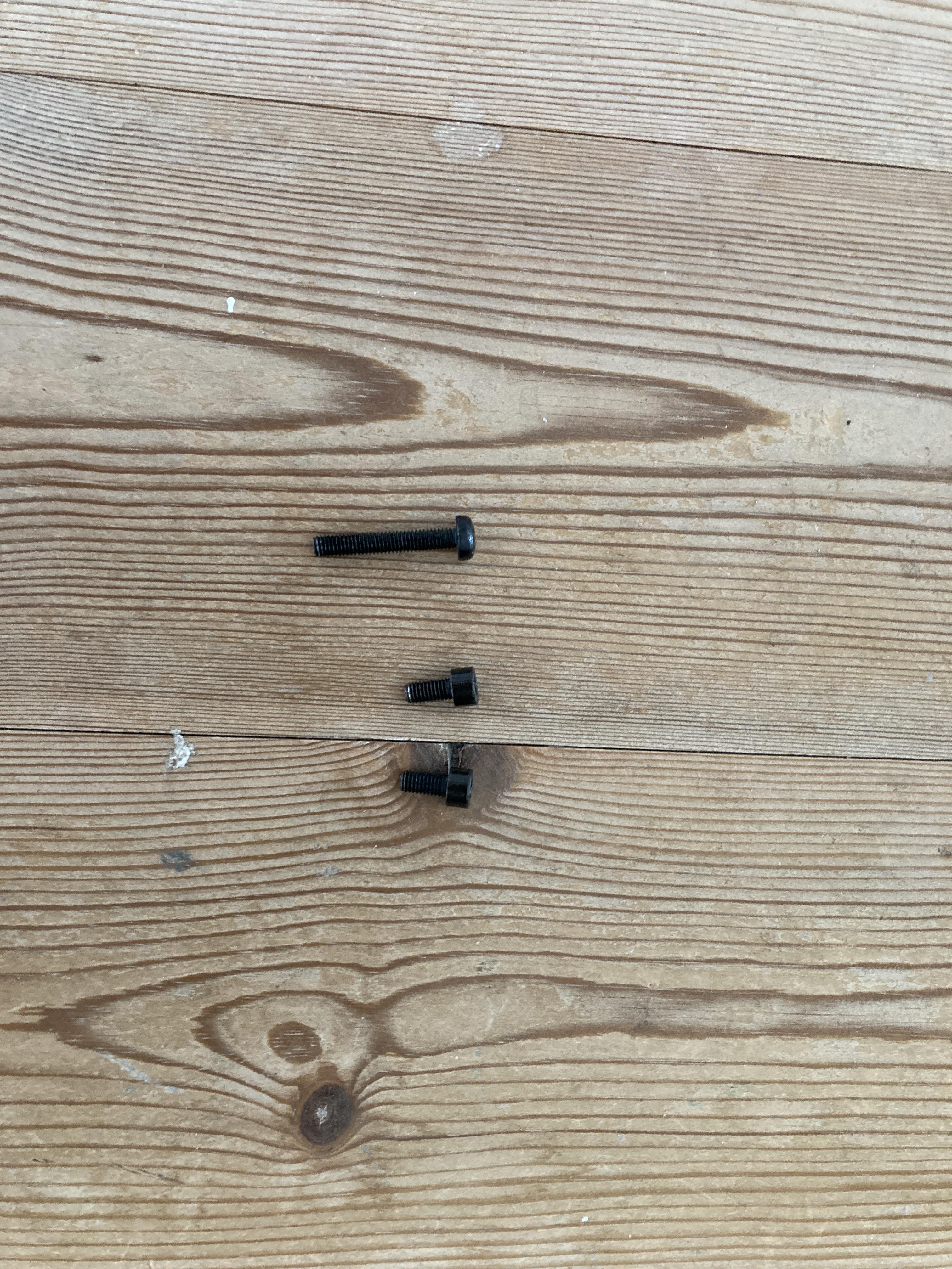

This is the parts I have left.
I know from some old thread that the long screw has to go into one of the holes in the back of the speakers and is used to adjust the angle.
I guees the two others are for mounting the speaker on the stands, I just dont see any holes that line up
Am I missing something here either parts or knowledge? Or is this compatible at all?

18 August 2024 at 17:39 #58422Madskp
GOLD MemberIf I am not mistaken I might be missing a bracket like this https://www.ebay.com/itm/186461396559?_trkparms=amclksrc%3DITM%26aid%3D777008%26algo%3DPERSONAL.TOPIC%26ao%3D1%26asc%3D20230811123856%26meid%3Db10fa3817a36410aa94b3387d3b3e8ce%26pid%3D101770%26rk%3D1%26rkt%3D1%26itm%3D186461396559%26pmt%3D0%26noa%3D1%26pg%3D4375194%26algv%3DRecentlyViewedItemsV2WithMLRV6RankerPricelessTop30Features%26brand%3DBang%2B%2526%2BOlufsen&_trksid=p4375194.c101770.m146925&_trkparms=parentrq%3A664442eb1910ac1d39a6dfacfffed426%7Cpageci%3Ade06a5c7-5d7c-11ef-9318-2250449e11a6%7Ciid%3A1%7Cvlpname%3Avlp_homepage to mount the speakers on the stand.
Can anyone confirm this is correct?
Thanks in advance
Location: Denmark
18 August 2024 at 21:23 #58429 GuyModeratorCan anyone confirm this is correct?
That’s correct – you can see those brackets fitted in this listing: https://www.ebay.co.uk/itm/186599725335

19 August 2024 at 08:31 #58433 GuyModeratorUnless you can make some? Like the home-made ones in this listing: https://www.ebay.co.uk/itm/226262051072
Actually the same seller has those bits on offer (a bit pricey) as a ‘static wall mount’: https://www.quality-dream-audio.co.uk/stands-furniture-wall-mounts-and-clocks/redline-4560-static-wall-mount.html
(The official Redline ‘static wall mount’ was actually a two part bracket, with those bits attaching to a separate piece that was screwed to the wall.)
Location: Warwickshire, UK
19 August 2024 at 09:04 #58439 GuyModeratorYou might already have the redline manual – I have attached it anyway. (EDIT: Not sure why the quality is so poor when uploaded, I downloaded it from AVA Services here: https://www.avaservices.co.uk/downloads/speakers.html)
Page 4 picture 6A does show the piece you are missing, and it is actually described as a standard wall bracket. The notes do refer to an extra piece that is used for light walls, so that must be the extra piece that I have used in the past.
So the piece that you are missing may well be described as a ‘Redline wall bracket’ in any sale listings!
