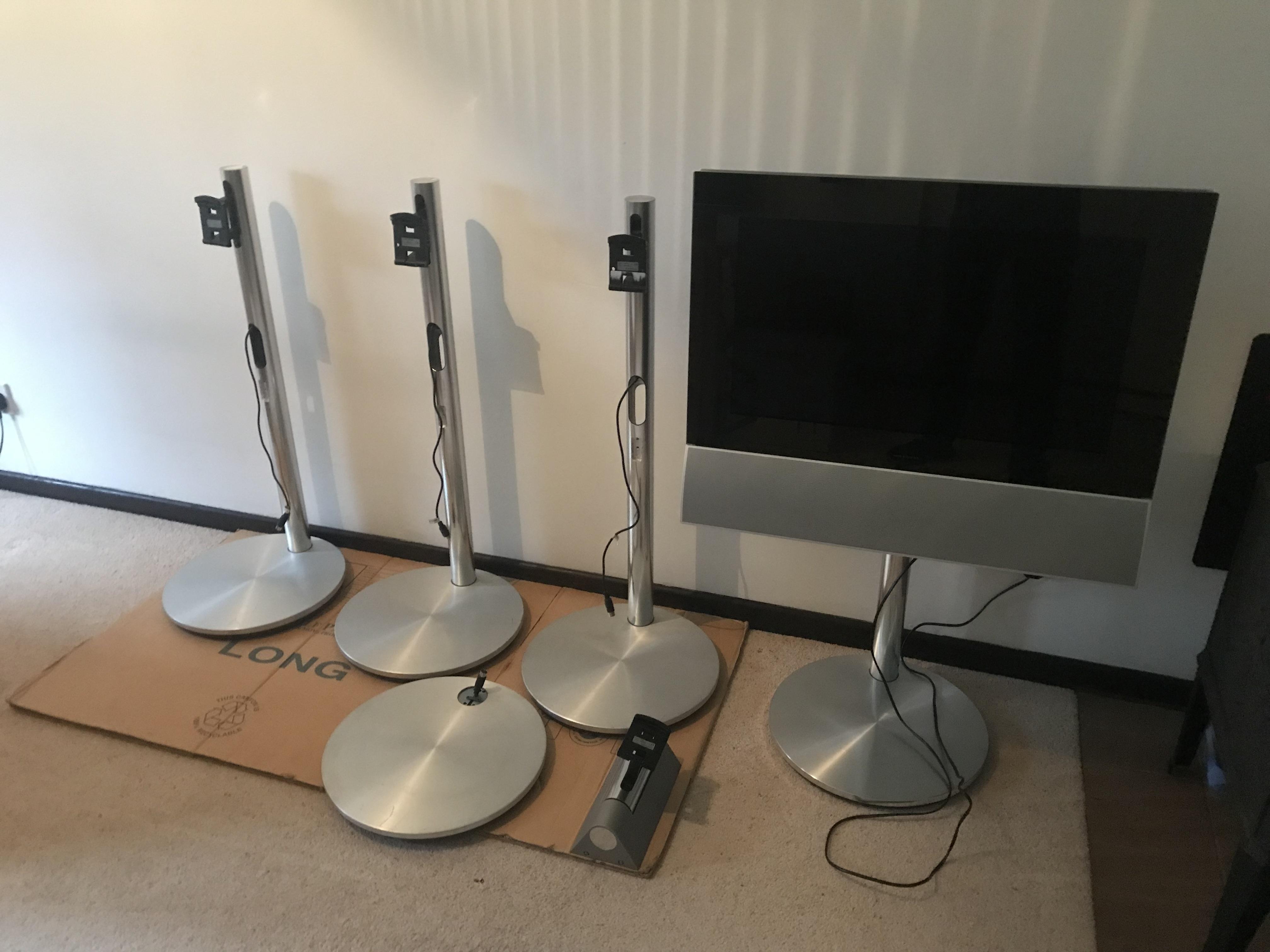

    The metal of the pole is a constant cross section and if I recall correctly there are four screws that go into the pole from the base vertically from below.  With a very neat (accurate) cut this should be very achievable.  I assume that you need somewhere between table stand and floor stand height?
    EDIT2:  I think (not 100% sure) that the screws are self-tappers hence no need to make a new internal thread in the pole.
    EDIT: Zoom in on the one that is missing its pole and you will see the screw holes:

    When upside down you will see an opening (hole), possibly covered by a sticker. Rotate the stand on its base until the hole lines up with the pole and you will see the four screws. As you can see in my photo, there is usually a DIN connecter within the pole to lengthen the motor control cable for the floor stands.
    My photo was from a job lots of 5 stands (plus wall mount) that I bought from ‘cashconverters’ for about £40. The 5th stand was for a BV10-32 which was all I wanted, so I sold all the others, got a ‘free’ BV10 stand and made a small profit!

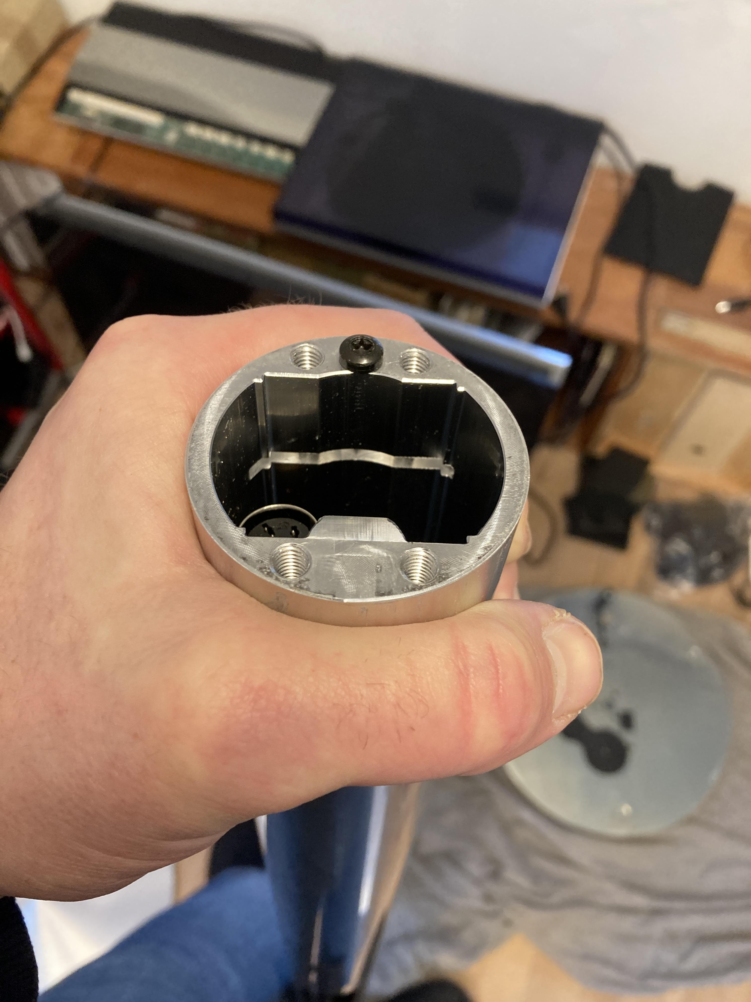

    Ok so I got it disassembled. Pretty easy when using your instructions.
    But I can see that even though the cross section is the same in the entire lenght of the pole the threaded holes is only about an inch deep and stops where a reces is cut into the cross section
    IMG_9657
    So in order to cut down the lenght of it new holes will have to be drilled and threaded at the place where it is cut.
    This would require some drilling equipment that I do not have, so I guess this will not be the way to go.
    The reason for investegating this option was that I have the stand and might as well use it if possible. However I might look into other placement options, and/or maybe the smaller BC6-23 as an option

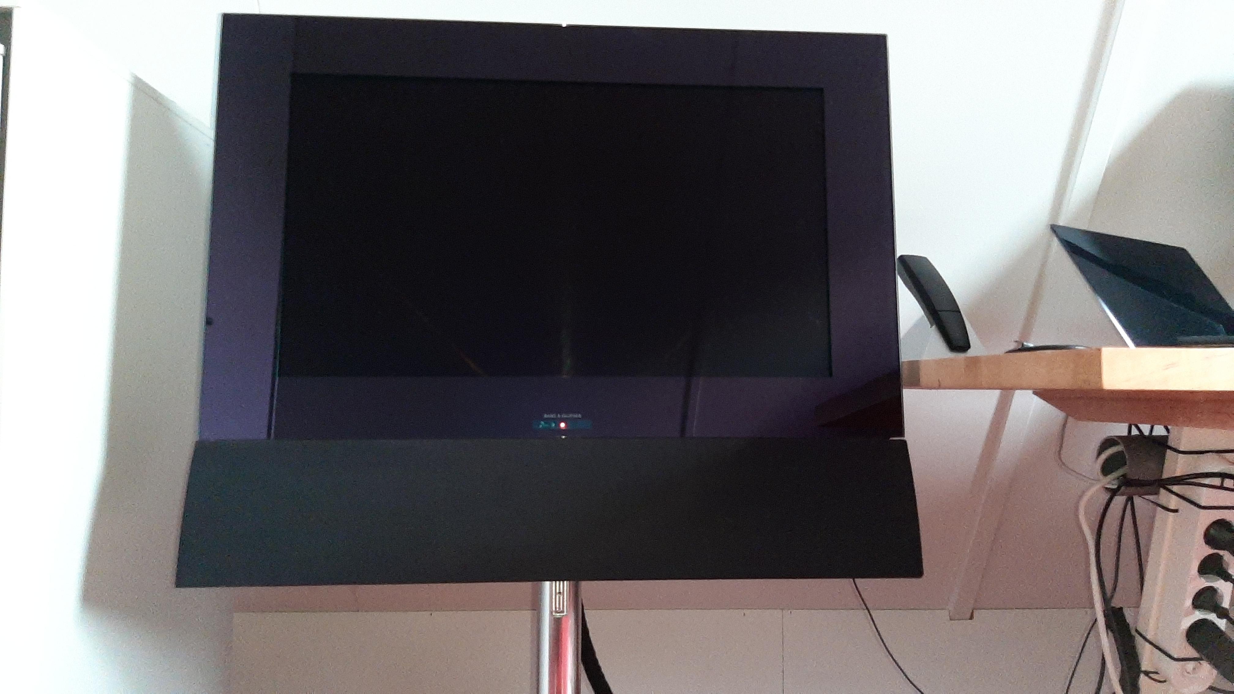

    Hi Madskp, hi Guy, the BC6-26 does just not cover the BeoLab bracket cavity. It is very unobtrusive though. See below image of my 6-26 on a BV7 motorized stand. I sat on the floor taking the picture.20240217_095058
    Hopr this helps, J.

    Hi Madskp, hi Guy, the BC6-26 does just not cover the BeoLab bracket cavity. It is very unobtrusive though. See below image of my 6-26 on a BV7 motorized stand. I sat on the floor taking the picture.20240217_095058 Hopr this helps, J.
    Great picture to show this, thanks ?
    And I guess that on a table stand it would be even less noticable.
