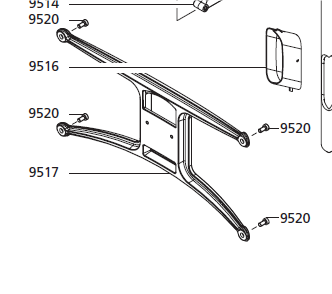

Is it possible to mount it to a Beovision 7-32 floor stand?
Possibly, but at the very least you’d need to fit the following BV10-40-specific part to the back of your TV before clipping it onto the BV7-32 stand interface. This would be as hard to find as the whole stand, and once on the BV7-32 it wouldn’t hang at the right angle because the geometry of the supporting bracket is wrong.
The TV is not designed to be leant against the wall, so do so at your own risk! I would be tempted to re-inforce the summerhouse wall with a large sheet of marine ply and use your wall mount.

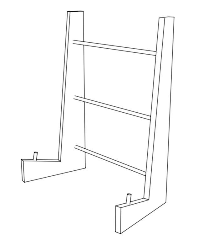

If you’re ready to put the TV on the floor, I would suggest do make a simple easel stand made of wood cut in shape like the stands to display platters.
Something like this more or less:
If you like the BV on a stand, then I believe the back of the set is flat, right? You could bolt any piece pf wood or sheet of thick metal and the bolt on that sheet any Vesa clamp to accomodate any stand you like.
Alternatively, the original easel stand should not be that hard to replicate: I don’t know how the front feet go into the set but if they are screwed it should be easy to made them DIY and for the back leg, see above.
