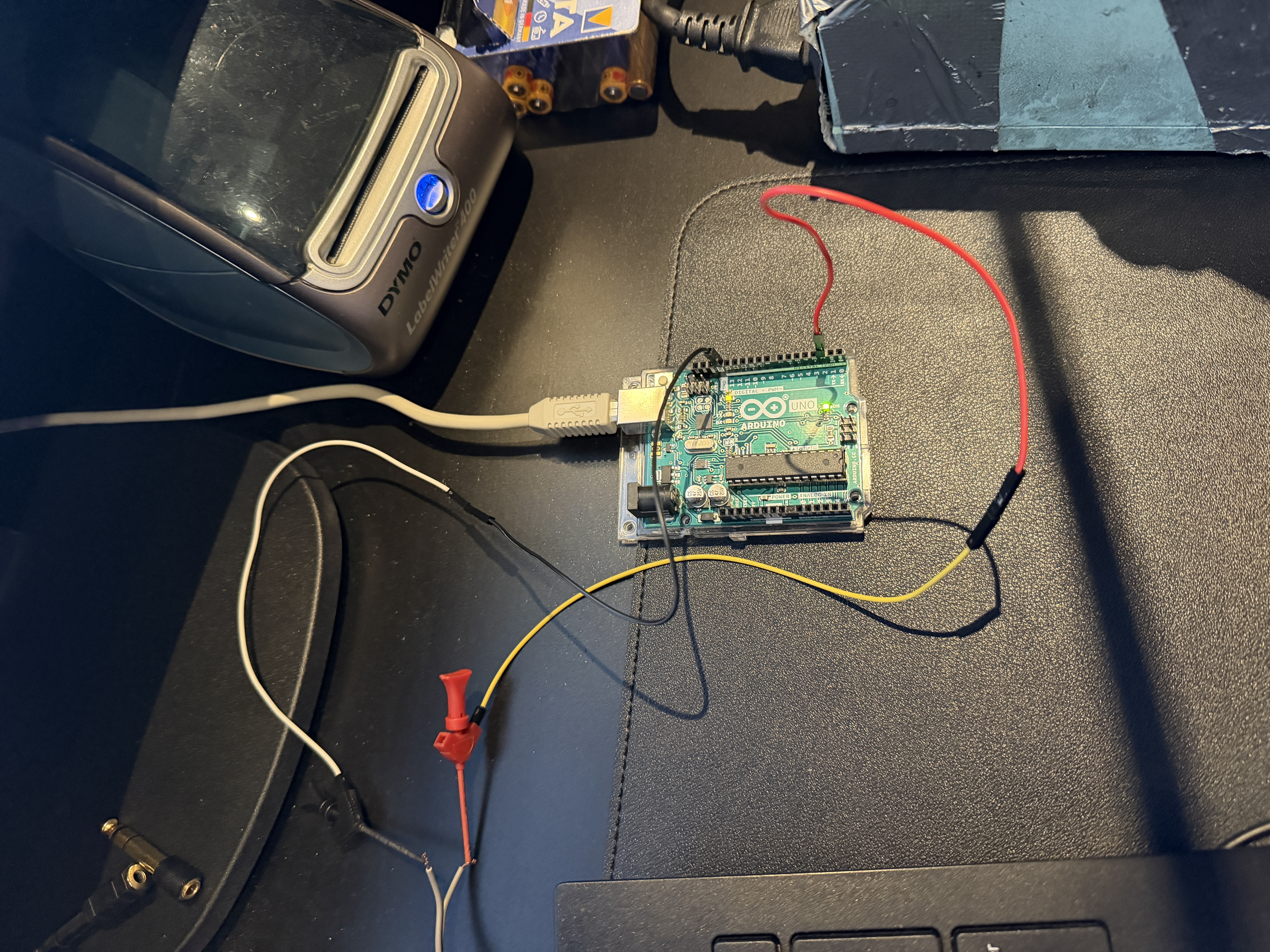

1 February 2026 at 20:05 #73061 type81BRONZE MemberFirst things first. How to listen to a Beomaster datalink? I didn’t have a clue.
But happily you are rarely the first one to try and find something out.
So a search on the internet pointed me to a project on Github.
GitHub – toresbe/datalink: B&O datalink reverse engineering effortThis project analyses the Datalink port with an Arduino. Just what I needed.
A microcontroller which can control the system on the lowest level, and listen to the commands from “the boss”
In my case I use the BL80 analyzer as starting point.
A tape device on this ecosystem talks with the older BL80 standard, an AUX device talks over the more advanced BL86 standard.
I want the Beomaster to think the device is a “Tape 2” device. So I can use the more basic BL80 standard.

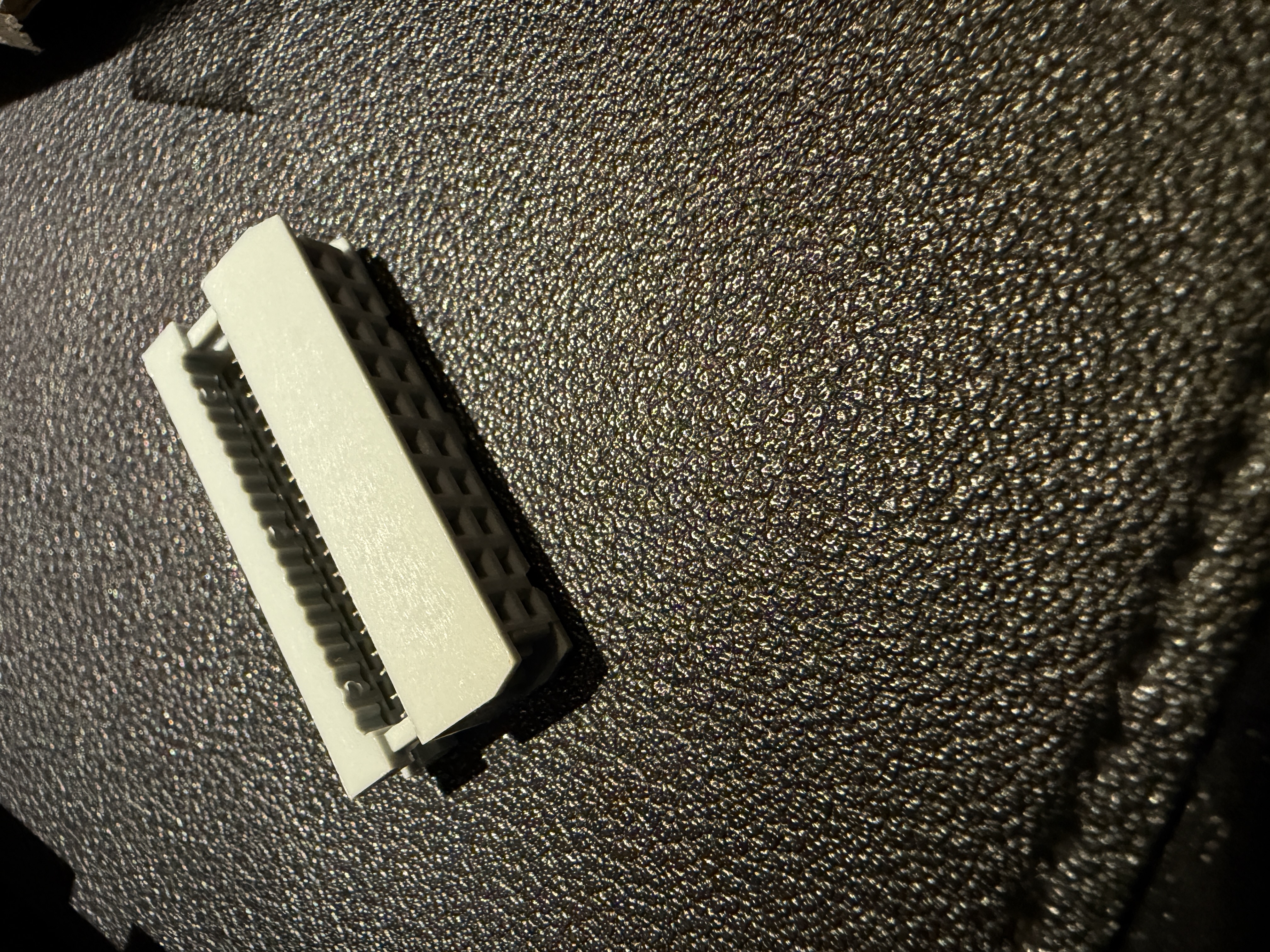

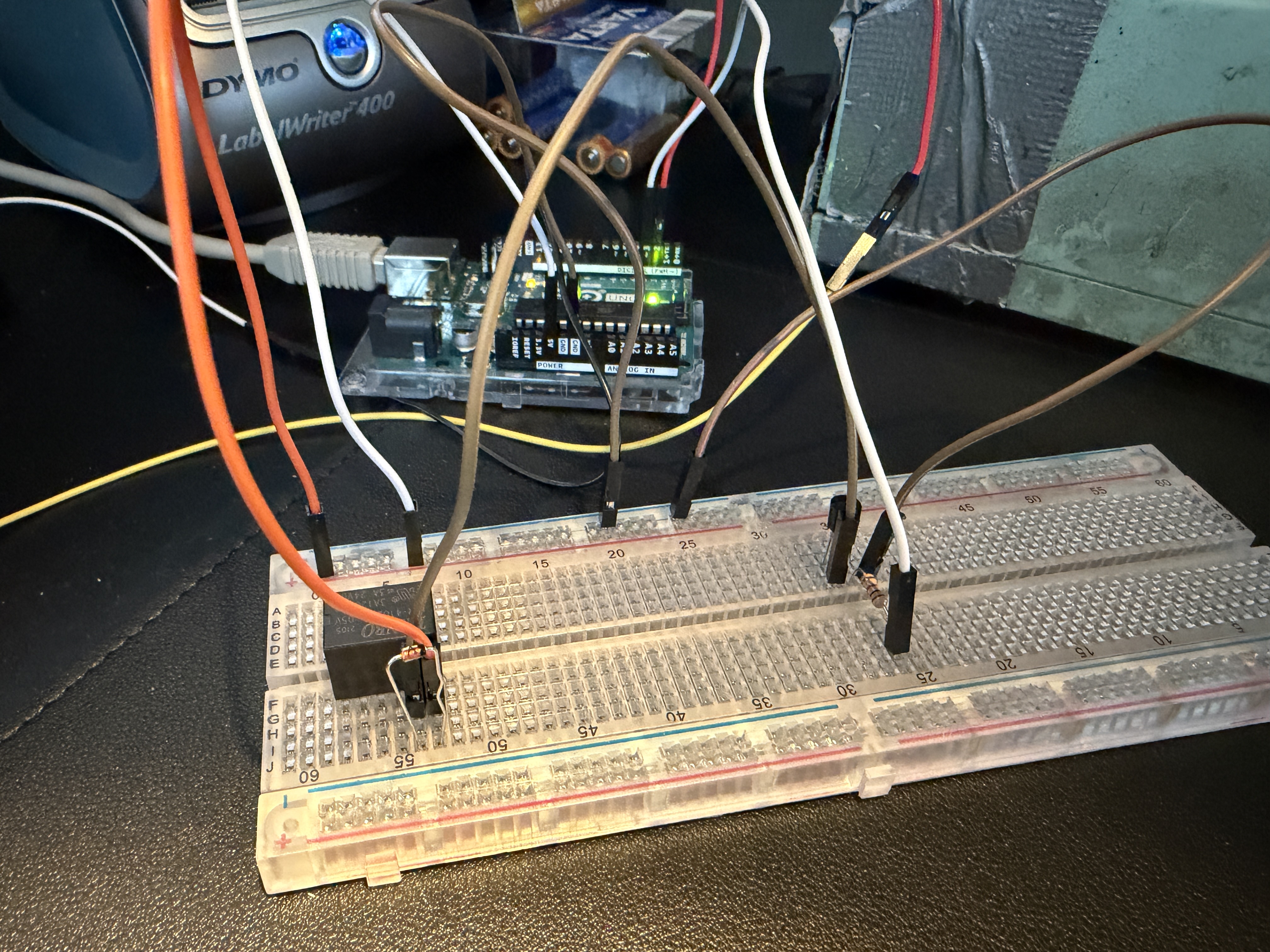

Let’s try. My good old Beomaster 5500 which I use for tests like this will be the test candidate.A 7 pin DIN connnector with 2 wires soldered on pin 2 -> ground and pin 7 -> datalink which will be connected to the Arduino.
Location: Netherlands

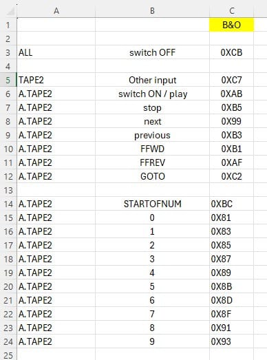

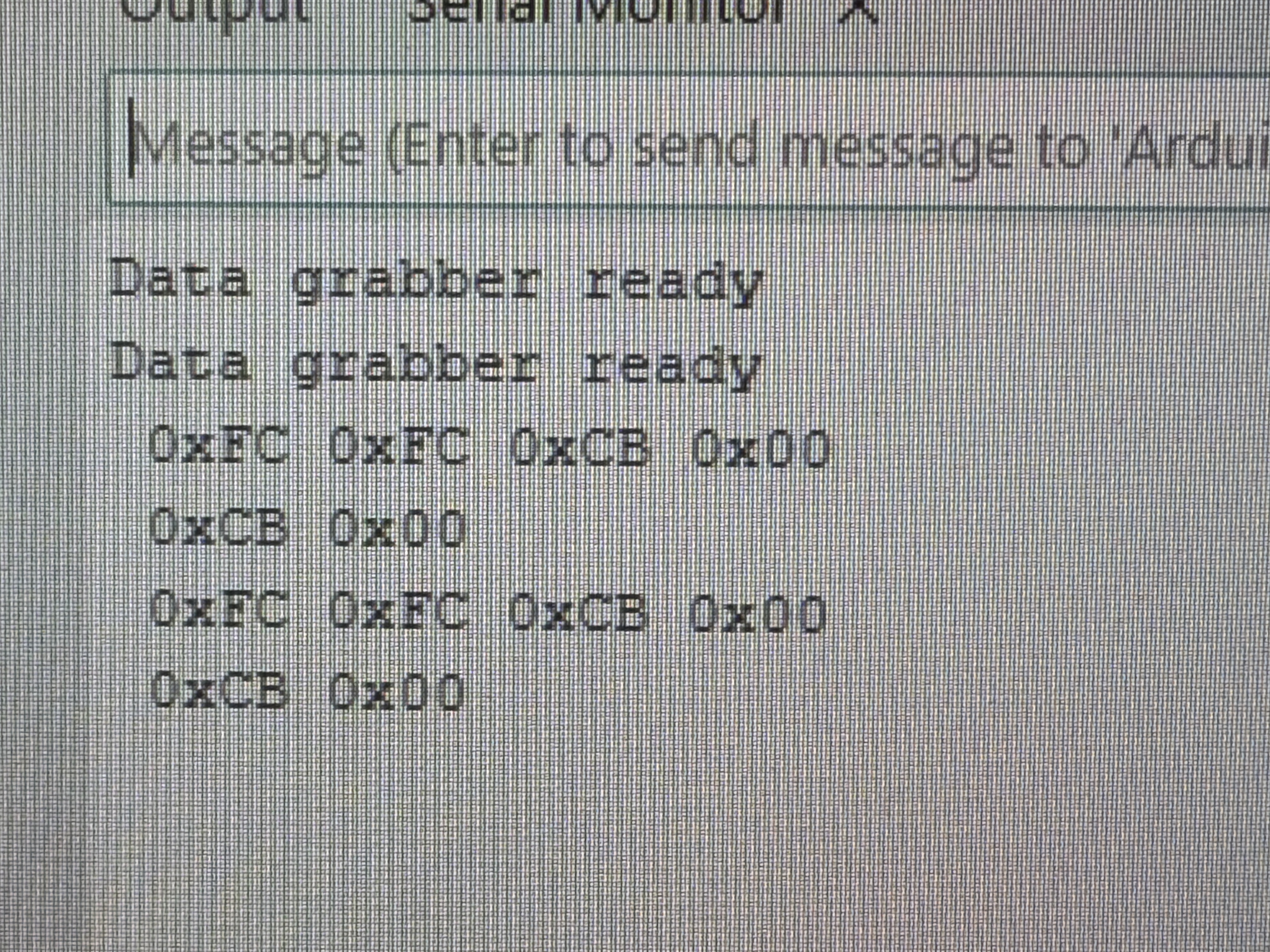

1 February 2026 at 20:17 #73064 type81BRONZE MemberAfter a lot of testing with the remote control, the codes were making sense to me so I created a little sheet with the commands I am interested in.
Now that I understand what the codes mean, I can try to do something with the received commands from the Beomaster.Let’s try to switch a relay as soon as we get code 0xAB.
I need it to power on the Raspberry Pi with the Volumio streamer when we switch the input to Tape 2 on the Beomaster.Location: Netherlands

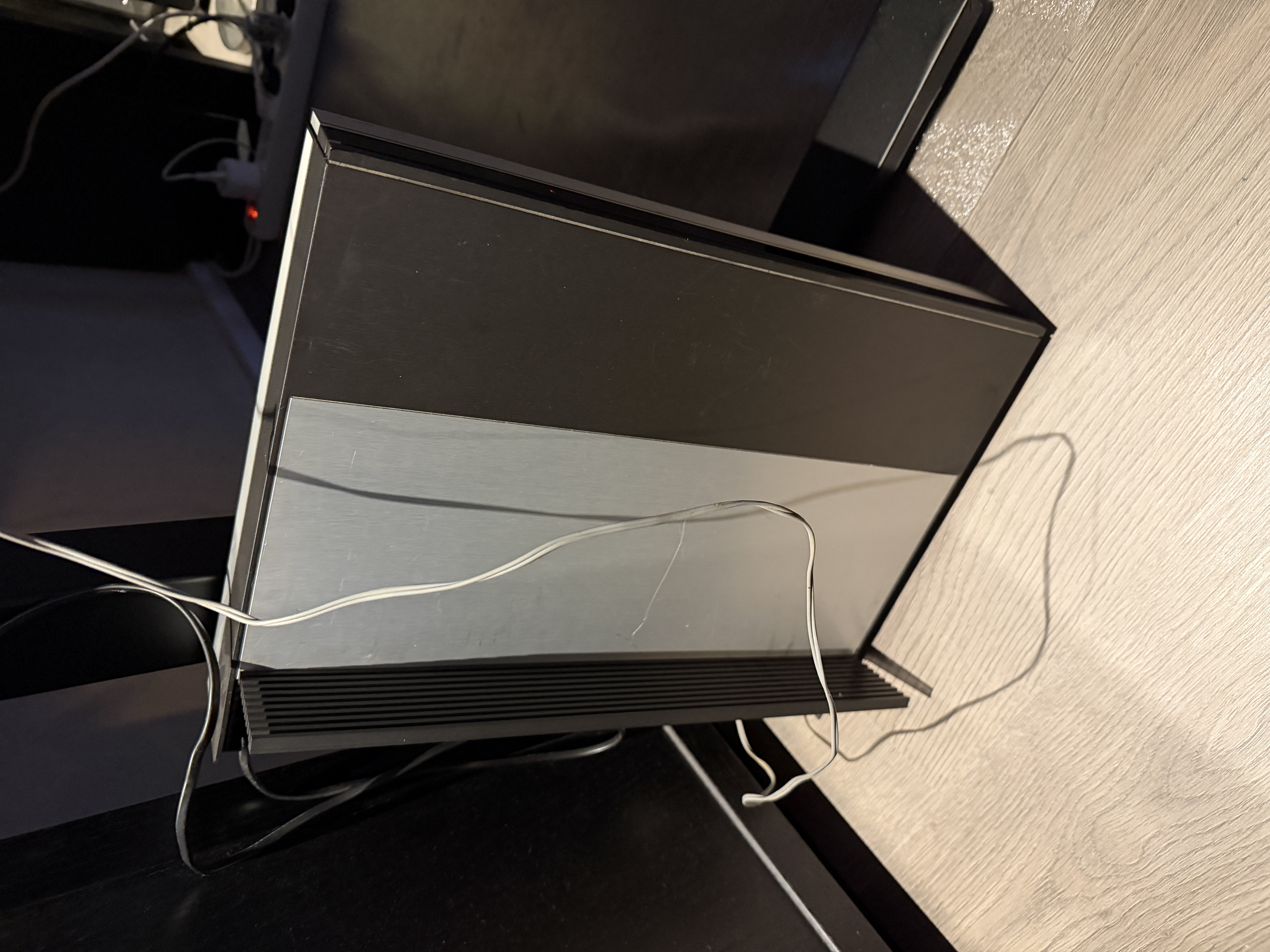

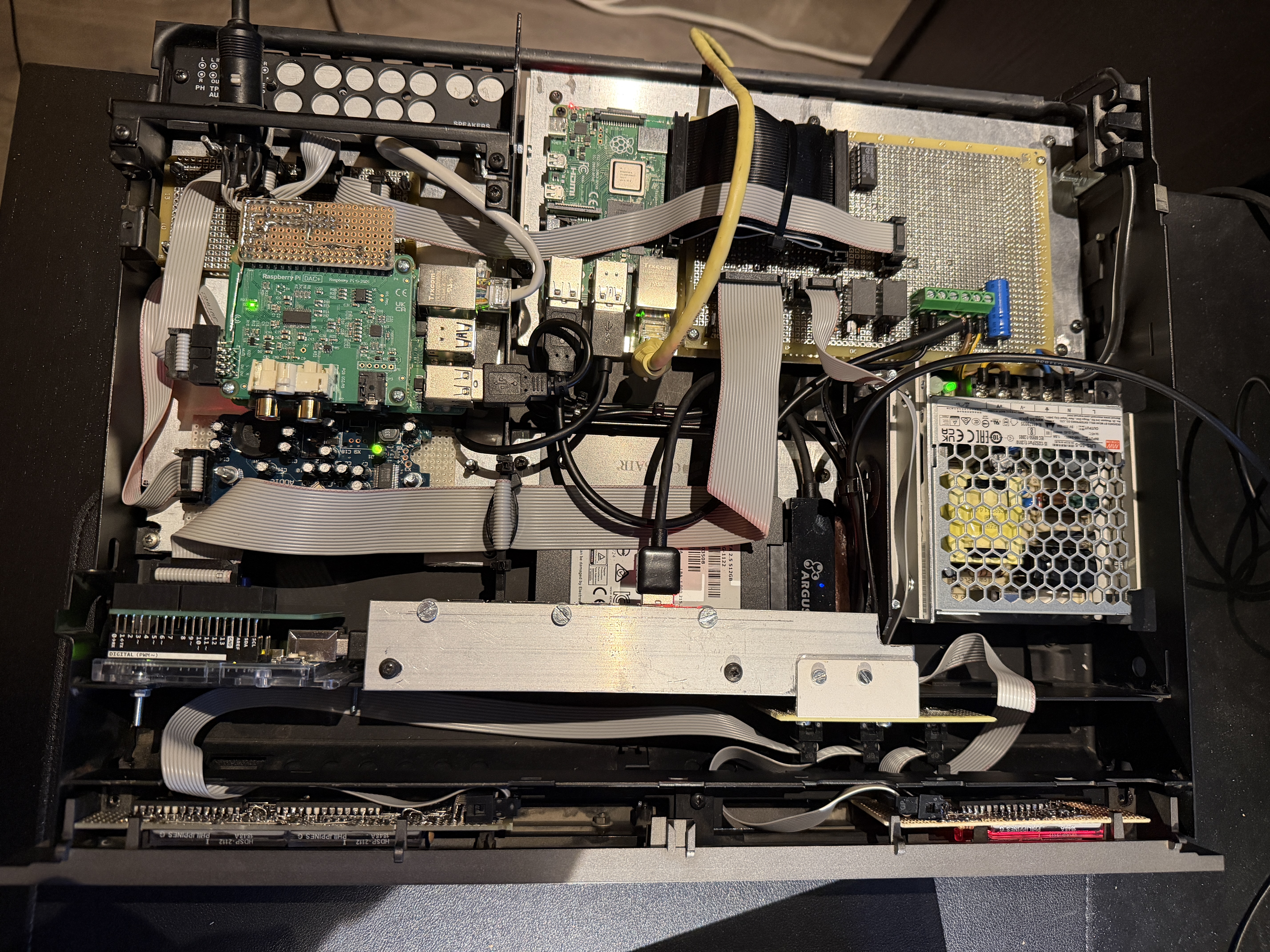

1 February 2026 at 20:32 #73066 type81BRONZE MemberNow we need a housing which gives the look and feel of a real B&O device.
There was another Beomaster 5500 lying around in the most appaling state you can imagine.
Full of scratches, all working internal components were transplanted into other 5500’s to give them a new life.
All defect parts were put into this little old scratchy fellow. Time to take his internals of and use the housing for something nice.Another requirement I didn’t mention before: Try to use the original frame and mounting points.
No drilling in the bottom plate, all components have to be mounted on the internal framing.
Drilling a hole is not a problem, but no angle grinders or other barbarian tools please.
In the left corner on the photo where normally the transformer is situated, I placed a switching 5V/10A power supply.
In the middle where normally the cooling fan is situated, I placed a mounting bracket for a SSD harddisk.
On this mounting plate I put u 500GB SSD disk with a USB to SATA interface.
Above the harddisk I mounted a 5V powered USB hub. This is because I want to connect both a hardisk, but also want to be able to connect an external USB CD drive for CD ripping.

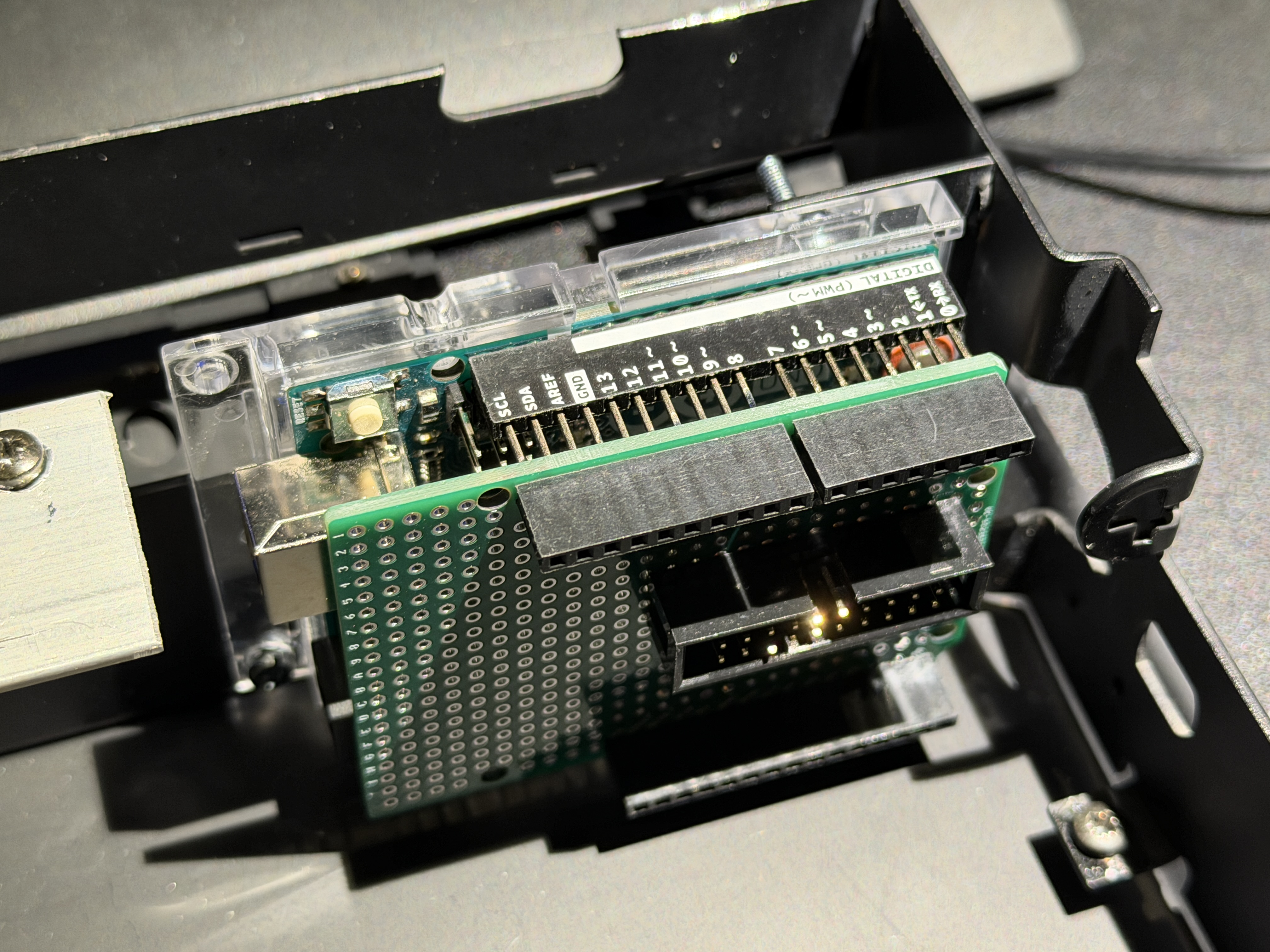

In the right corner is the Arduino situated for the low level controlling of the system.Location: Netherlands

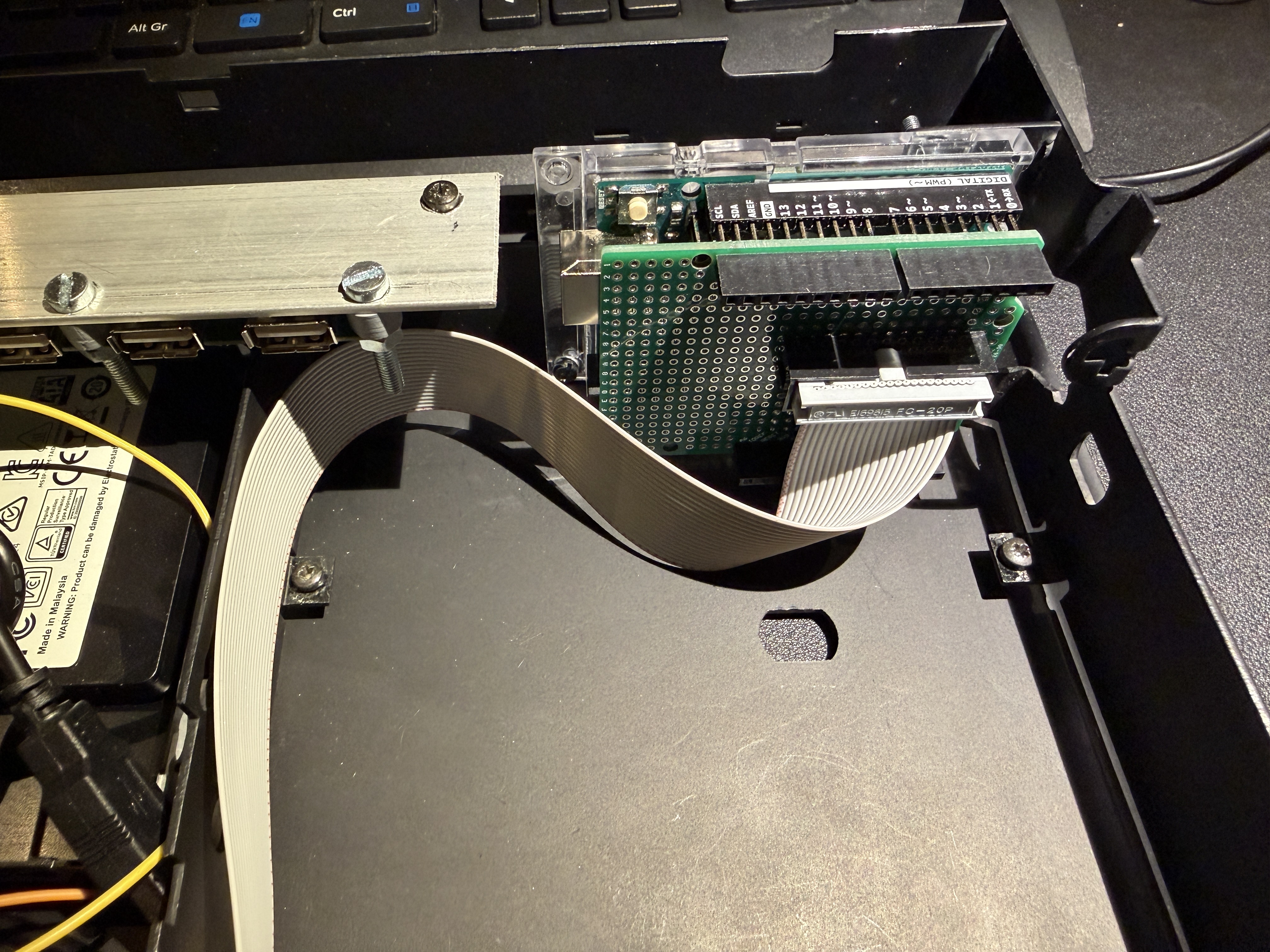

1 February 2026 at 20:48 #73074 type81BRONZE MemberAs mentioned before, I want the system to be modular and parts need to be replaceable without a lot of soldering.
Also, I don’t want hundreds of single wires from one to another component.

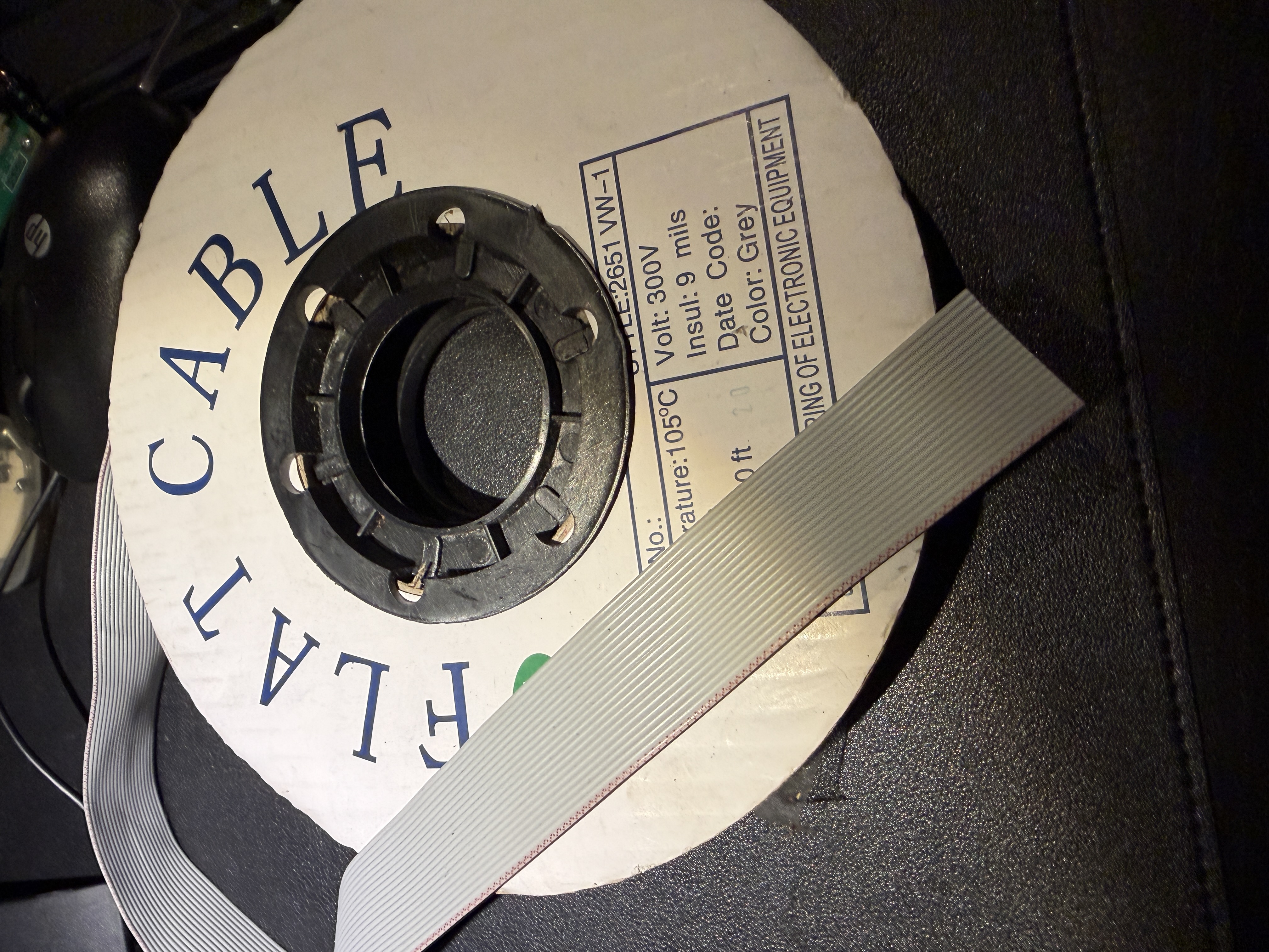

Ideally there should be one connector with a flatcable on each part, and some sort of connecting board where all comes together.

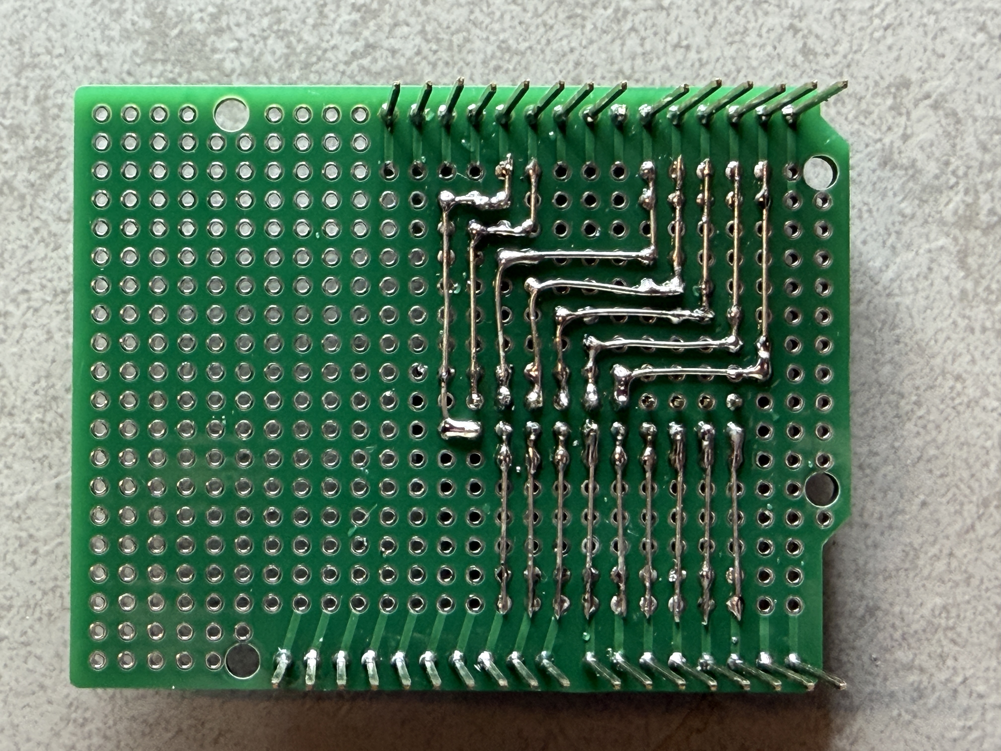

This meant I had to create a breakout board for the Arduino. I found a nice board on Amazon which could help me with this.
Combined with a 10 pin IDC connector it ticked all the requirement boxes.
Power can also be applied via this connector, so the huge power plug which normally supplies the voltage to a Arduino could be omitted.Location: Netherlands

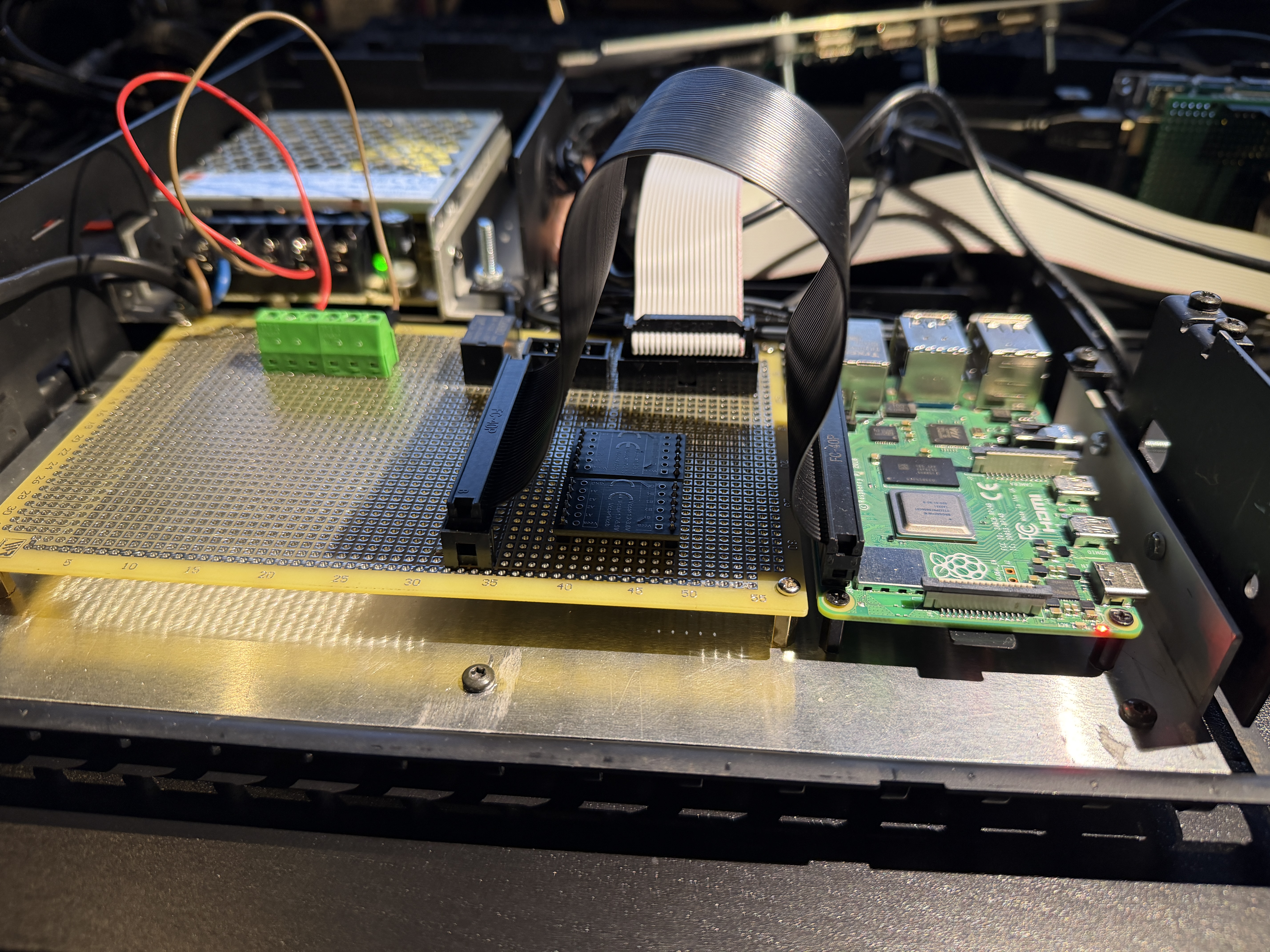

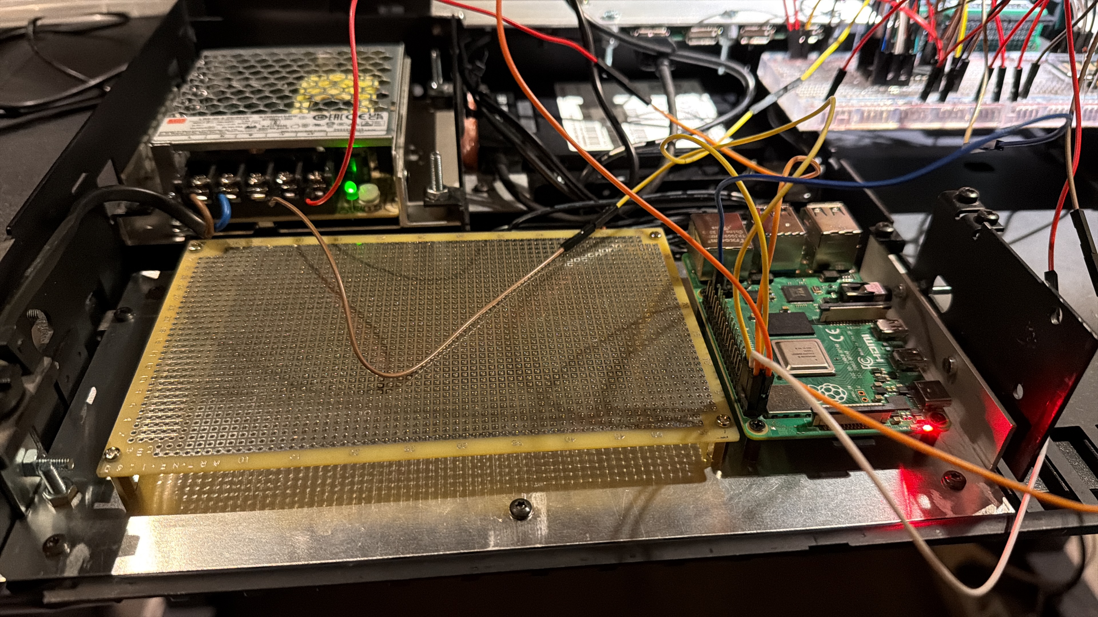

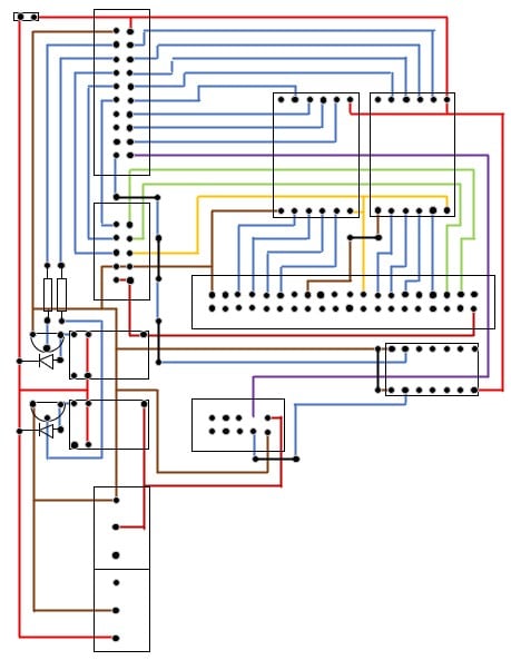

1 February 2026 at 21:14 #73079 type81BRONZE MemberNext: Create a baseplate which houses a standard universal grid PCB, and a Raspberry Pi.
This baseplate is also mounted on the internal frame, and is not connected to the bottom plate of the Beomaster housing.
The universal grid PCB will be the central PCB, to which all components will connect (ideally by a flatcable)
In the background already a sneak preview of the testing of LED Matrix displays from the Raspberry Pi.
The Raspberry Pi on the picture is not the Pi which will be the Volumio streamer, but this Pi will control the LED displays and talk to Volumio with API calls.
Via this API calls we get the currect state of the streamer to project on the displays, but also sends commands to Volumio like start/stop/next etcetera.Designing the print layout takes a lot of time but I was able to position all parts on a small layout. This gives me room for future expansion.
The first components are mounted on the print. A 40 pin IDC connector to the Raspberry Pi, a 20 pin IDC connector to the Arduino
The power supply is connected to the PCB and the first relay is situated.
Underneath the 40 pin flatcable you see 2 small PCB’s. Those are voltage translators.
This is because the Arduino has a 5 volt GPIO voltage, and Raspberry Pi operates on 3,3 volt level.Location: Netherlands

2 February 2026 at 18:40 #73121 type81BRONZE MemberNow the creation of the PCB’s behind the frontpanel. As said, I try not to use barbarian tools like angle grinders.
So the goal is to create something which can be placed in the original frame. It’s really tight in there but I managed to create a PCB with the right proportions, 2 screens and 2 gpio expanders.
This PCB will be placed on the left side of the frontpanel. It was a bit of a struggle, while the expanders had to be placed on the backside of the PCB and the screens on the front of the PCBOn the right side is 1 screen, which is built the same way.
As you can see, it is tight. Very very tight. But it fitsLocation: Netherlands
2 February 2026 at 19:01 #73131 type81BRONZE MemberNow that the screens are ready, they need to be connected to the Raspberry Pi.
At the time I built the central connecting PCB, the idea was to create 1 large screen but this was impossible without the “tools”
So I need to connect 2 screen PCB’s to the main PCB, but I anticipated for just 1.
Creating a second socket would imply a complete redesign of the main PCB.
I decided to create an intermediate PCB.
Behind the front panel where normally the CPU of the Beomaster resides I had enough space to position this extra unforseen PCBLocation: Netherlands
