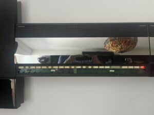

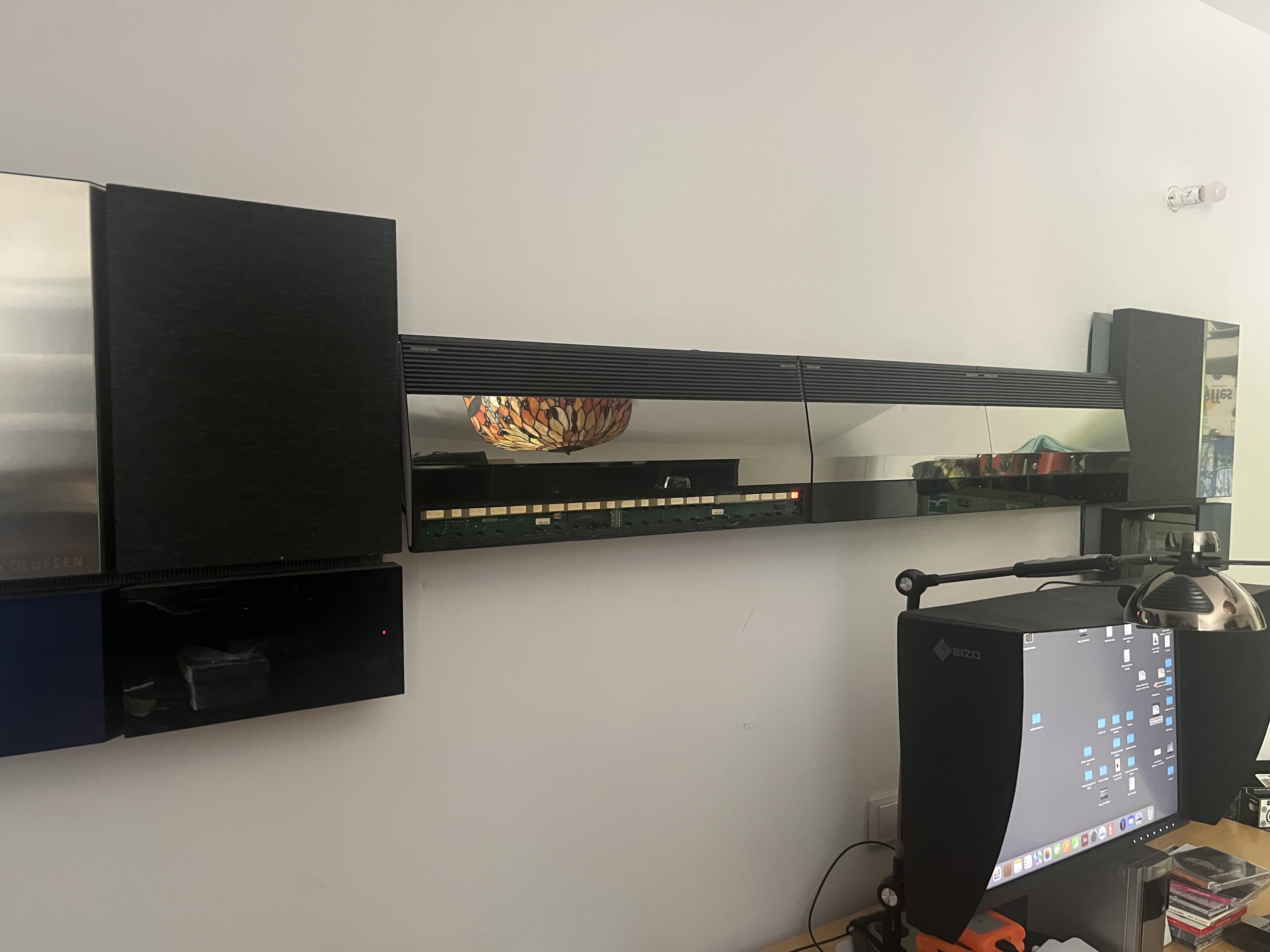

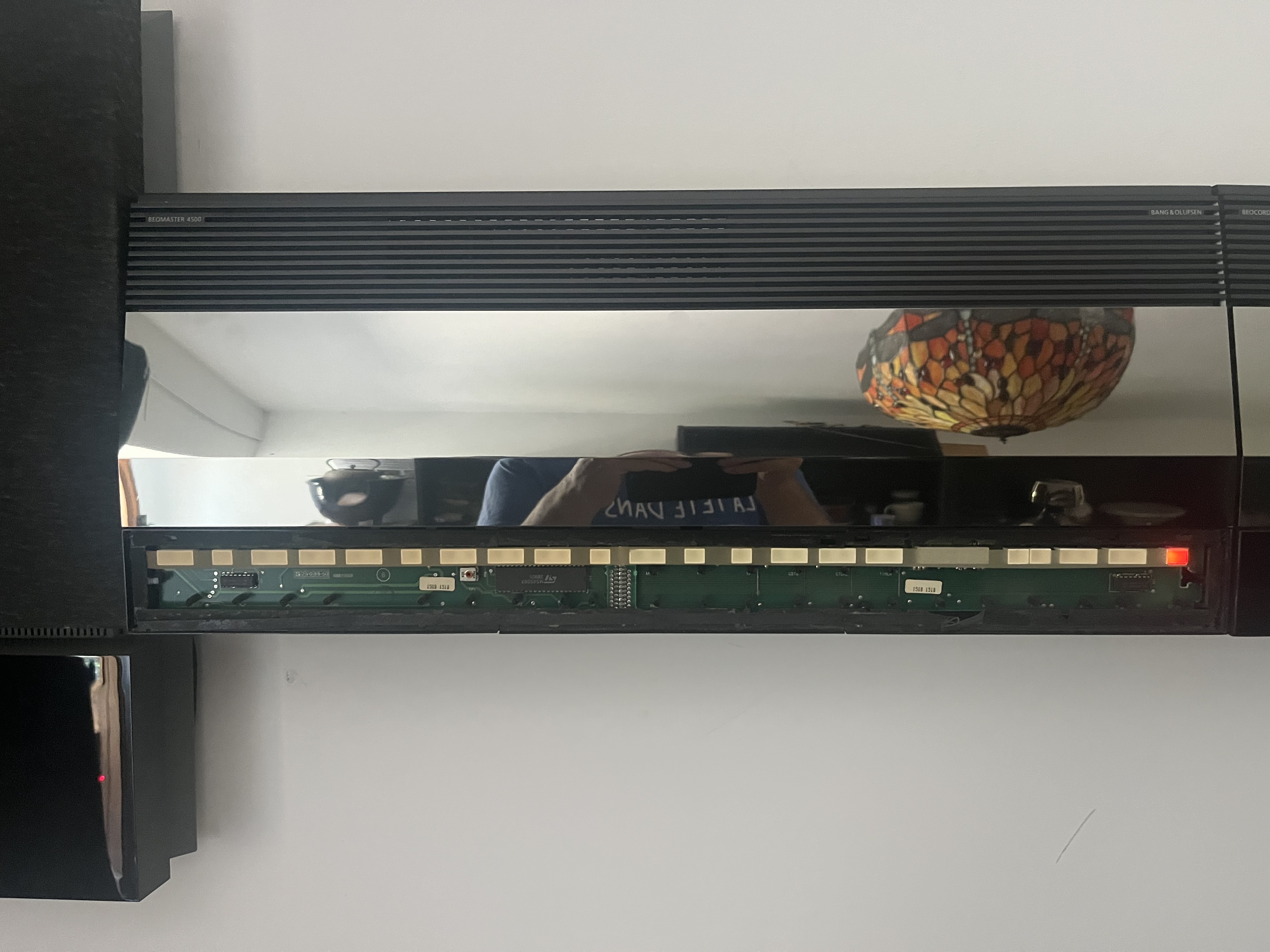

    With temperatures nudging 40c outside and 31.5c inside for the last few weeks ,something had to give.
    A cover panel from my office BS 4500 fell off. Fortunately , no damage and the rest were not loose.
    Whats the recommended glue/ tape to fix this ?
