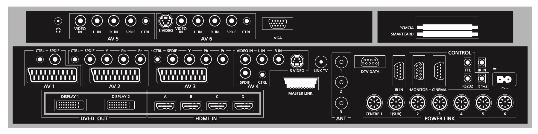

Tried V.OPT 1/0, but switching doesn’t work (only 2 available).
Issue: No external sound via AV5 (speakers orange), though Sound System shows PCM 2.0. In monitor settings, AV4, AV5, AV6 are not visible. Service menu: IIC1 -84: ACK_MIS, errors 00F8. AV5 is visible in Connections but not activated. Video works stably. I have a screenshot from the monitor available.

BRONZE MemberThank you for the response and the link, I’ve read it all. However, this doesn’t quite fit my case. I still want to use BS3 to pass digital audio to BeoLab 8000. I connected via RCA like this: TOSLINK from LG to a DAC → RCA to BeoLab 8000 (Line mode), and it works perfectly.
BeoSystem 3 is glowing orange. BeoLab always shows red. Powerlink is available, and that’s how I’d like to connect.
From the options I tried:
- HDMI Extractor – HDMI eARC/ARC to extractor → Coaxial to SPDIF on BS3. No sound.
- TOSLINK-to-COAXIAL converter – No sound.
- DAC (with TOSLINK-to-COAXIAL function) – No sound.
I suspect I might be mistaken with the settings or modes.
It also worries me that AV4-AV6 are not listed in Monitor Information, even though I’m connecting to AV5-AV6.

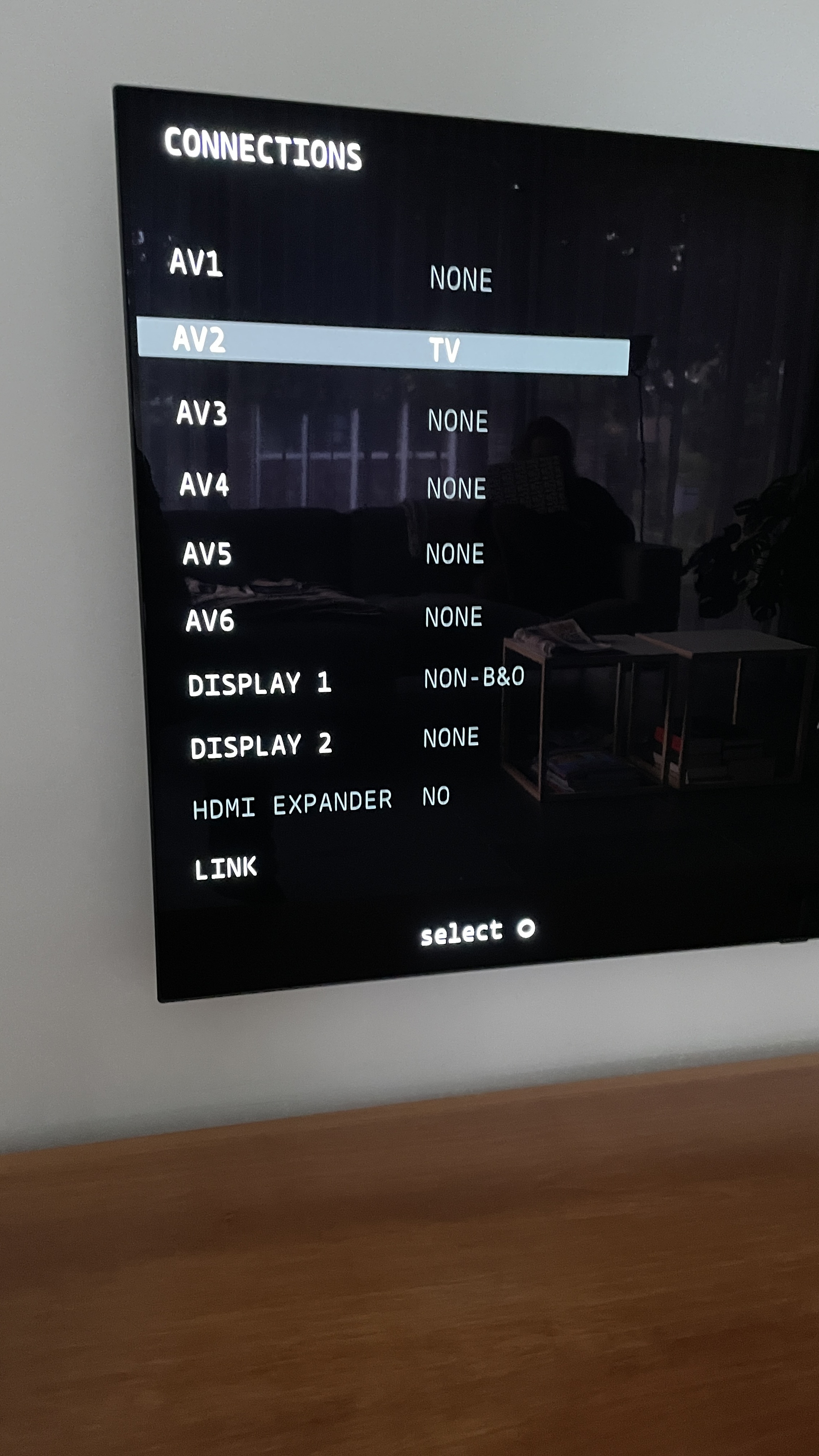

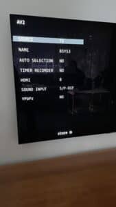

I am using the AV2 S/PDIF sound input on the BS3 (under CONNECTIONS)

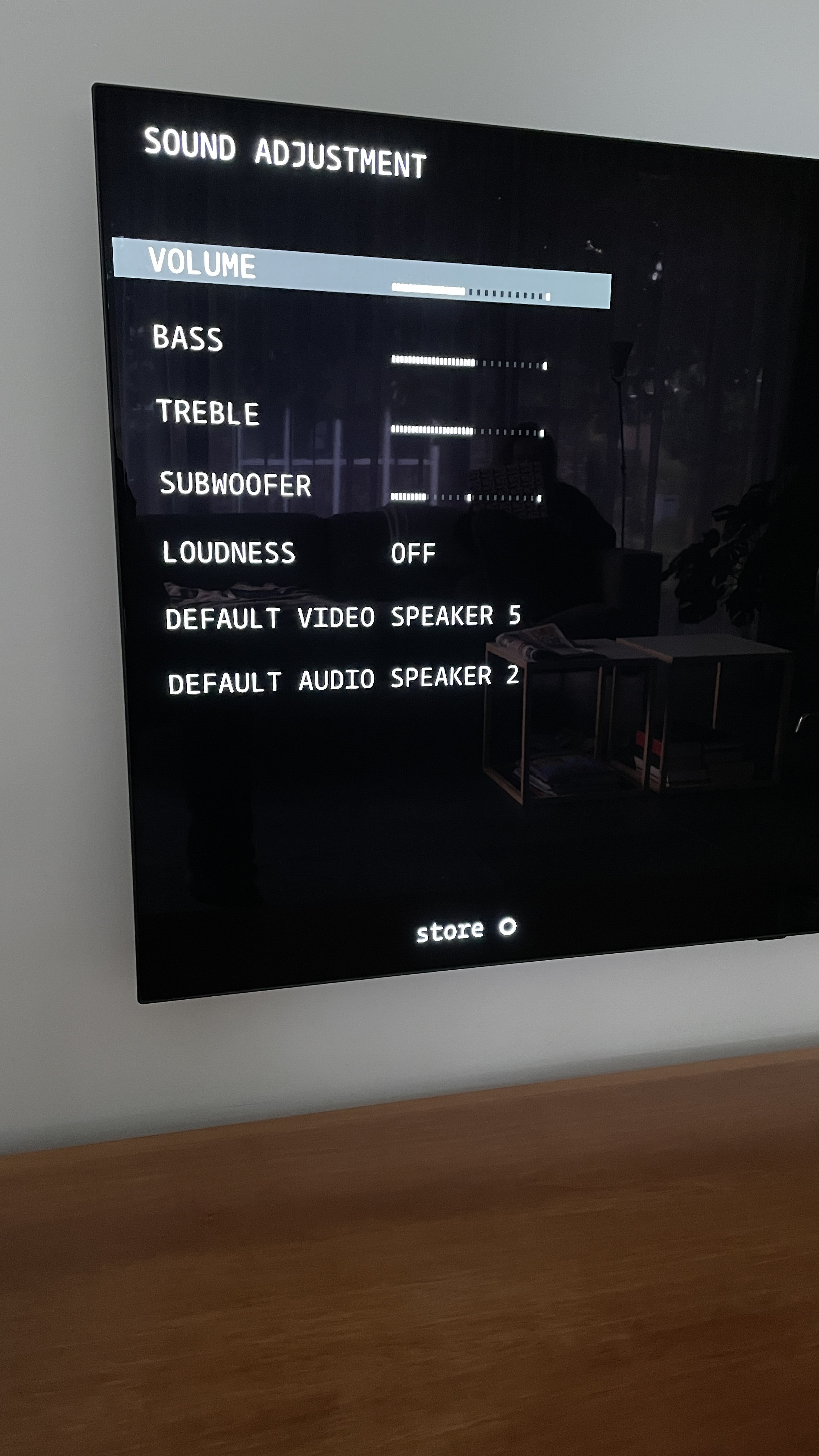

Have you assigned speaker types and roles? (under SOUND SETUP)?
And ‘default video speaker’ (under SOUND ADJUSTMENT)?

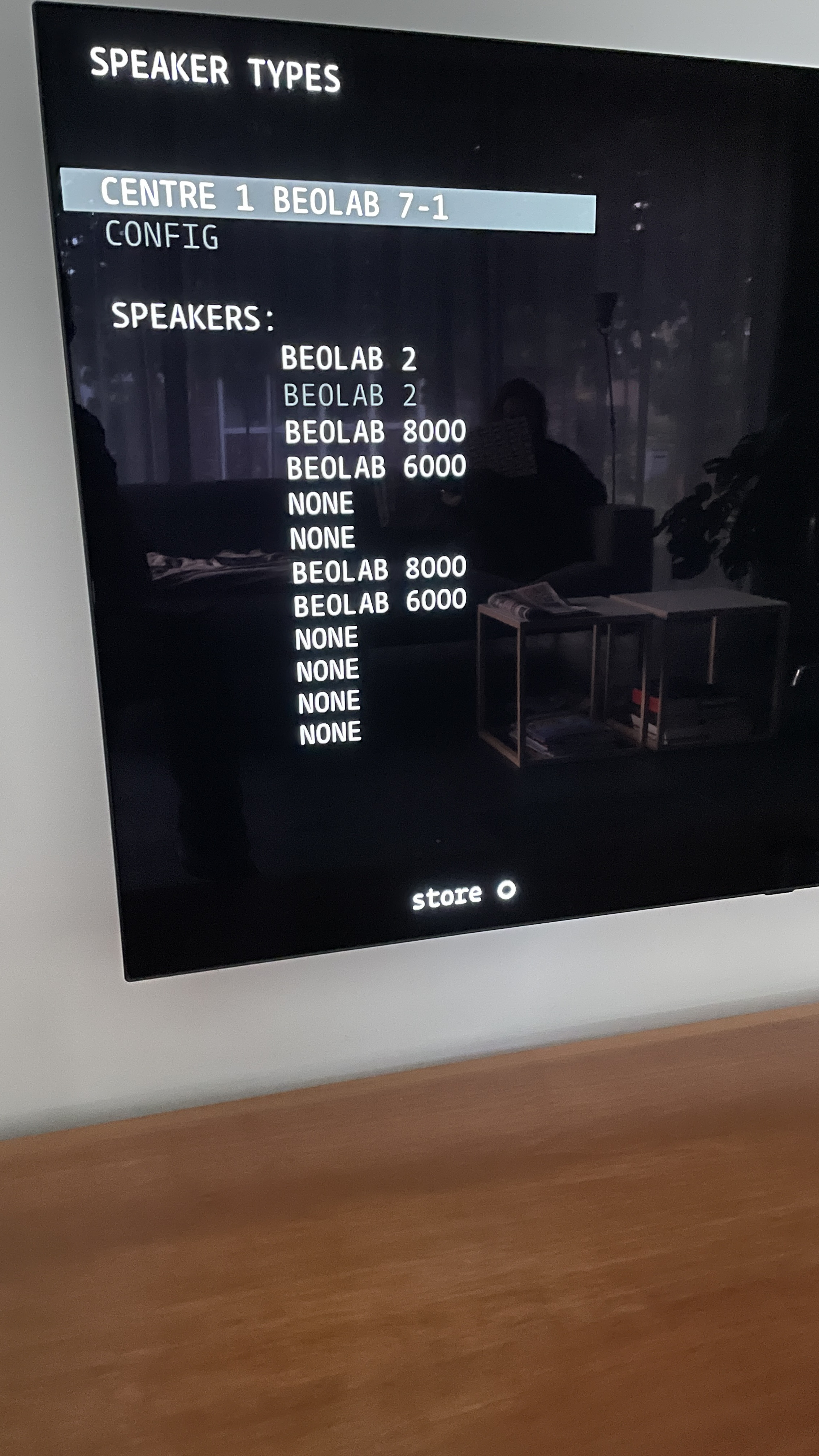

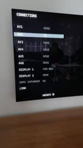

Can I plug into any S/PDIF input?
I switched to AV1 (it’s active in my service menu).

Speaker types and roles are assigned—speakers click when selected.

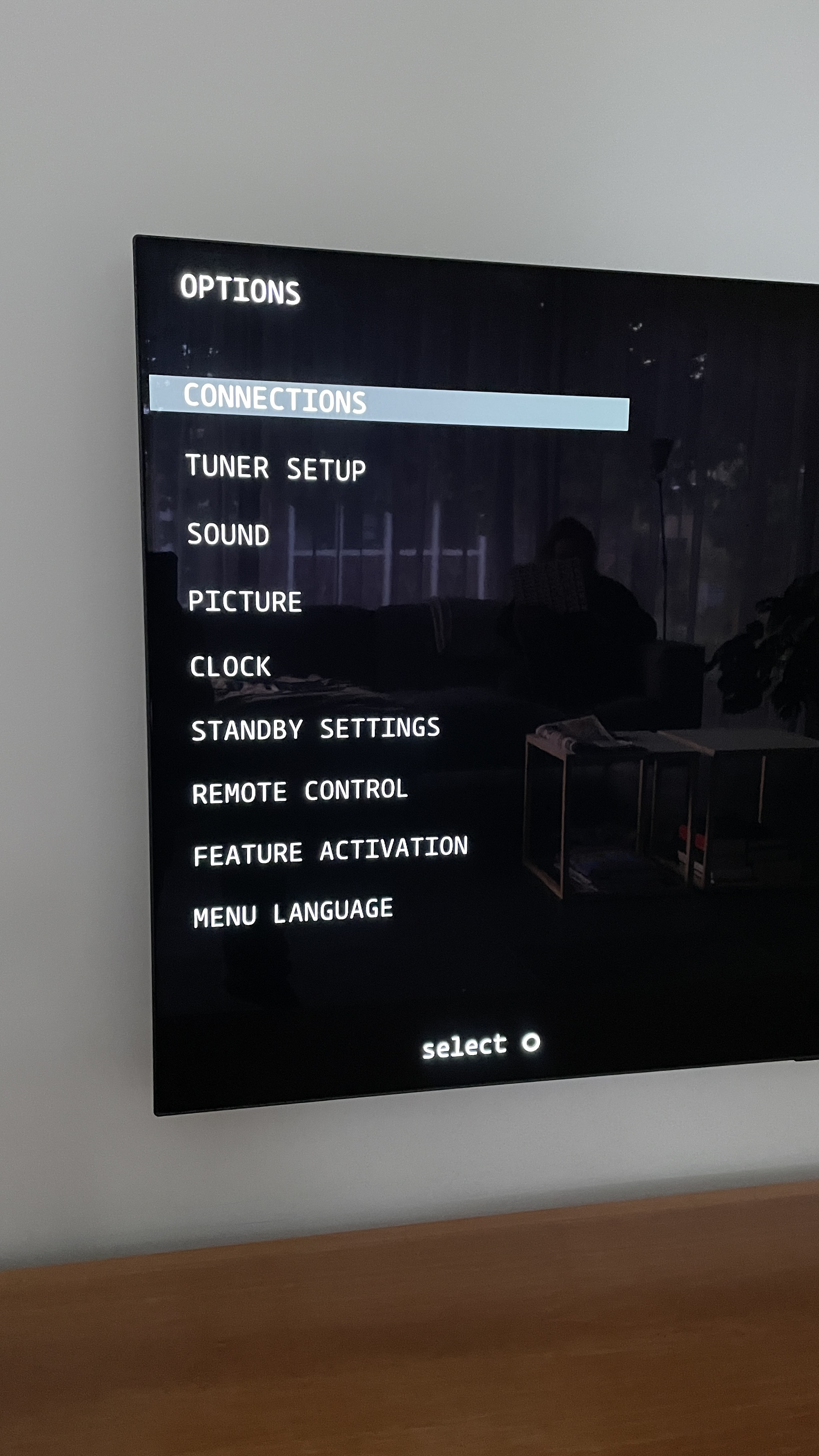

There’s no ‘default video speaker’ option under Sound Adjustment for me. I’m attaching a screenshot.I’d like to note that the BS3 is almost always in standby mode (flickering orange), as if it’s not receiving the correct sound.

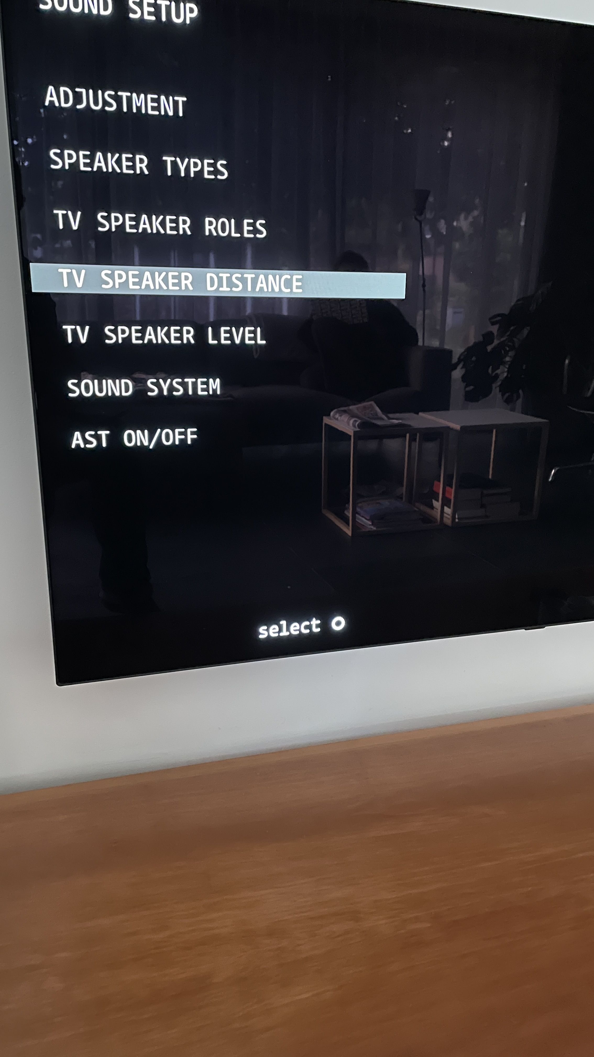

You must be logged in to view attached files.13 September 2025 at 19:15 #69626 Tignum
GOLD MemberHi,
You must use the input that you have assigned the remote control to. I am not sure if the Mk3 has the same menu as the Mk1. Maybe you can get hold of a reference manual?
Below a couple of screenshots of my settings:
I assigned the S/PDIF input to the TV command on the remote:

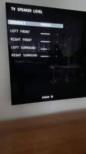

GOLD MemberWhen you set the ‘TV SPEAKER LEVEL’, do you hear white noise from the speakers? I ask this as you say that they do click.

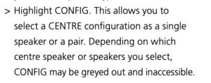

In case the BL8000s are the only speakers you have connected, you might want to try to connect them as centre speakers, use CONFIG to tell the BS3 that they are a pair of 8000s.
This is from the manual on the B&O site https://support.bang-olufsen.com/hc/en-us/articles/360041518532-Beosystem-3J.

BRONZE MemberWhen you set the ‘TV SPEAKER LEVEL’, do you hear white noise from the speakers? I ask this as you say that they do click.
J.
No, they only click when their roles are selected.

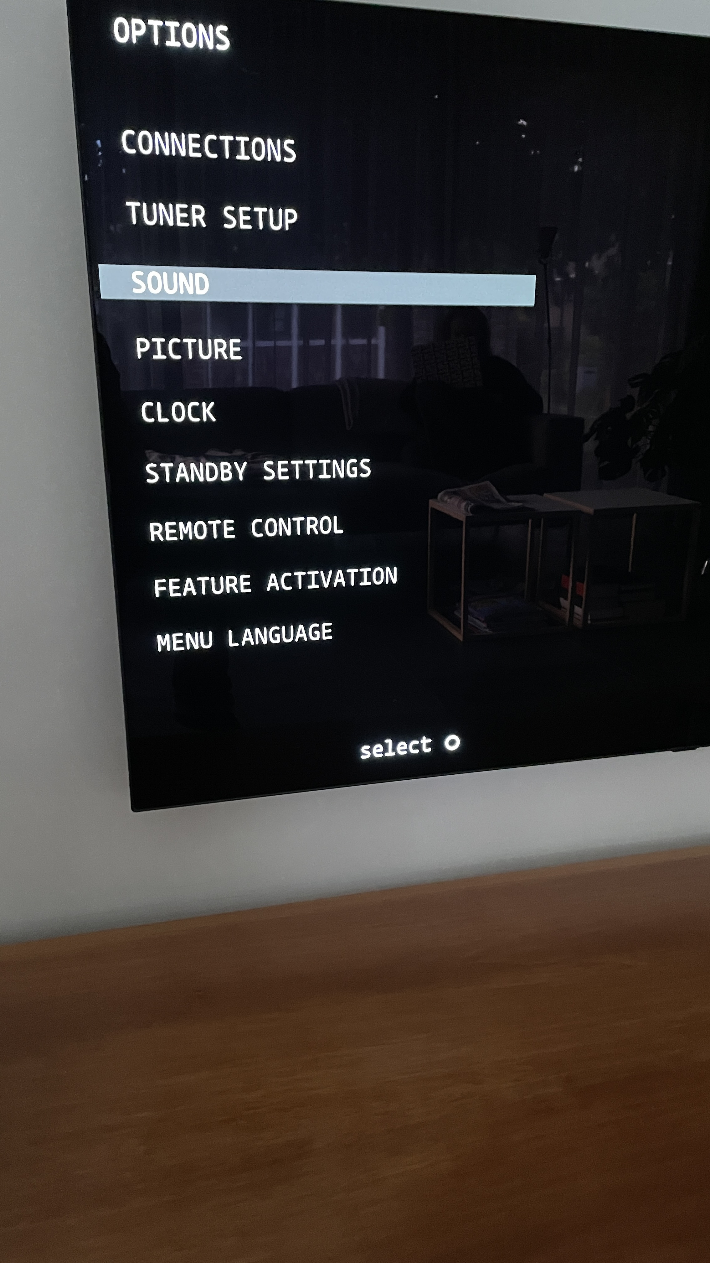

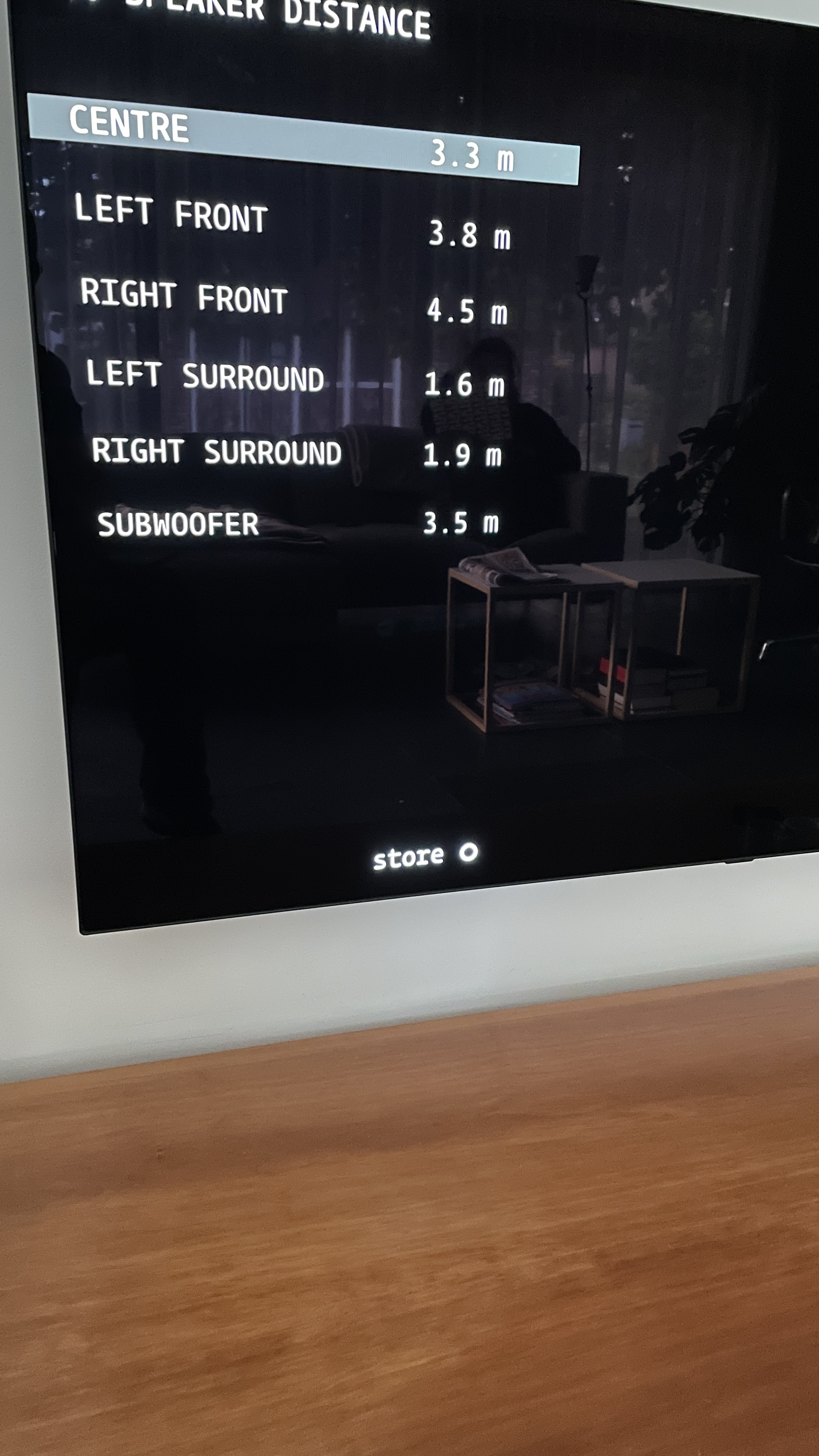

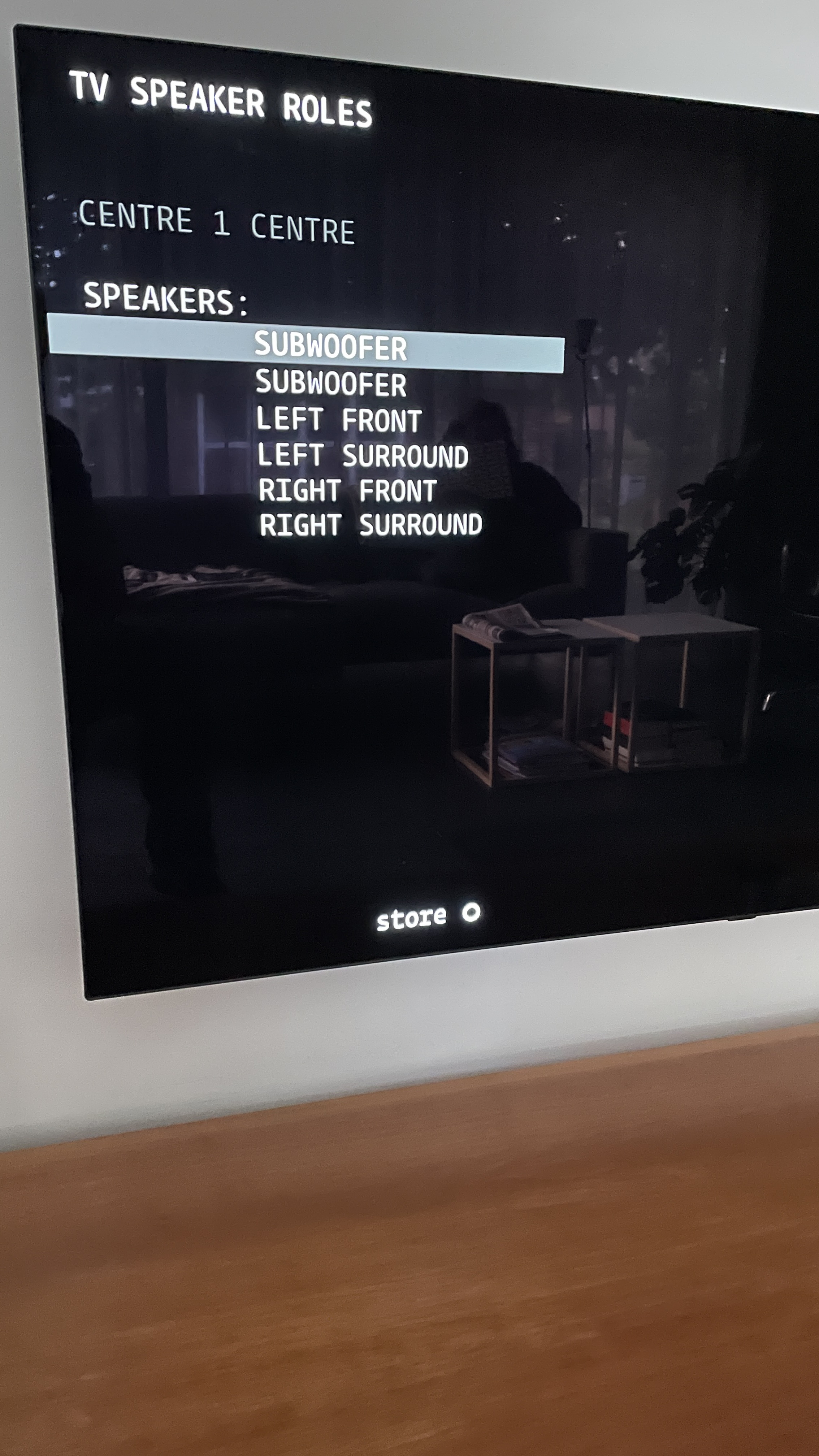

Then under OPTIONS/SOUND, you can see how I listed my speakers, their roles, and their volume & distance settings, also that I want to use all speakers for video use, and 2 speakers for audio use (SPEAKER 5 / SPEAKER 2)
Are you not using a centre speaker? Could it be to better use another powerlink socket? The first two are dedicated to center and sub:

Regards JohanI will attach screenshots, as I think the issue might be with the source. This is because standby lights up orange after 5 seconds.

When you set the ‘TV SPEAKER LEVEL’, do you hear white noise from the speakers? I ask this as you say that they do click.J.
No, they only click when their roles are selected.That is weird. When setting the speaker levels, I trust there should be a ‘white noise’ signal to be able to set all speakers to the same volume.
