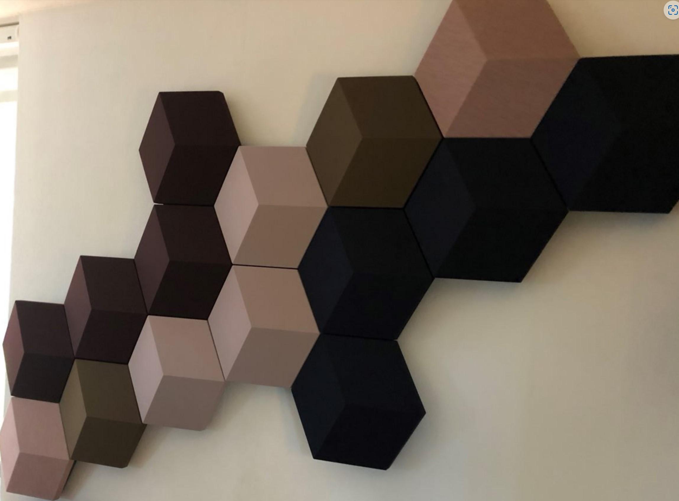

    #48178
    beofrederic
    #48179

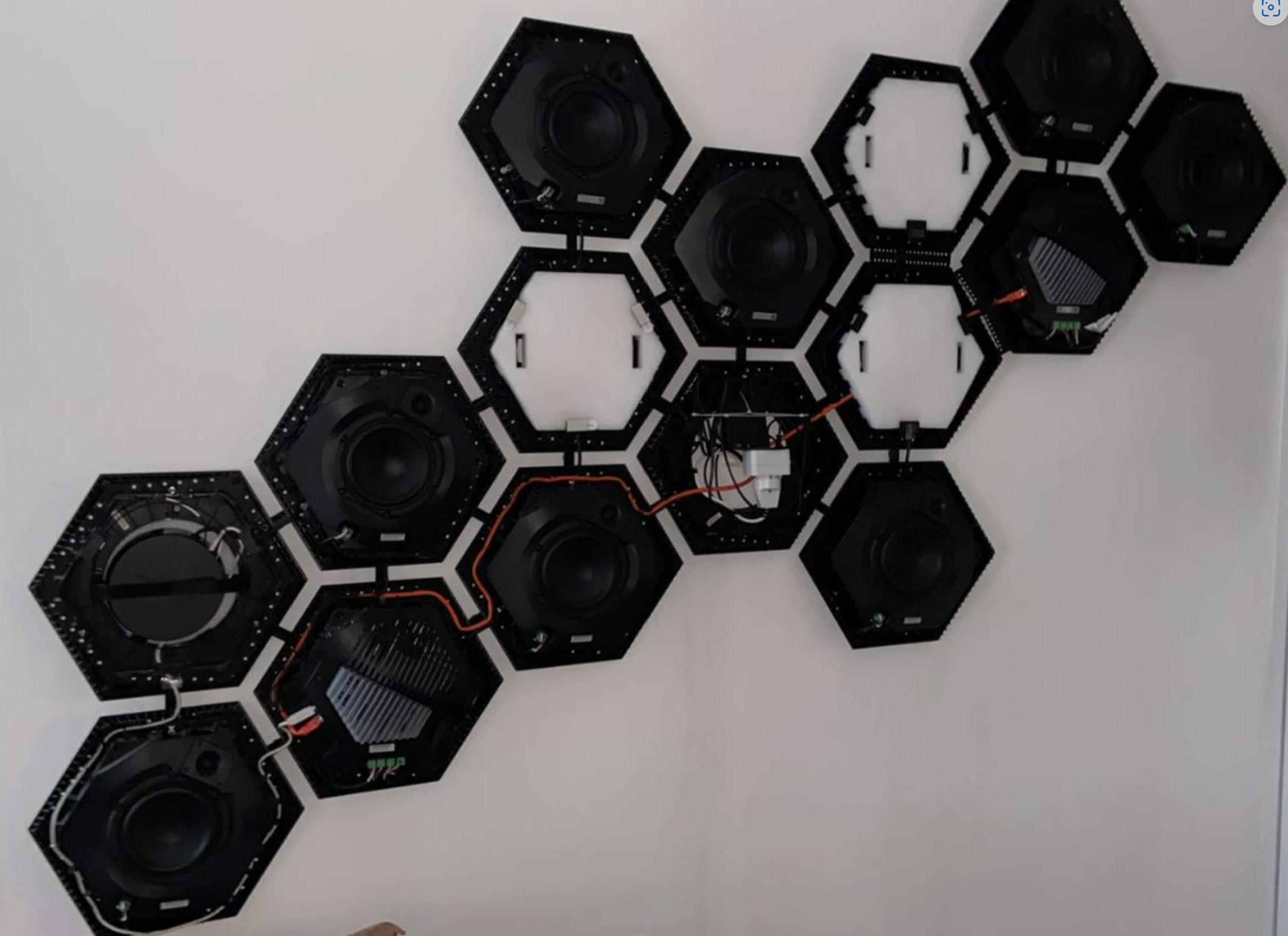

    carolpa
    2 amps + 8 speaker units
    #48180
    carolpa
    recommendation:
    -. pre install Line IN (even if not directly needed)
    -. pre install Powerlink cable (even if not directly needed)
    during in-wall installation of cables.

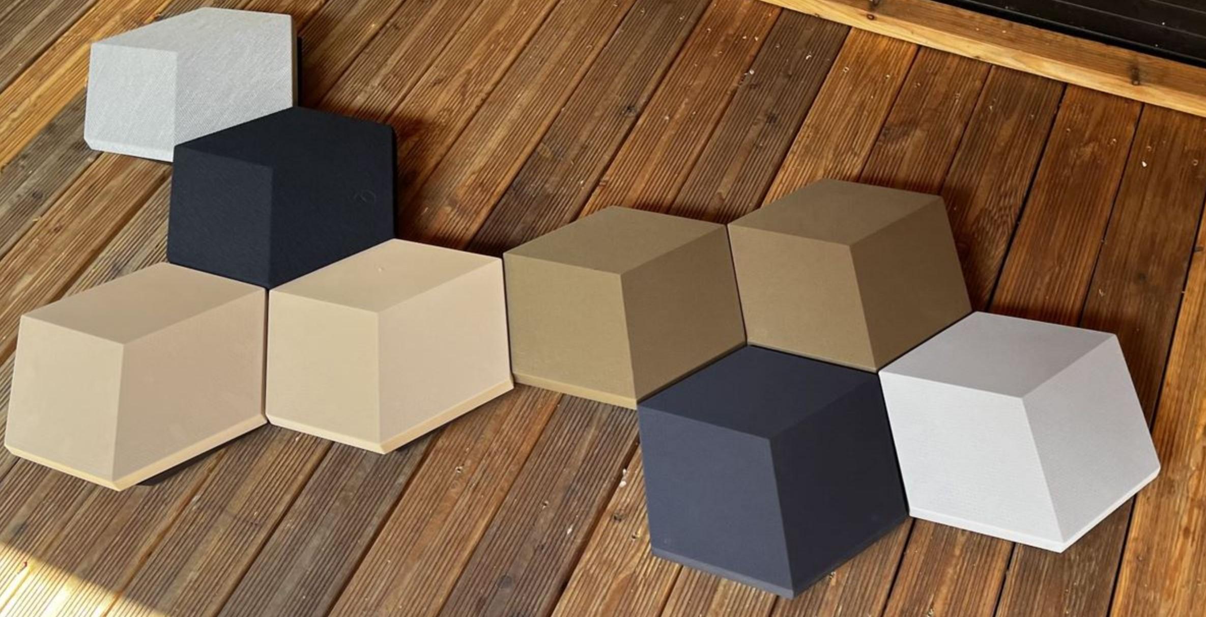

    #48182
    carolpa
    second one: but will be installed at my sisters living (1 amp + 4 speaker units)
