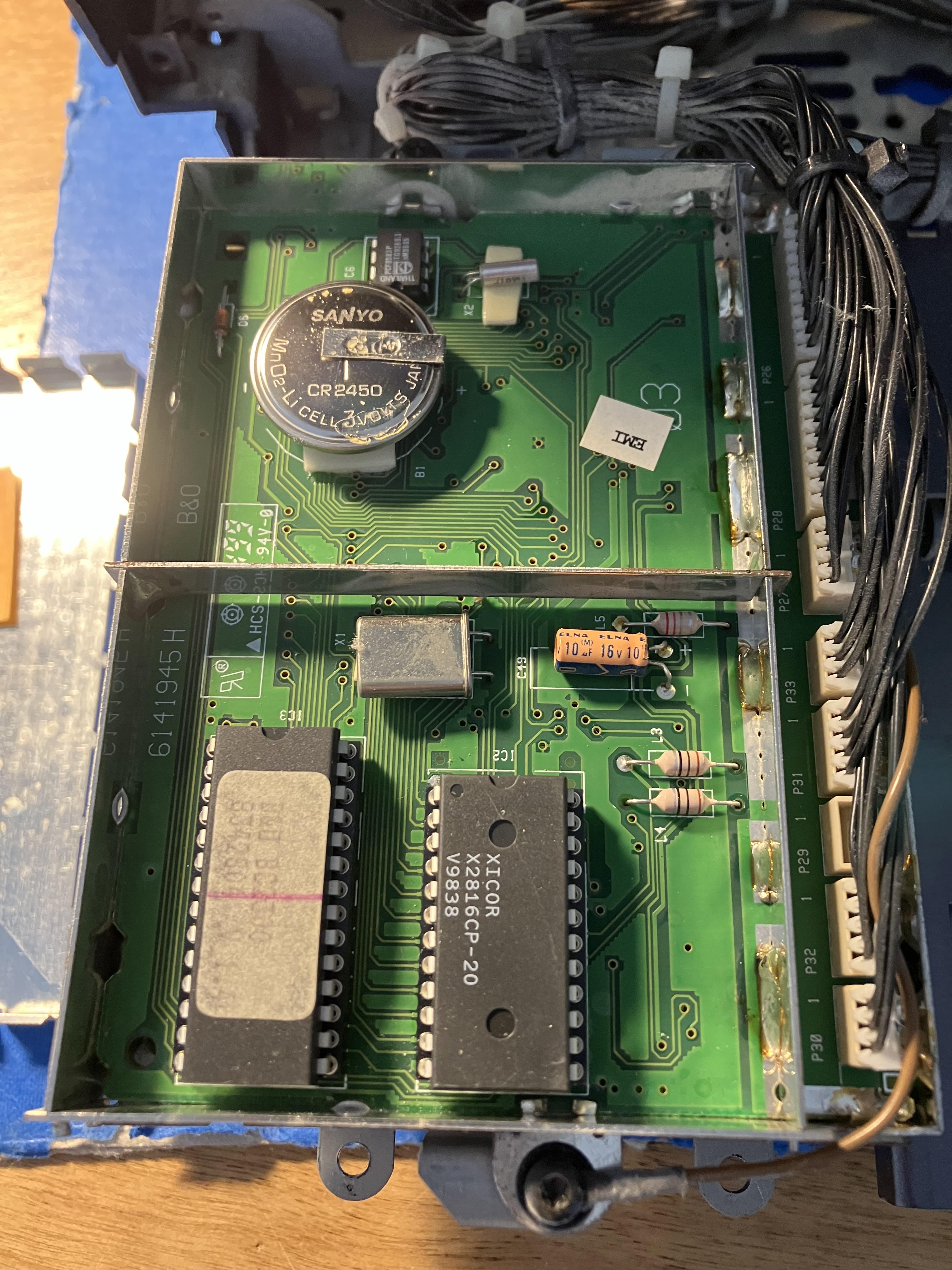

    and a new CR2450 battery will arrive with the capacitors!
    Where is this CR2450 battery located? I don’t think I have noticed one while working on my Ouverture.
    Location: Denmark
    #50383
    Guy
    Under the cover on the left of the photo above:
    (Will be replacing with this one from Farnell:Β https://uk.farnell.com/renata/cr2450-nfh-lf/cell-lithium-button-2pin-3v/dp/1319731
    EDIT:Β  The battery is not leaking below – it had a protective sticker on top and you can see the remnants of the glue.
    IMG_7956
    Location: Warwickshire, UK
    My B&O Icons: No description available No description available No description availableNo description availableNo description availableNo description available No description available No description availableNo description availableNo description availableNo description availableNo description availableNo description availableNo description available

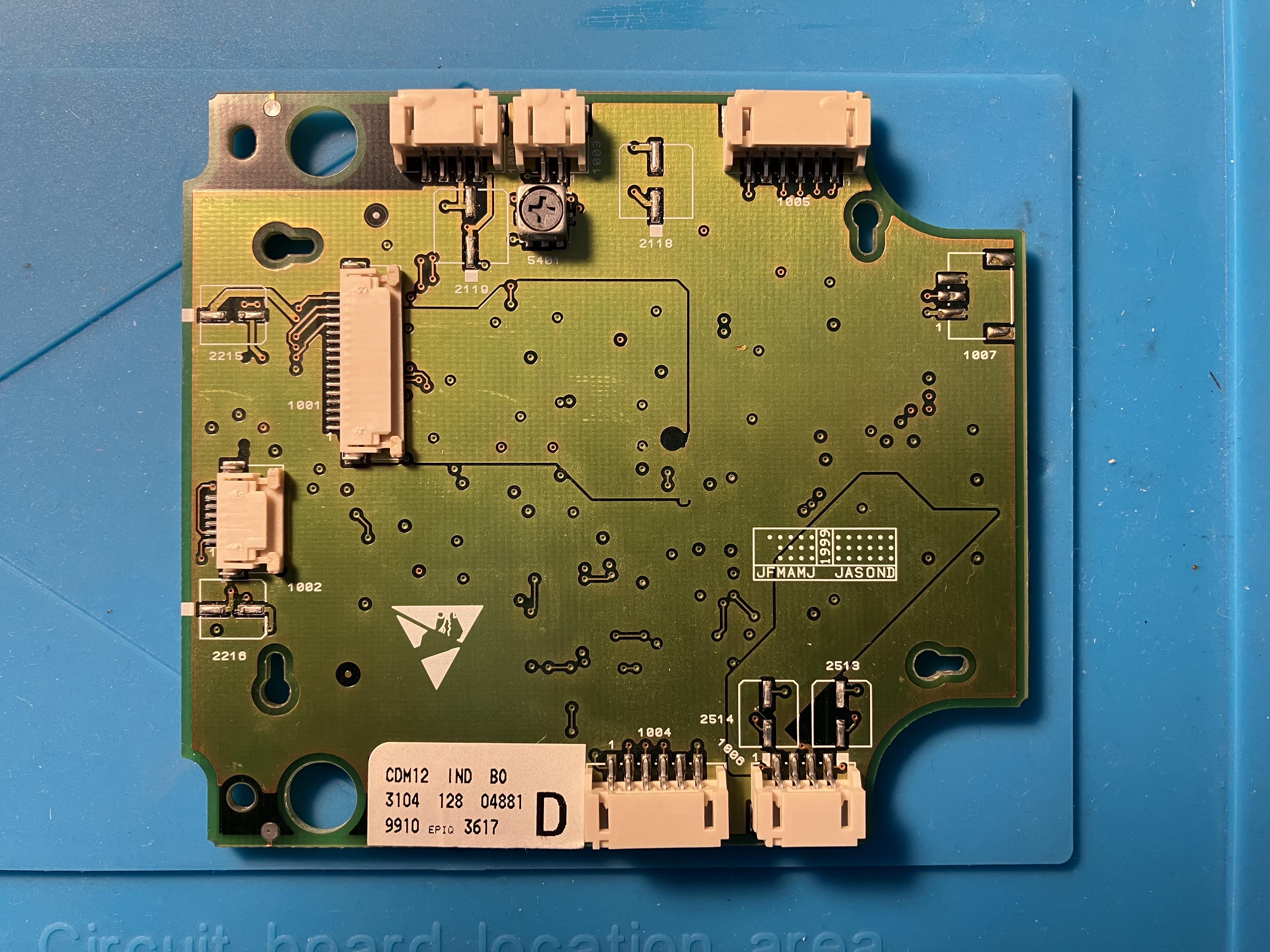

    Quick update regarding my BC2300 CD problems:
    All the spares (new laser, batteries, capacitors) arrived about a month ago, and finding myself with about an hour to spare I decided to replace the laser first. It was quite straightforward using the instructions within the YouTube videos linked earlier.
    Anyway, on testing, the CD player burst into life and worked faultlessly, for about 20 minutes …. ? Then the same fault re-appeared and I couldn’t get it to play any CD again! I ran the test mode and am still getting the same ERR 2 focus error.
    Pressing family matters mean that I am unlikely to investigate further for a few weeks (hence my absence from the forum recently), but when I do have time I plan to replace the SMD capacitors on the CD driver board. I did mean to do this first but didn’t have time to devote to my least favourite pastime of soldering!
    I do worry that fitting a new laser to a faulty CD driver board may have damaged the laser, but hopefully my concerns are unfounded.
    More to follow, but not for a while …

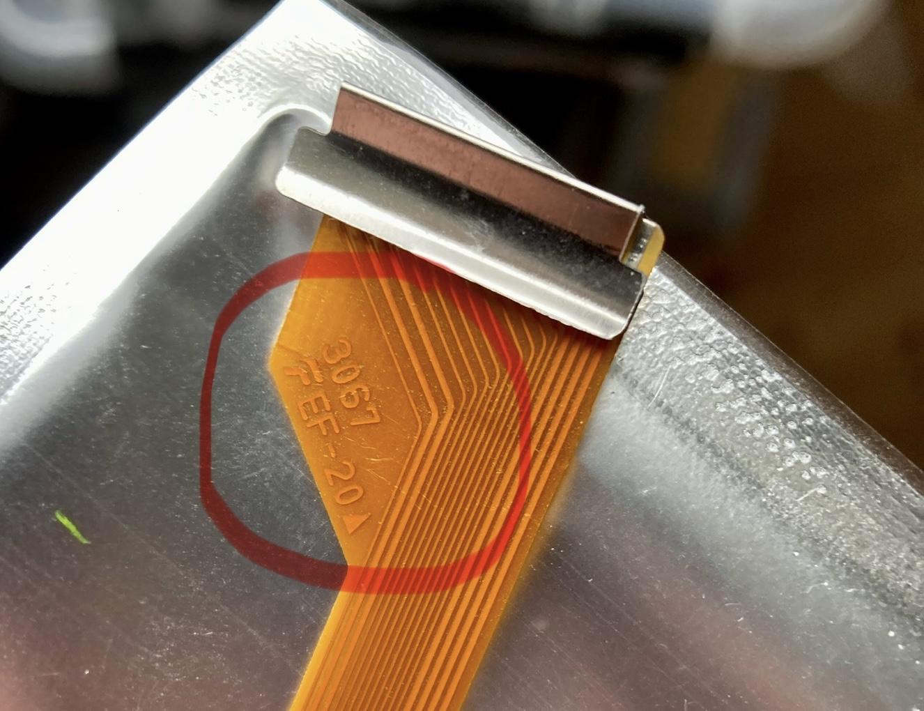

    Note the note about cable and socket matching here:
    Hi Martin – yes I did have to trim the ribbon cable very slightly as described, so that it would go into the housing. When I next have time to disassemble I will double check that the ribbon is pushed fully home and will also have a look at the alignment of the contacts.

    Anyway, on testing, the CD player burst into life and worked faultlessly, for about 20 minutes …. Then the same fault re-appeared and I couldn’t get it to play any CD again! I ran the test mode and am still getting the same ERR 2 focus error.
    Pitty that it was not enough. I might have to do some more playning for a longer time to see if my BS Ouverture is stable for a longer period of time. I never got the ERR 2 focus error though.
    Note the note about cable and socket matching here: https://www.beoparts-shop.com/product/cdm12-4-laser-module-beocenter-2300-2500-beosound-3000-4000-ouverture-a-o/ Martin
    @Martin
    : The text you are linking to also mentions laser units with F8 <> 2 printed on the cable. If this text should be there would it be in this place (from one of my replaced lasers where the text is different):
    IMG_9708

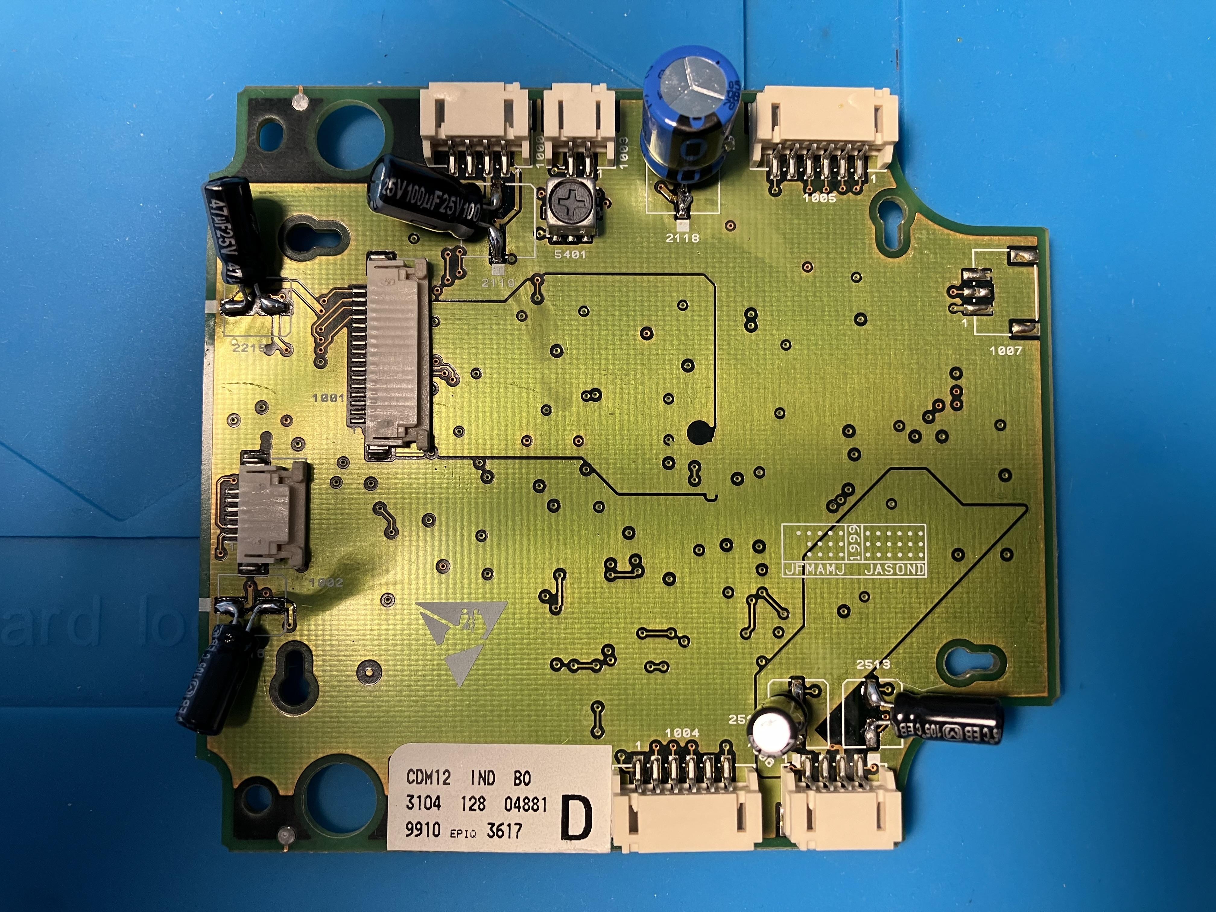

    So after a month of not working on my BC2300 I have today dug out my soldering iron and replaced the CD driver board capacitors.
    Board after removal of SMDs:
    IMG_8335
    And with the new capacitors, all Panasonic apart from the (blue) 330 uF which is a VISHAY.Β  I had to be very careful to orientate the capacitors so that they do not interfere with the CD laser movement.Β  The large VISHAY was tricky and I had to bend both legs into an L-shape in the same direction, soldering the hidden +ve foot first and then bending it forward to solder the -ve lead.Β  It now fits nicely into a groove in the side of the CD mechanism.
    IMG_8336
    And guess what?Β  I put it back together and it works, and for more than 20 minutes this time!!Β  It is a Good Friday!Β  ?

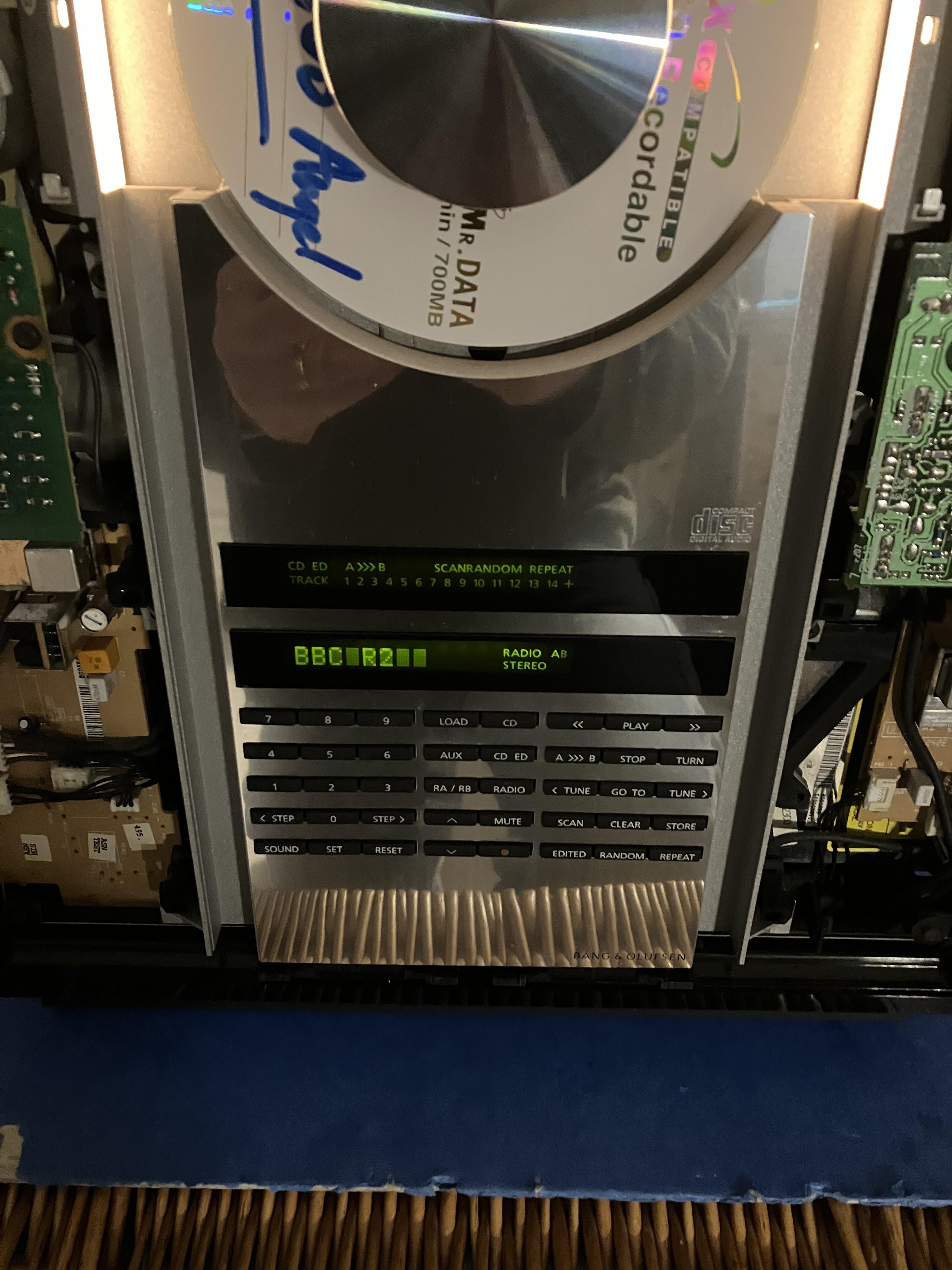

    I am now able to check my display in the dark and it is far too bright! (the non-lit ‘pixels’ are glowing too much which reduces clarity).Β  I’ll re-adjust tomorrow, probably back to where I started.Β  It’s a bit of a faff to adjust so I actually wish I’d never attempted.Β  So if you can live with yours as it is then I recommend doing nothing!
    On a positive note, I replaced both belts today – first time I have tried that and it was a bit tricky but successful.Β  I also replaced the lithium battery – I (carefully) soldered a new battery directly rather than use a socket because the sockets I bought were a bit large and may have pushed against the upper shielding.Β  Given that this is the first battery change in 20+ years I reckon that the replacement will probably outlive me.Β  (Old battery measured 2.86V no load, new one was 3.2V).
    I had to adjust the FM offset after the battery change.Β  This didn’t work the first few times and I think there may be an error in the manual.Β  It tells you to use TESTMODE, tune to a known station and then press GOTO, input correct freq then press STORE.Β  I found that I had to press STORE twice before the display would show OK and it would register.Β  I haven’t bothered with AM offset.Β  (EDIT:Β  I just checked Talk Sport on 1053kHz and it worked fine, so no need to adjust)
    So other than re-adjusting the screen brightness and re-assembling I am finished.Β  Apologies for hijacking madskp’s thread for the non-CD-related activities but I wish him all success in getting his Ouverture fully functional.

    Quick photo of display with contrast too high (do I mean too low?) – only BBC R2, RADIO A and STEREO should be visible!Β  It is much better viewed direct on, rather than at an angle.

    I am now able to check my display in the dark and it is far too bright! (the non-lit β€˜pixels’ are glowing too much which reduces clarity).Β  I’ll re-adjust tomorrow, probably back to where I started.Β  It’s a bit of a faff to adjust so I actually wish I’d never attempted.Β  So if you can live with yours as it is then I recommend doing nothing!
    Good to know. I have not noticed any issuses with brighness on my Ouverture, but if I do at one point I might have to consider what I can live with.
    Very good illustration of how it should not be πŸ™‚

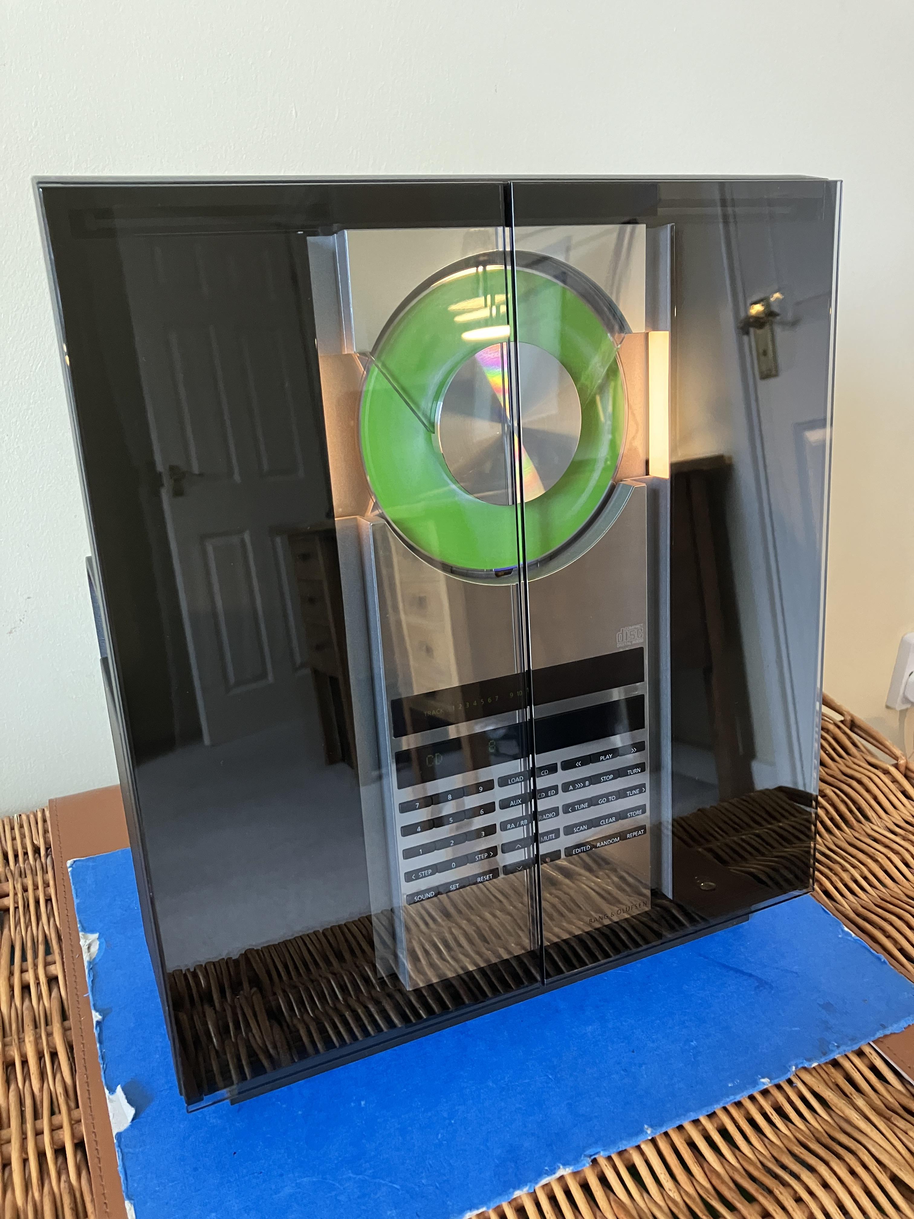

    All back together now …
