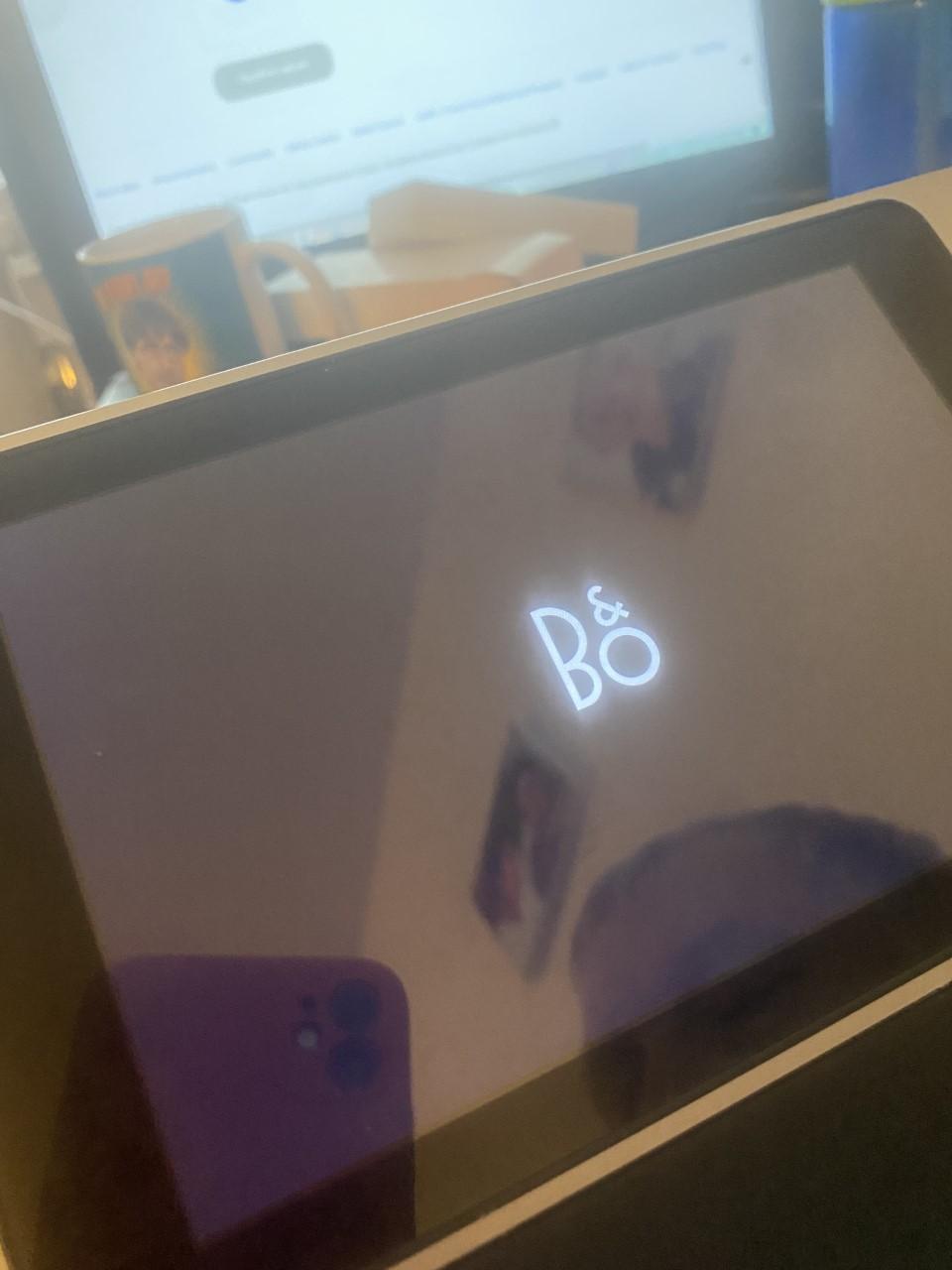

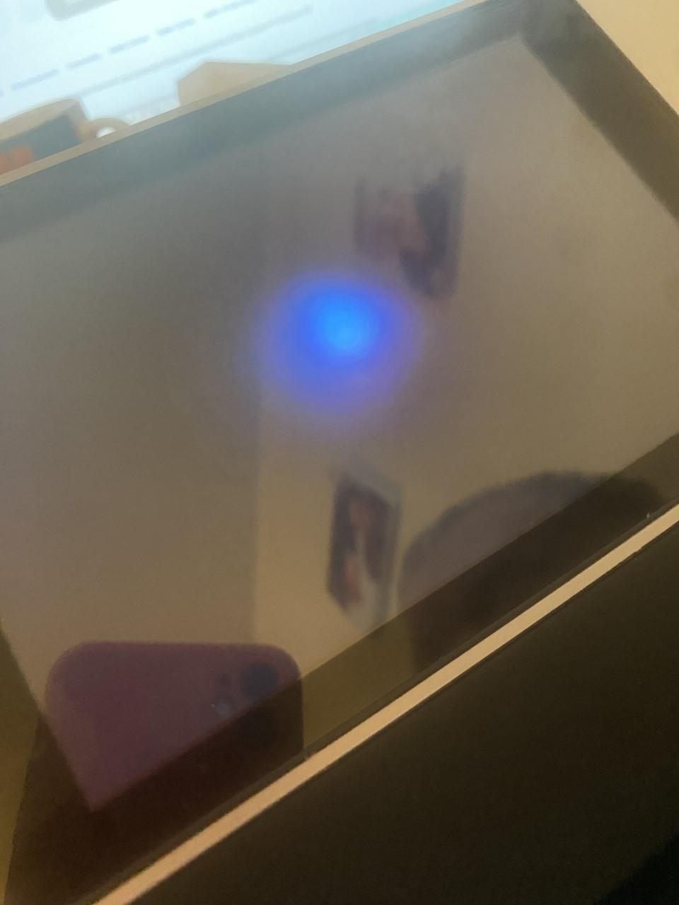

BRONZE MemberHI all my beosound moment has developed a fault it keeps looping
the logo nothing else can i somehow reset the tablet, i tried the 4 button press on wheel
no joy

10 April 2023 at 23:42 #45100ejmbon
BRONZE Memberthis is a video of it
11 April 2023 at 05:49 #45101 carolpaBRONZE Memberleave the Moment Hub off the Soundheart until it’s battery is drained completely.
put the Hub back on the Soundheart and follow bnousr 6 steps.
edited:
wait some time to let the battery recharge a bit.reset the the Hub (see above) with a pin/paperclip.
