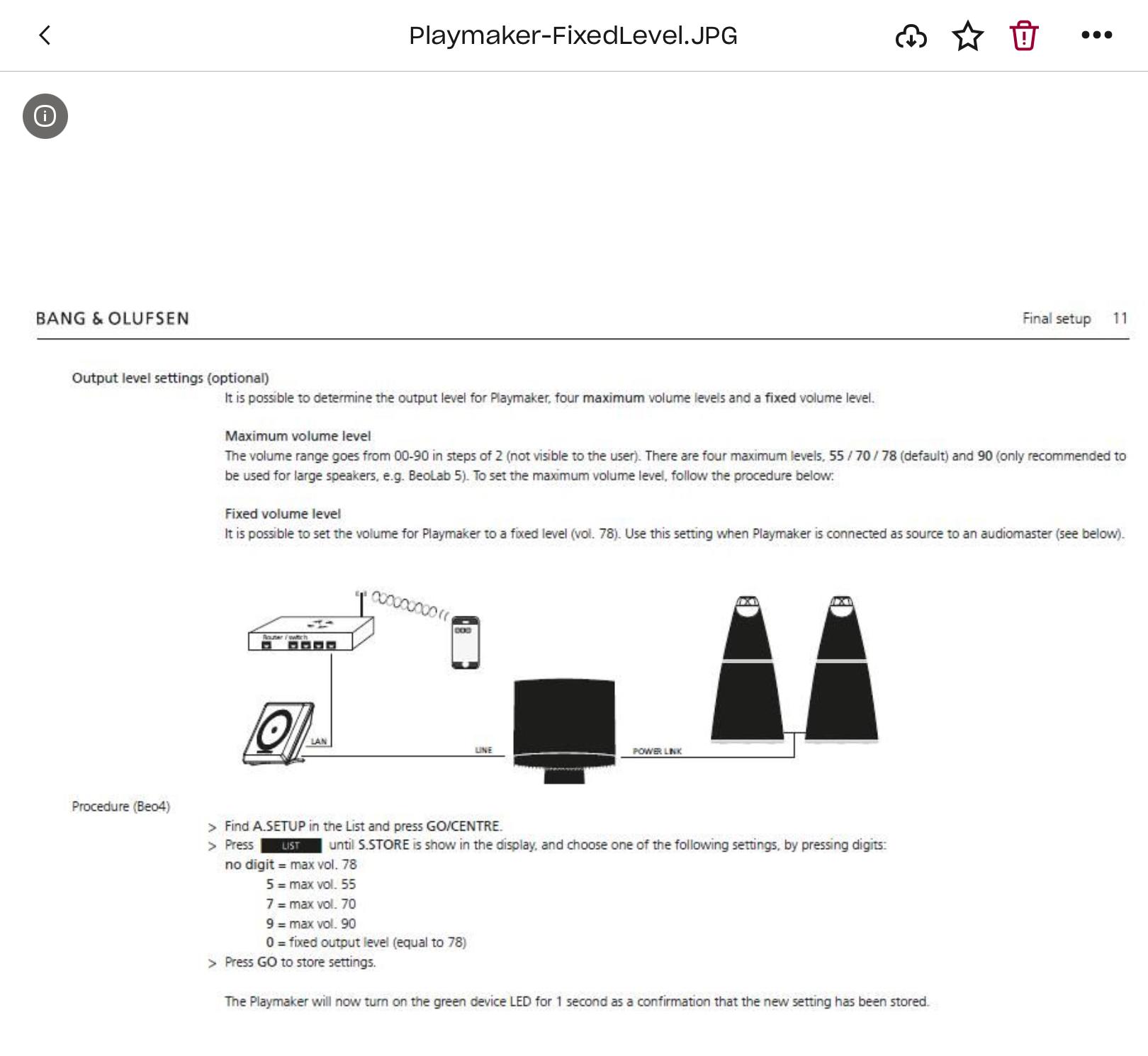

    You can use a PL output from the Playmaker with a RJ45 PL to DIN 5 pin male on Century/Aux.
    If set to ‘fixed line output’, you are ready to go.
    All volume control via the Century.

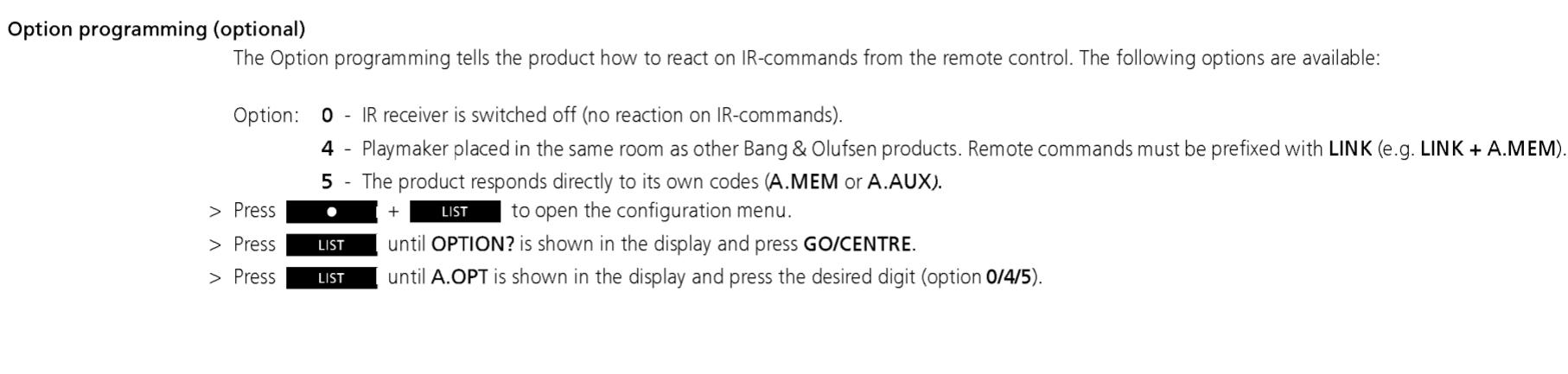

    Since the Playmaker probably is in the same room as the Century, it is recommended to set it/the playmaker to Option 0 to avoid ir control conflicts.
