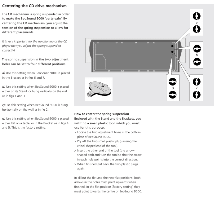

20 September 2026 at 07:22 #125603 CharlieWednesdayGOLD MemberHave you set the spring suspension on the back to the correct position, depending upon if your BS9000 is flat, vertical or horizontal?

BRONZE MemberHave you set the spring suspension on the back to the correct position, depending upon if your BS9000 is flat, vertical or horizontal?
Yes I have. I was able to get it to go back into test mode. Here is what it is doing now. The sledge is stuck on cd1. It moved itself back to the first position, and it will not move to another cd. It also seems to fail at performing any actual tests.
