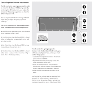

Have you set the spring suspension on the back to the correct position, depending upon if your BS9000 is flat, vertical or horizontal?
