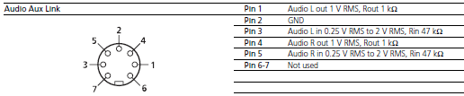

    To be honest we should have solved this a bit quicker and Matador’s first ‘check adapter wiring’ was effectively the solution. I suspect that there is a short between pin 4 (right line out) and 2 (gnd) in the adaptor DIN plug. Mind you, if your aux cable is just a input (to the DIN end) then pins 1 and 4 should not be connected.
    EDIT: Added Aux pin diagram below just to be clear – the image shown is when viewing the pins in the plug:  (and I doubt that your adaptor has pins 6 and 7 as they are not needed)
