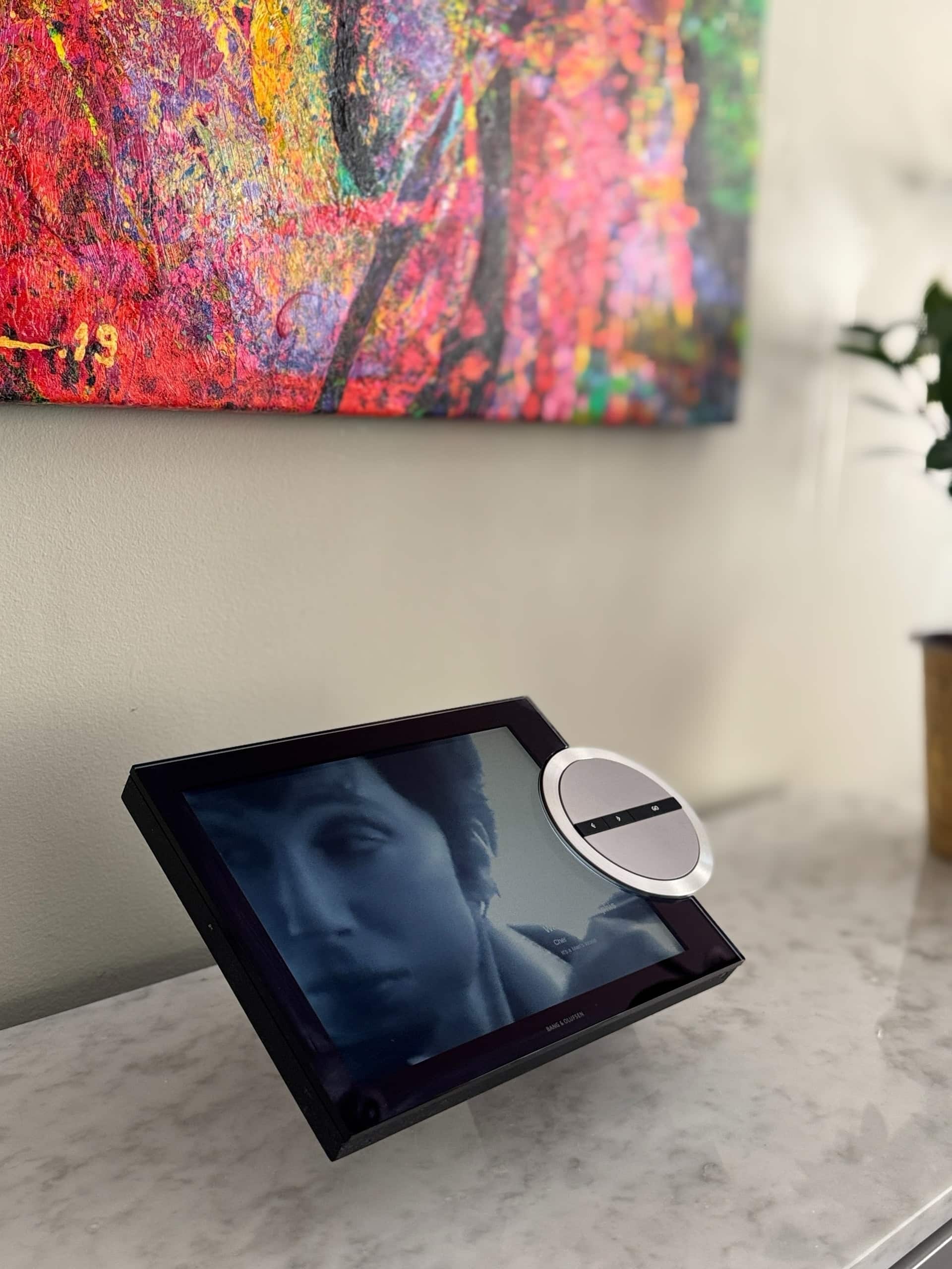

    Thanks for the kind words. Masterlink is supported in the latest version that I published a few weeks ago. It is supported both as a N MUSIC provider to your existing link system, and as an audio master. It is experimental, and I have only tested it in a limited setup with a BeoLab 2000 as I don’t have a masterlink system set up anymore.
    My favorite feature is though that the system now automatically streams music videos based on the song played. Works regardless if you’re playing the song from the built in HDD/SSD, from Spotify, from Tidal or somewhere else. And regardless if you then play the music on PowerLink speakers connected, Sonos or BluOS.
    Your milage may vary, and just ping me in GitHub if you decide to try it out and if you run into any trouble – https://beosound5c.com/
