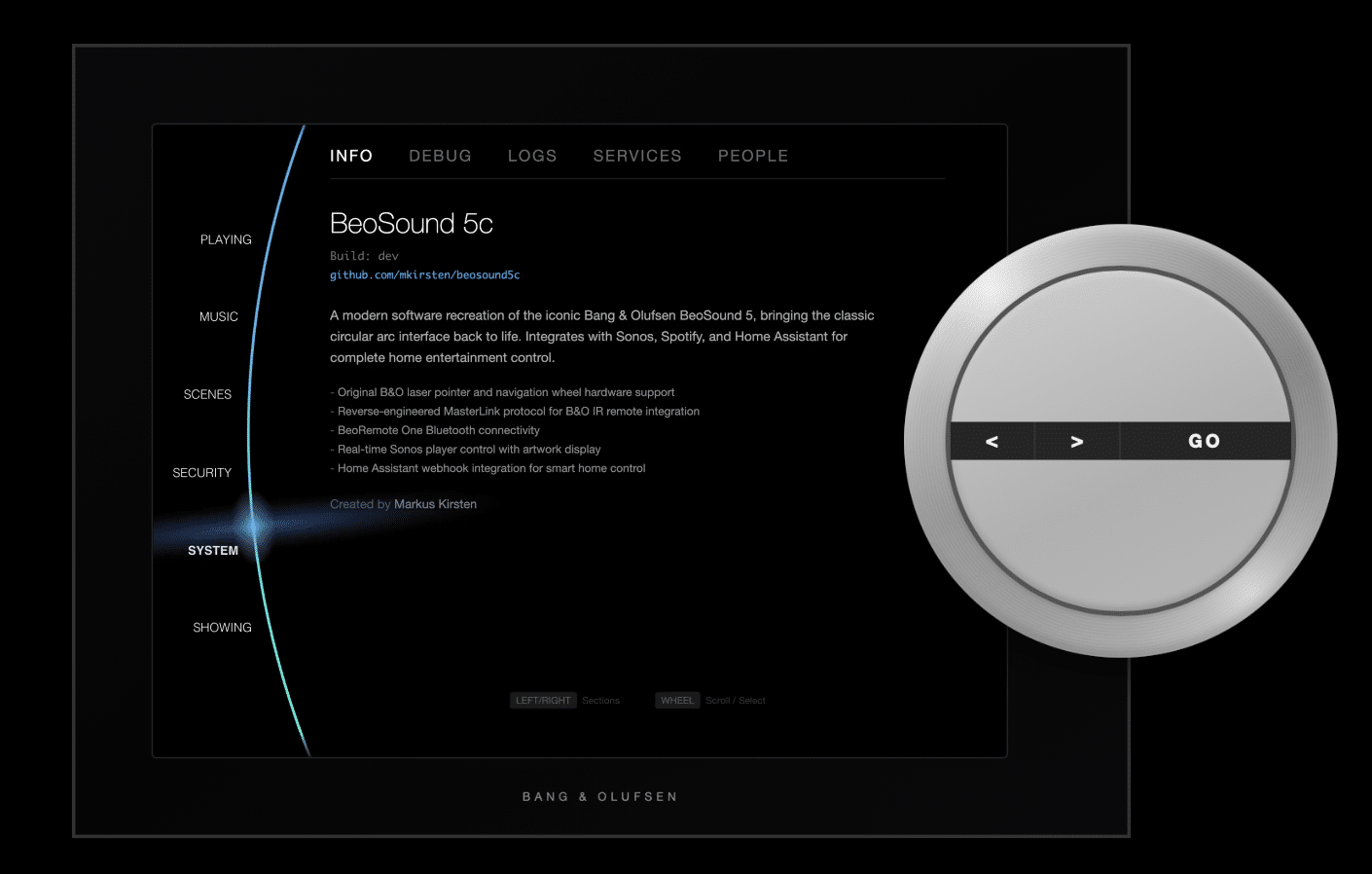

BRONZE MemberI’ve always loved the BeoSound 5 interface, but the software felt increasingly dated — with notably no relevant streaming support and limited integration with newer devices. I wanted to see if I could modernize it while keeping everything that made it special. I ended up replacing some of the BeoMaster 5 internals. The screen, wheel, laser pointer, buttons, and IR receiver all work with the new software. The interesting discovery: the daughterboard in the BeoMaster 5 is basically a modified Beolink PC2.
What it does now:
– Plays music through Spotify and Sonos, with album artwork on the BeoSound 5 screen
– Browse playlists with the original arc navigation and aluminum wheel
– Controls scenes and devices in Home Assistant — lights, cameras, door locks. The device can also run Home Assistant if you’re not already using it
– Shows camera feeds as overlays (e.g., doorbell rings → see who’s there, open the door from the screen)
– All B&O IR remotes work through the original hardware — tested with Beo4, BeoRemote One, Beolink 1000, BeoTime, and others
– BeoRemote One Bluetooth also supported. I really like this one. I now have a BeoRemote Bluetooth controlling my Samsung Frame TVIt’s a passion project, fairly tailored to my own setup with Sonos and Home Assistant, and definitely not plug-and-play. But I’ve documented the build, open-sourced the code, and put together a website with hardware instructions in case anyone wants to try something similar with theirs. Apart from parts you can source from your favourite store, it’s completely free to use.
Website: https://beosound5c.com
Would love to hear from others — there’s probably a lot I’ve missed. Happy to answer any questions or take feature requests here

BRONZE MemberIt can control Sonos, or something else as a player through Home Assistant (or other home control system of your liking). I have set it up so Sonos control goes through HA, but will add an option to control Sonos without HA also. This will both have one less requirement, and on the margin a little bit lower latency.
It does work perfectly with a Beo4 yes, and also with bluetooth remote if you prefer. With regards to Beoport; if your question is if you have all functionality without a BeoMaster 5, as long as you have a Beoport and a power supply for the BeoSound 5, then it is correct yes. You would then have the BeoSound5(c) working without IR, and you would have IR to the Beoport.

BRONZE MemberIt works without a BM5 too if you want actually. There’s three parts that makes sense reusing from the BM5, but it is flexible
- Power supply. Without this you need a stable 12V supply and set up the right cable to the BS5 (so it’s easier to just reuse it from the BM5)
- Daughtercard (that sits on top inside the BM5). Without this IR won’t work. I’m not using MasterLink myself, but that would be possible to make work
- The box. To keep it tidy
General failures on the BS5/BM5 has been, to the best of my knowledge the HDDs and the motherboard. None of which that are reused. So hopefully this can revive a few dead units.

Thank you. The alteration works with all version of the BS/BM5, apart from the Encore. B&O built in the ”master” into the BeoSound 5 Encore, and hence it is significantly more difficult to replace only the ”master”-part of the system.
Funny you should ask 🙂 I do have a version that supports the ripper also, but it isn’t released yet. I’m intending this more to be able to play CDs lossless in a nice way, rather than ripping them in on a drive though.
MasterLink is probably quite possible to make work, only in software, but I haven’t gotten to that yet as I don’t have a need to connect any of my BS5c to ML. However, I may add a section to over the network control NL. I have a BeoSound 9000 that could be cool to control that way, and maybe of interest to somebody else as well.
Yes, it’s quite possible to customize with what you like, e.g., a new section ”Radio” where you can select your streaming channels. Having said so, in it’s current form there is no user friendly configuration do so something like that. Instead, it would require a bit of software development.
Can you describe more about your setup, and how you ideally would want it to work and I can maybe help you further?
