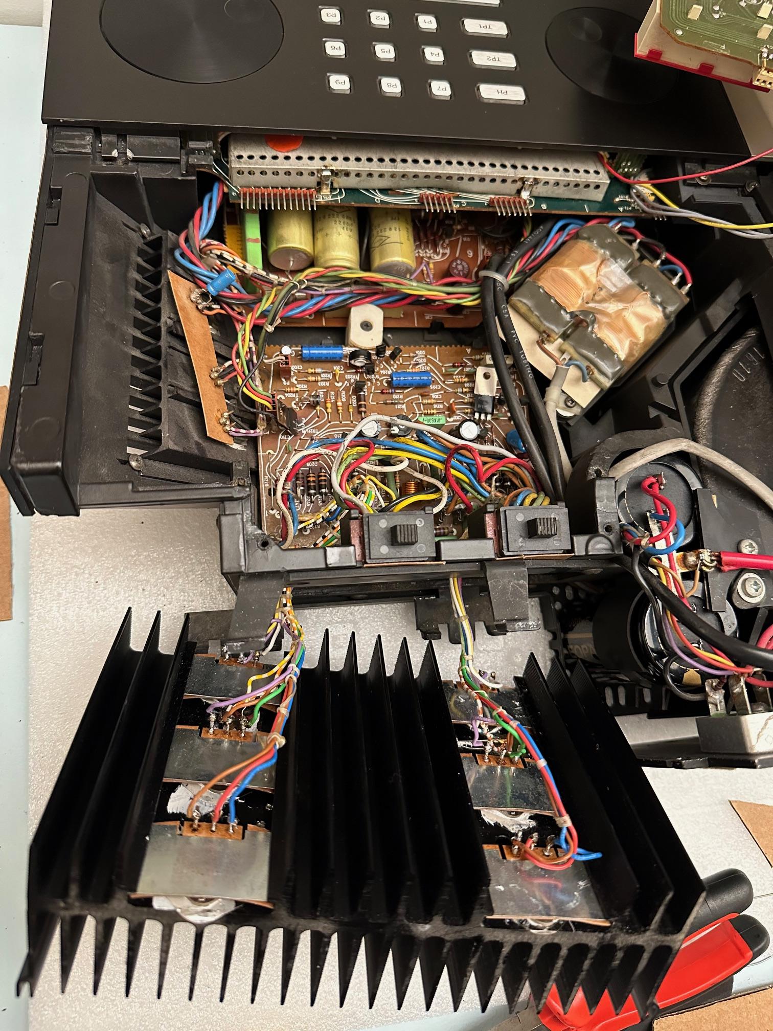

    My Beomaster 8000 is getting very hot [unable to touch] in less than a minute from turning it ON.
    First, I replaced the rear right side cooling fins assembly [with the transistors], with a good working one – didn’t help.
    Second, I replaced the amplifier board with a good working recapped one – didn’t help.
    Left channel is cool.
    Any idea what can be the problem?
    Thanks

    This is the unit with the heat problem I’m working on right now.
    IMG_0372

    Does it play, sounding normally, when you switch it on?
    Is there a trimmer for idle current?
    #54059
    elnevo
    The sound is good from all speakers outputs.
    Don’t know where is the trimmer for idle current.
    #54060
    chartz
    Good thing, the trimmers were already replaced. Follow the service manual to set bias.
    #54061
    elnevo
    Tanks,
    I have set the trimmers using the service manual- problem solved.
