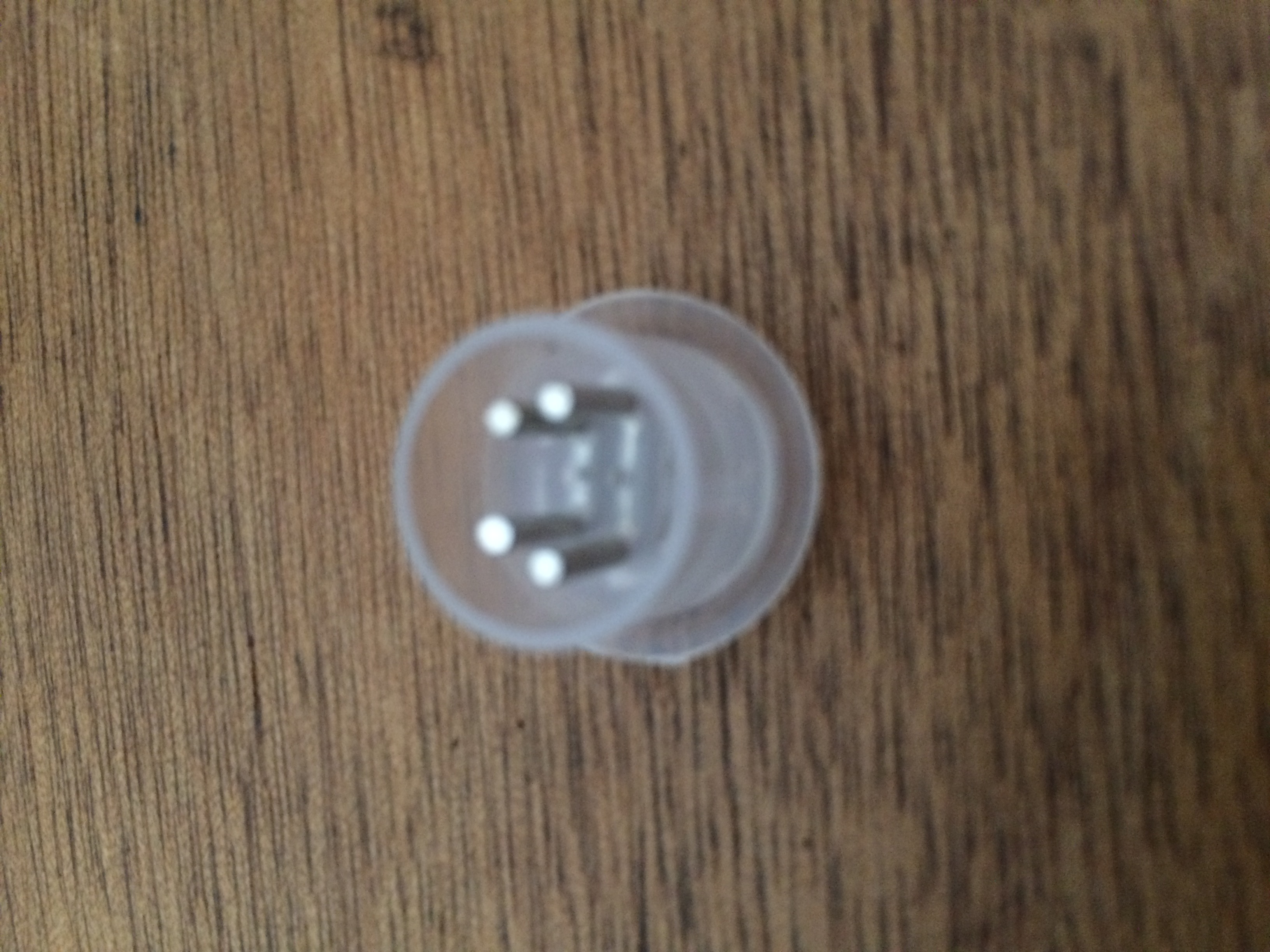

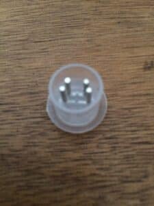

    You can see the connections in the original plug in the photo: (click to enlarge – sorry it’s a bit blurred)
