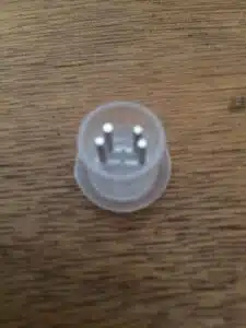

BRONZE MemberWhat exactly are the White Blanks (line in/line out Do Not Remove) hiding and what is this for? As usual Bang & Olufsen manuals are very vague and uninformative. From what I have read so far nobody seems to know exactly what it is for.

ModeratorThe socket enables you to ‘loop out’ to a device such as a graphic equaliser (remember them?) or similar. Same is fitted on BC9500.
With the plug in place it connects DIN pins 1 and 4 (output) to 3 and 5 (input) respectively, as you may be able to see in my blurry photo attached:
