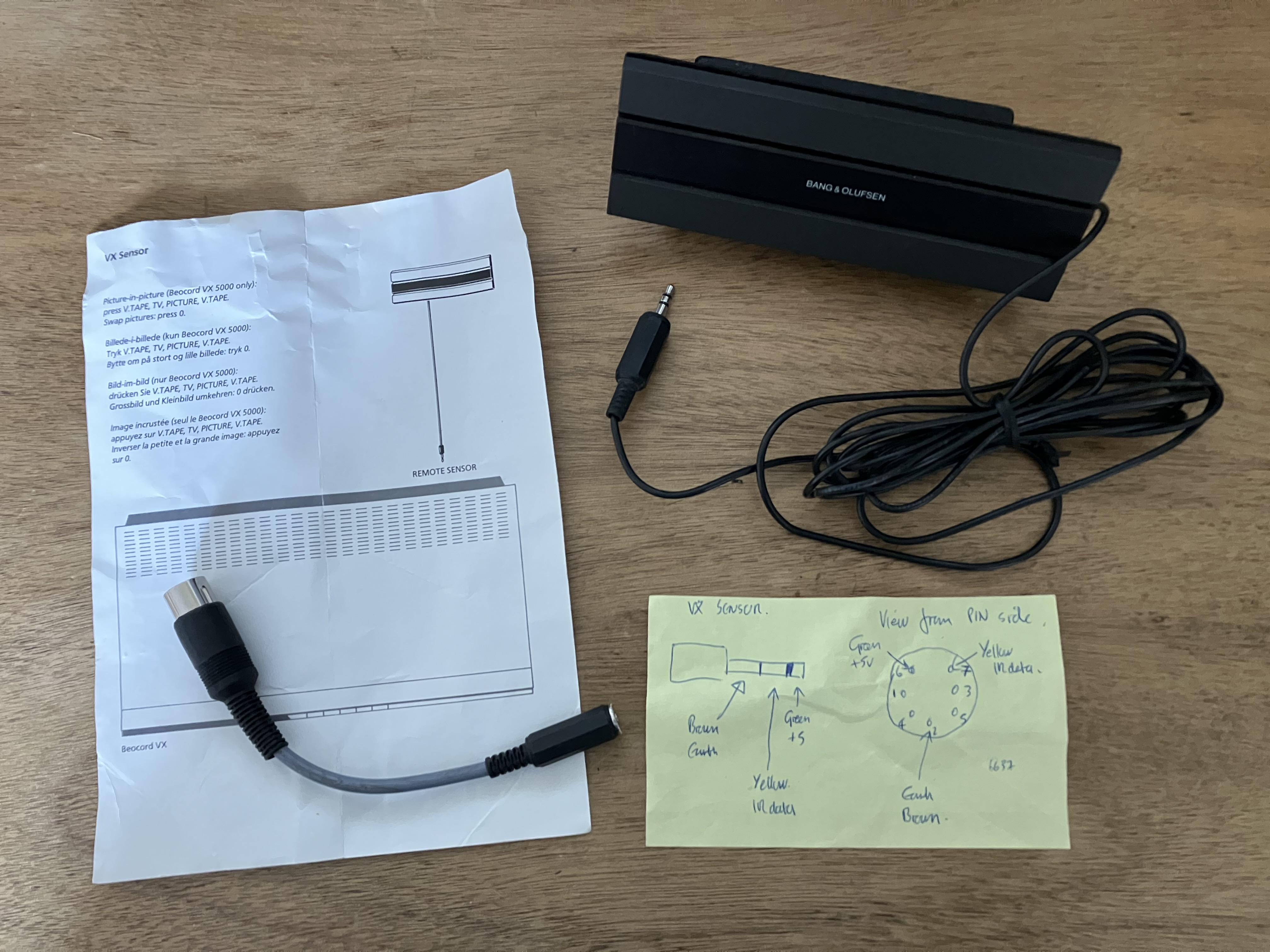

I use the box with a MacBook Pro 2017 and it works, but I can’t remote control it using a Beolink 1000.
I’m trying to use the same configuration you used with the vx sensor, and I wonder how you wired the sensor with the 3,5 jack.
thanks in advance
Michele
Location: Roma
18 January 2024 at 11:24 #36244 GuyModeratorI’m trying to use the same configuration you used with the vx sensor, and I wonder how you wired the sensor with the 3,5 jack.
Here’s the wiring that I used – click the photo to enlarge so that you can read the yellow note. I didn’t actually modify the VX sensor- it just plugged into the 3.5mm socket and worked. The same connections (with different wire colours) are used within the BeoSystem 3 sensor also. The adaptor that I made was to use the VX sensor with a Passive/Active.
