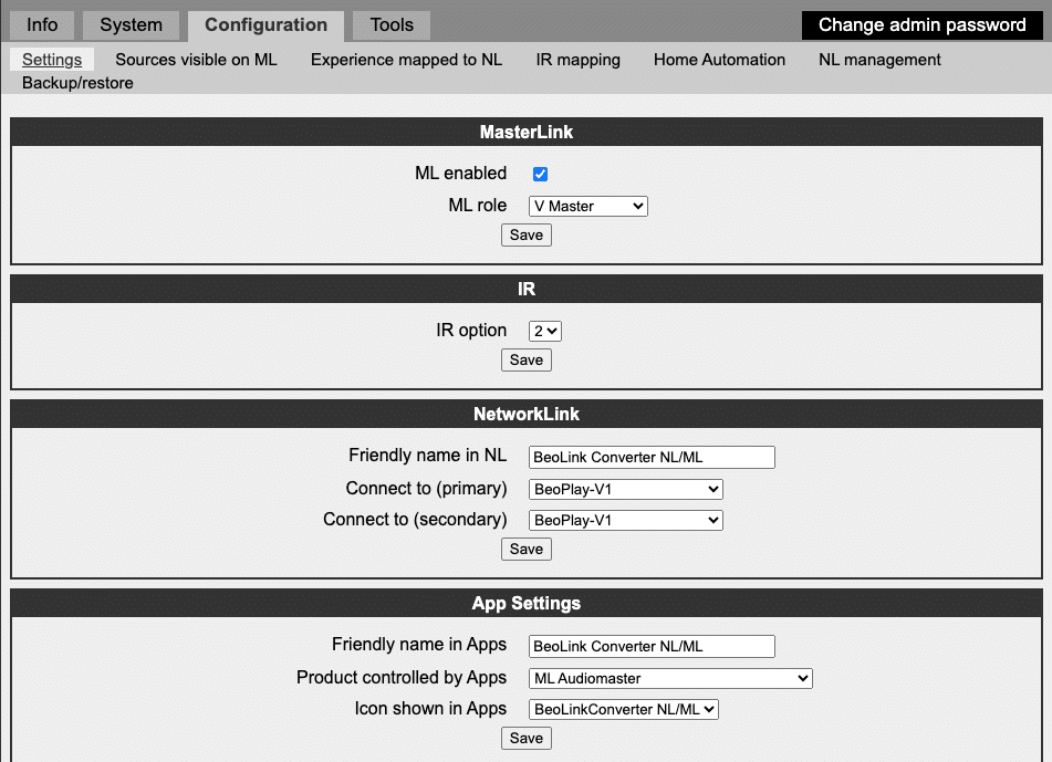

    I have just tried now with Besound Ouverture (A.opt. 0) – NL/ML converter – Beoplay V1 (V.opt. 2)
    The setup of the NL/ML converter is as follows:
    Pressing CD on the BS Ouverture starts the Beoplay V1 and the music is playing through it’s speakers. So it works, at least with the Ouverture.
    I have quick start timers activated on the Beoplay V1, not sure if that makes any difference, but just for the full picture.
    I might be able to do some more testing later in the week with other music system, and also with a Beoplay M3 as the NL source to see if that works just as well.

    I have now tried the same test with my Beocenter 2. At first it did not work. I could start it from the Beoplay V1 and control it, but if I used the buttons on the BC2 it could not start the TV. Later I found out that was because I had speakers connected to the BC2. When I disconnected them I could start the Beoplay V1 TV by pressing the DISC button on the BC2.
    In my previously testing with the BS Ouverture there was speakers connected to that, but that did not seem to matter for this functionality, so there might be some differences in how different systems do this feature.
    I also checked settings on the TV again, and I am not sure if this is something I have set manually, or if it wast automatically set based on the settings in the NL/ML converter, so here goes (disclamer my menu language is Danish, so translation might be different with english menus):
    In the menu Product integration ->Connect to other products
    Product 1: Beolink Converter NL/ML
    Speakers to: Beolink Converter NL/ML
    If this has to be set manually it might make a difference in behaviour

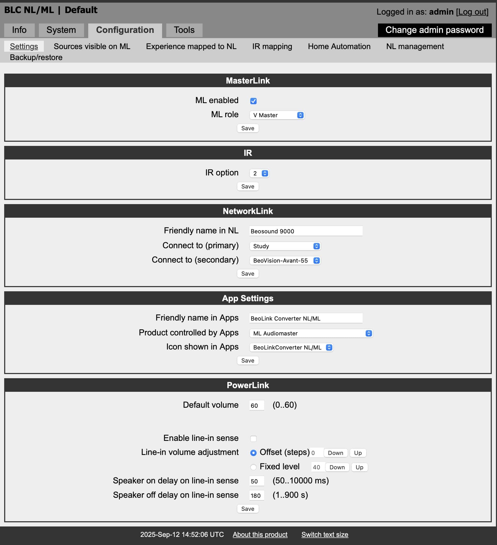

    I got it working!  I turned Timers on with the Beovision 11, and switched to BLC ML Role to V Master (was A Master before). Selecting a CD on the 9000 (A.Opt 0) turns on the Beovision (V.Opt 2) and the CD plays. Thanks for the guidance.
