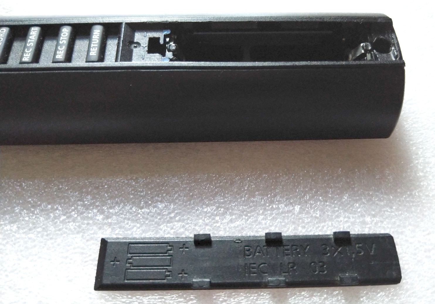

    Will seem a silly question, but which way do the batteries go into a Beolink 5000!?  I have got hold of one which is in great cosmetic condition, but not working. The screen has come loose, and the battery cover is missing.  I want to test it to see if there is any function at all but the phone-camera-test is not showing any blink from the IR blaster.
    I’m assuming I have the batteries in the right way (two facing down, then the middle one facing up) but is that right?  I assume the diagram to show how the batteries should be inserted is on the missing battery cover!

    The diagram is on the cover, but there should also be – + – on the remote’s frame (perhaps it is not on all versions):
    The battery holder of the BL5000 is very brittle and if even slightly damaged will not make good contact. I am hoping that Danish sounds parts would someday produce a remake (like they have done for almost all BL1000 parts).

    Thank you – I did have them in the right way after all then.  It’s not working, so I’ll have to have a more detailed look at it.

    Two facing down, middle facing up is correct.  The battery cover slides on downwards, and is removed upwards – some people get this wrong.
    I just checked my ‘remote spares’ box and have a spare BL5000 battery cover – top left tab (lausvi’s photo) only has broken off but it should still work.  PM me your address and I’ll stick it in the post.
