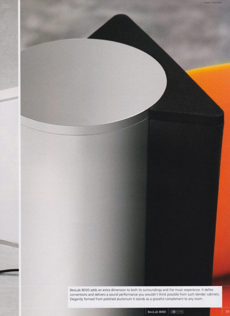

    In regards to the Beolab 8000 and its grille: How is the structure of this piece made, the part under the fabric? It is one piece of metal with the sides bent inward at an angle, or something else?
    I’m asking as I’ve seen a few on ebay and elsewhere where the top panel, the part that fits flush to the circular top plate, doesn’t fit tight with the angled sides (the surfaces that runs vertically). In most of these cases the angled sides look bent further inwards, other times they are sticking out. When these units were new were the sides and the top part flush together (seems like it)?

    Hello McRib,
    The frames are made of plastic. See also this thread (where I posted some pictures of me putting new cloth on). https://forum.beoworld.org/forums/topic/changing-cloth-on-beolab-8000-instructions/
    I would say that it will not be easy to make the flanges and the top part align perfectly as on some (stock) images, especially when redone.
    BO_2004-5_UK_Catalogue_-59-745x1024
    The original cloth was welded to the frames. Mine are not 100% flush. The flanges stick out a bit. I think it is because of the added thickness of cloth and tape. Still they are now much better than before!

    you only need to unclip the frame on the sides to be able to remove it by sliding it upwards. I think I’ve seen the same YouTube video and mentioning that you have to flip up the top part of the frame to be able to remove it is completely wrong. It will only result in unnecessarily breaking the clips holding it in place.
    The clips on the sides are a bit hard to disengage, but it can be done by carefully, but firmly pressing the front towards the speaker with one hand while pulling the angled section away from the backside with the other hand. Start from the top and bottom and move towards the centre of the speaker. You will hear a distinct click once the clips disengage.
    Once you’ve slid the frame back on, you have to press the front the same way as before and “massage” the angled section around the edge to allow the clips to engage by pushing directly where the clips are with your thumb. This can also be a bit tricky, which is probably why they are often seen sticking out, as many don’t know how to get them to sit correctly again.
