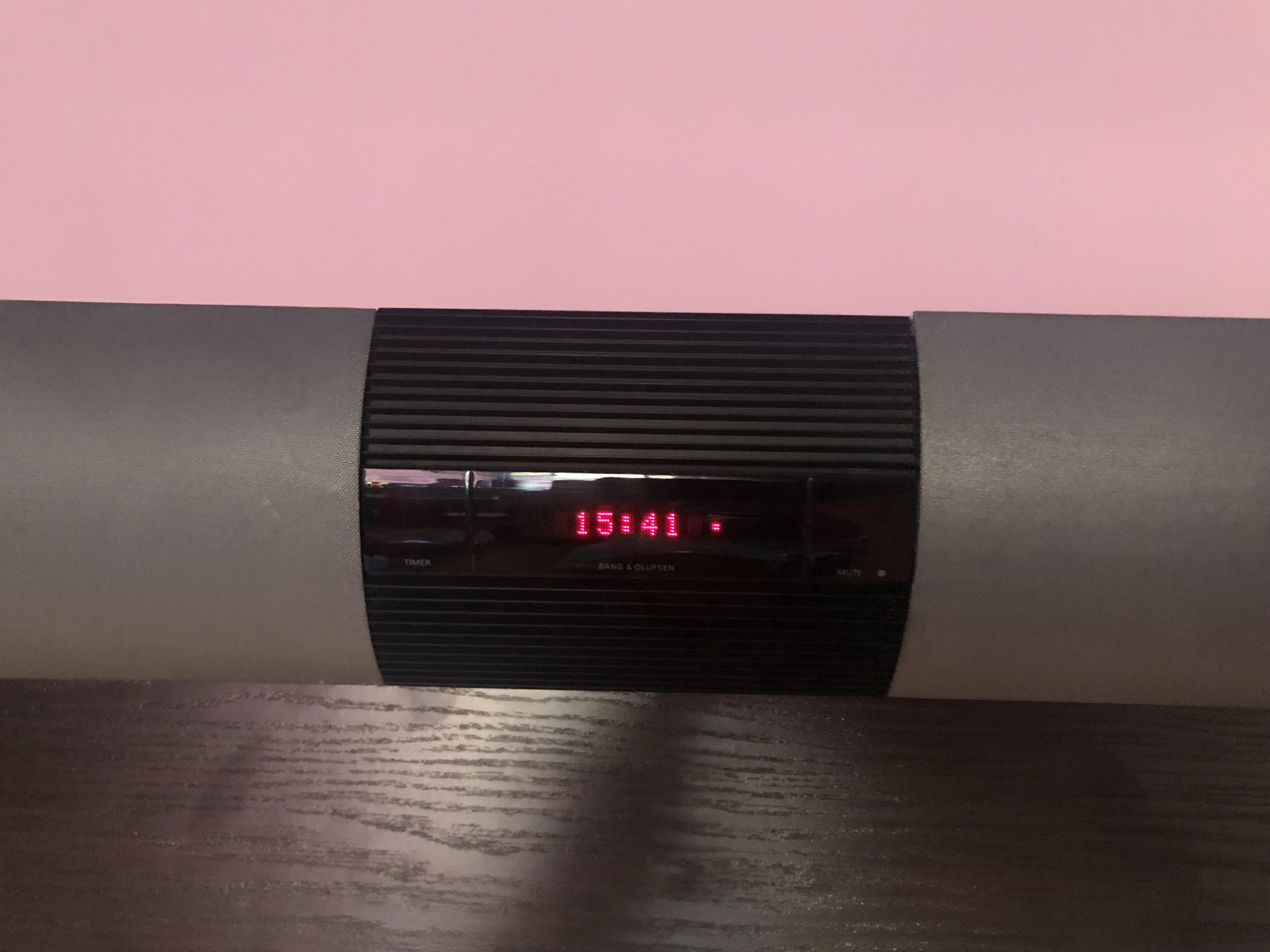

    Hi, I have two BeoLabs 3500 connected to MasterLink bus with BeoSound 2500 as master device – connected via 1611 BeoLink Converter (older type). BeoLab 3500 displays time, but how do I setup this time? My BeoSound doesn’t have any clock setting AFAIK, how the BeoLab gets time??My other BL3500 is not connected to the same bus (only to iPad via another BeoLink Converter 1611) and does not display any time, only “:”. So the time must be set via DataLink from master device. Beosound Ouverture has clock setup, BeoSound 2500 doesn’t. Maybe internal clock is set to 00:00 after powering on?
    Best regards
    Adam

    Secondly I am 99% sure that you will need a clock-enabled ML (or MCL) audiomaster in order to show the time on BL3500 – a videomaster may also work but I am not sure.

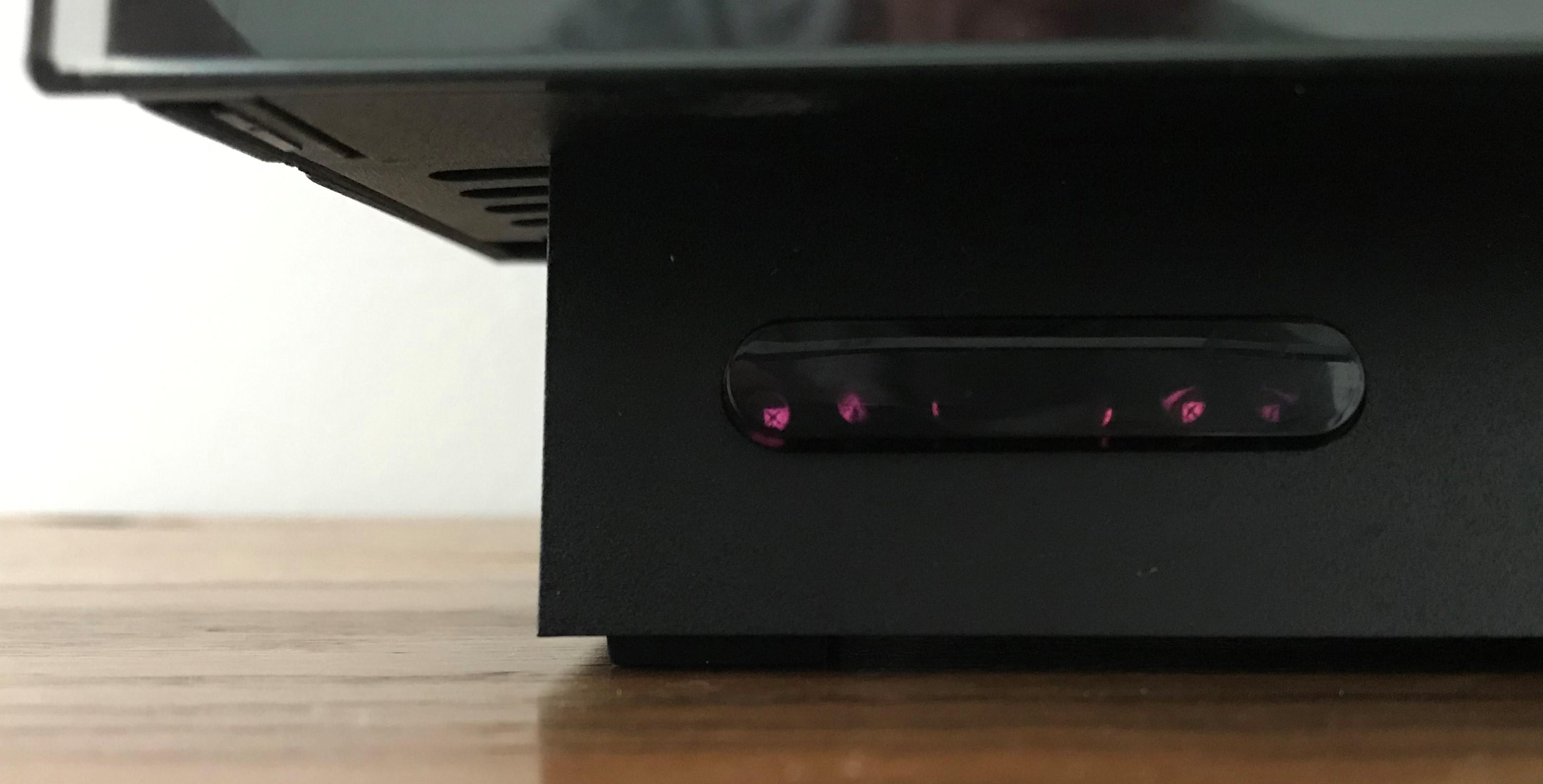

    EDIT:  I think early BS2500 (with the two-way IR) had the clock function, but to set and operate it you needed to use a two-way remote such as the BL7000 or BL5000.  The two-way BS2500 could be recognised by its IR window being bottom left of the unit below the moving glass doors, as shown below:
